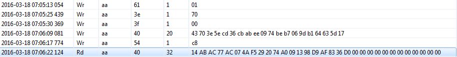

    I was testing the authentication with demo board BQ34Z100EVM.  The below is what I observed when I test the authentication command
    On power ON if I read 20 bytes from the address 0x40, the response is 00 00 00 00 00 00 00 00 00 00 00 00 00 00 00 00 00 00 00 00
    Then I write 20 byte of data “43703e5ecd36cbabee0974beb7069db164635d17” to the location 0x40. And if I read the data immediately I receive “43 70 3E 5E CD 36 CB AB EE 09 74 BE B7 06 9D B1 64 63 5D 17
    But as per datasheet the command sequence should be “If in SEALED mode, 0x00 must be written to DataFlashBlock().Next, the host writes a 20-byte authentication challenge to the AuthenticateData() address locations (0x40 through 0x53). After a valid checksum for the challenge is written to AuthenticateChecksum(),
    Though I don’t send all the necessary commands I will receive the 20 byte correct digest. Can you please tell me if I am doing something wrong.
    Please find the attached log
    BQ Authentication.log

  • I tested your Challenge in sealed and unsealed modes. Here are the commands and results.
    When Unsealed.
    When Sealed.
  • Hi Thomas,
    Thanks for the reply. I could get the same log,
    Here my question is, how should I use the digest reply to validate the authentication.
    Now the reply "14 AB AC 77 ..." is not matching with either key or the 20 byte challenge.  Please clarify if I need to de-crypt the response.
    -Umasankar K
  • The device calculates the digest based on the key that is stored on the device and the challenge that is sent from the host. The host then compares the digest to the digest that it expects to receive. If they are the same, then the key must have been correct and the host accepts the battery pack. If they are different, then the host rejects the battery pack.
