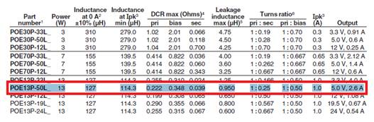

2. Transformer's spec is N=1/0.25=4

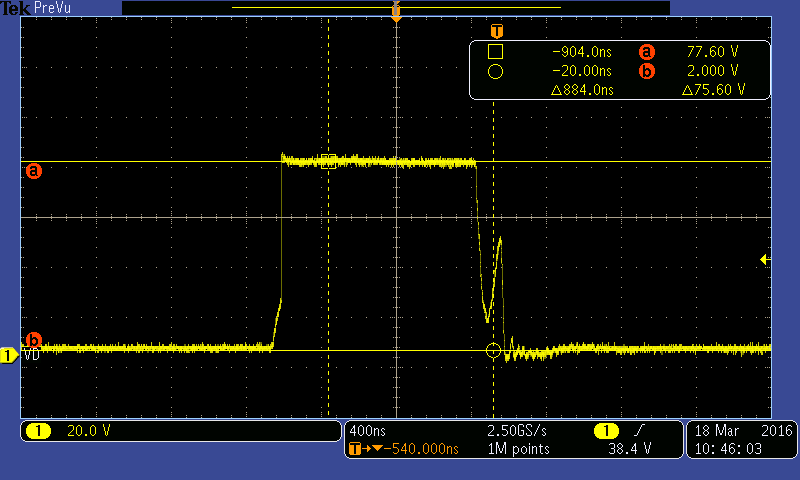

  • Hi Jacky,
    For this design with the TPS23757 in this topology, I have seen the DFLU1200 diode used. It has a higher RMS voltage rating and fast reverse recovery time. Is it possible to replace the diode to one similar to this?
  • Hola Darwin,
    Thank you for your reply and I summarize waveform as below:
    1. Circuit transient analysis:
    D15_VD = High = 76 ~ 77V、LOW = 0 ~ 2V
    Is this correct?Can help confirm?
    2. The diode works at reverse voltage when MOSFET is turned on and its VBR = 56V + 20V = 76V and the diode's VRM is 100V > 76V.
    3. When MOSFET turned off, transformer (3-4) = -20V、VDS = 56V + NVo = 56 + 4*5 = 76V、VD = 0.85V
    4. To confirm the MOSFET's VDS whether is normal?(when MOSFET is truned off):
    5. To confirm R285 & C293 whether is shorted to causes D15 burned down:
    Yes, confirmed R285 impedance is normal.

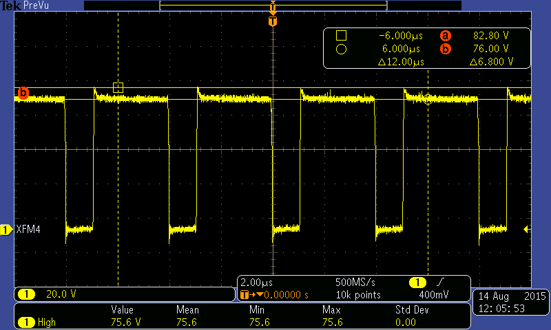

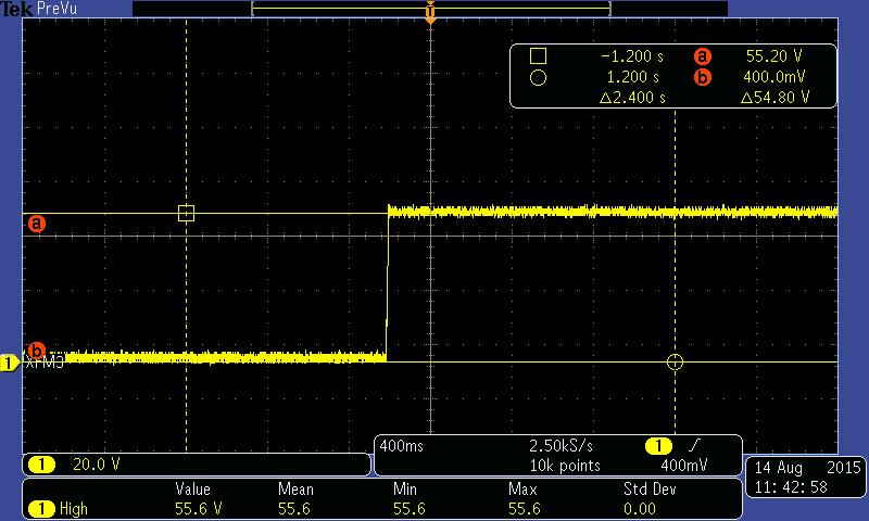

    D15_VD:
    Transformer_(3-4):
    XFM3:
    XFM4:
