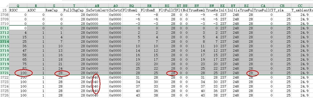

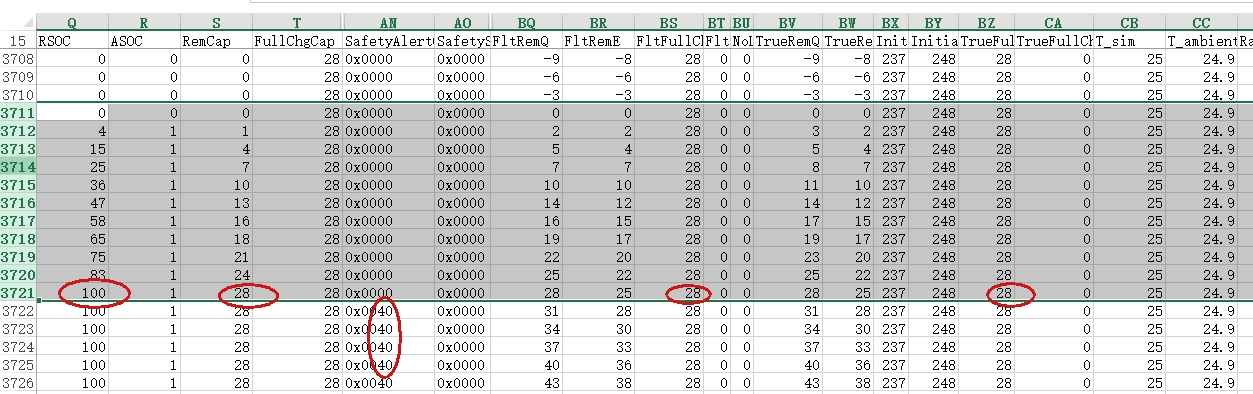

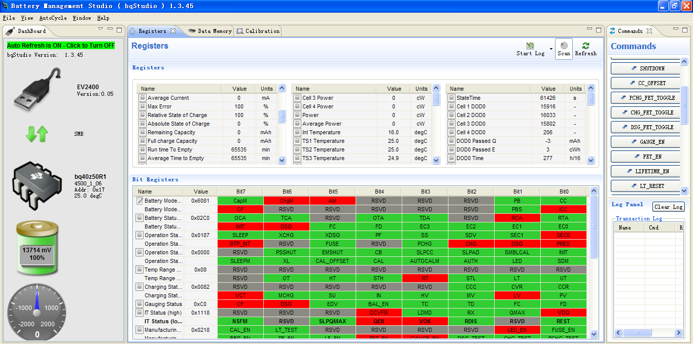

  • Hi Justin
    Thanks for your support. Now I have determined my ChemID - 412. But OC flag still be set always, then CHG FET will be open and I can not charge cells to full.
    The picture below is a screenshot for main registers. FCC only be 20mAh ,RC has negative value.
    Do you know why it is?How could I do to make it normal?
