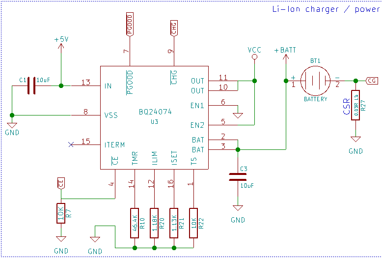

Hi, I'm using BQ24074 in USB500 mode powering a Bluetooth module. When the MCU goes to sleep it draws about 1uA (verified) but the BQ24074 IC seems to be drawing around 200uA. I'm probably not reading the datasheet correctly, but the quiescent current under load is not clear.
Is is expected and if so, are there any potential solutions we can look at for a battery powered product that needs very low power use in deep sleep ?
