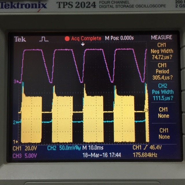

I designed a 12V/25W PD. The schematic is almost TPS23754-383 EVM. I used a adapter as input and APD was raised to disable the hotswap. I found the active clamp forward tps23754 startup repeatedly if the load was lower than 0.3A. I've replaced the synchronous FETs with two schottky diodes.
sch _ 06_POE.pdf

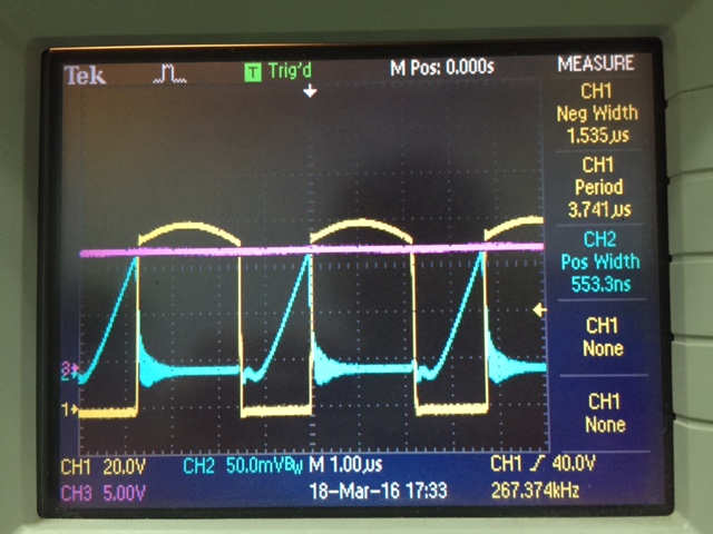

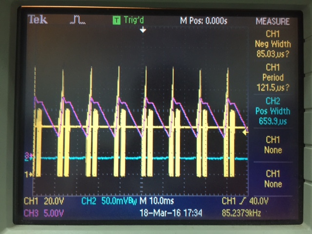

Below are the waveforms on SW (CH1), Vout(CH3) and CS(CH2). Could give suggestion on this issue? Thanks.
Load=0.1A : Vout repeatedly restarts.
Load=0.2A :  Vout repeatedly restarts.
Load=0.3A, no restart.
    There is a LED on T2P pin. I found when load>0.3A, T2P was active low, at this moment, the operation was fine. When load<0.3, T2P was not active, the restart issue appeared.
  • Hi Di,
    It looks like the converter is in hiccup mode. This usually occurs when there is a fault. Can you double check that there is no shorts; or that the components and connections are correct on your board? Thanks!
    Darwin
  • Hi Darwin
    It is not hiccup. The operation is fine with larger than 0.3A load, even up to 2A. The restart only happens with less than 0.3A load.
    I found T2P is active low only with larger than 0.3A load.
  • Hi Di,
    The adapter voltage is 48V correct? Or are you operating lower?
    After looking at the schematic. It looks like you have a very large clamp capacitor (2.2uF). Any particular reason that is? Typically it will be 47nF (250V) cap. This may be making the converter unstable.
    I also notice the opto feedback has a difference CTR than the EVM. This might also make it unstable. For TLP291 you should probably use the Y+ version.
    These may help narrow down the issue.
