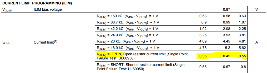

I'm looking at a design for the TPS25940 where the ILIM resistor can be changed, thereby changing the ILIM setting of the TPS25940.  The ILIM resistor value will be switch using a FET in series with the resistor, all FETs tied to the ILIM pin.
Is this an acceptable way to change the ILIM as required for a specific application?  Any downside to this method?
