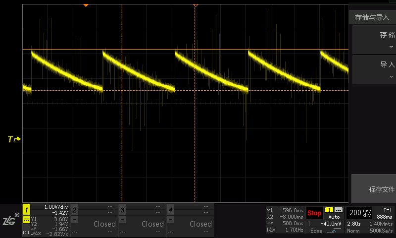

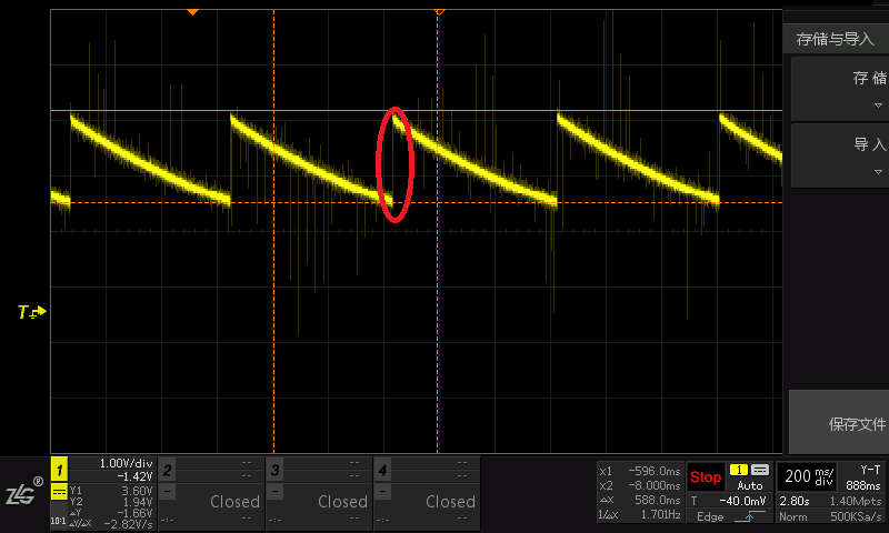

  • @Roger Hwang ,   I have the same issue like that: The cell voltage would change very large sometimes.
    The registers setting  list  as flow:

    The caps  on OUT value 100nF; and the scope is
    Could you give me some suggest?
    Thanks!
    Thanks!
    Thanks!
  • HI PinKen,
    We recommend 390pF on OUT filter Cap.
    The recommended sample configuration settings are (these are also the factory default):
    You can also find them in the datasheet table 3.
    -        390pF OUT filter cap
    -        AFE_PCTRL = 1 (causes 100us for ADC power up)
    -        Cell ADC sample period (ADC_PERIOD_VOL) = 60us
    -        Cell ADC sample period for oversamples (CMD_OVS_GPER) = 12.6us
    -        Staying on a cell channel to oversample (CMD_OVS_CYCLE)
    -        AUX ADC sample period = 12.6us (ADC_PERIOD_AUXx)
    -        8x oversampling of CELL and AUX channels (CMD_OVSMP)
    -        All of these parameters would be applied to any channels being sampled, including AUX, etc.
    These are factory default value and GAIN and OFFSET are all calibrate with these settings.
    Can you change CAP to 390pF and follow our register settings?
    Is there concern for not following our recommendation?
    Please follow our recommendations and let us know if you still have any problems.
  • As Roger mentioned,
    You appear to be using the following settings which deviate from our recommendations:
    -          CMD_OVS_CYCLE = 1 (cycle through all channels one at a time)
    -          Cell ADC sample period (ADC_PERIOD_VOL) = 500us
    -          AUX ADC sample period for oversamples (CMD_OVS_GPER) = 5.96us
    These settings together with a 100nF OUT cap have not been tested. I suspect OUT cap value is far too large. We can only support the ADC configuration in the recommendations above used with a 390pF OUT cap. Any changes from those settings will need to be characterized by the customer to determine if it is a good combination.
    I suggest monitoring the OUT pin with a differential probe to determine there is enough time for the AFE MUX output voltage to settle before the ADC samples. If the MUX output has not settled in time, then the cap value will need to be decreased. Your oscilloscope capture of the OUT signal needs to be zoomed in much more in the area shown below:

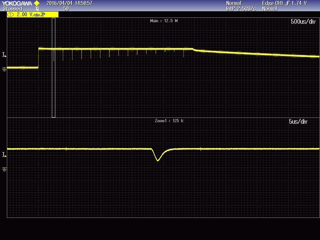

  • The OUT signal (when zoomed in) should look like this:
    The zoomed in view of the OUT signal in the bottom half of the capture shows the MUX output changing from cell 16 to cell 15. The dip is the MUX output settling. It must be given sufficient time to settle before sampling occurs (right before the MUX output changes to the next channel). With too big of a cap value, the MUX output may still be changing when the sampling occurs.
