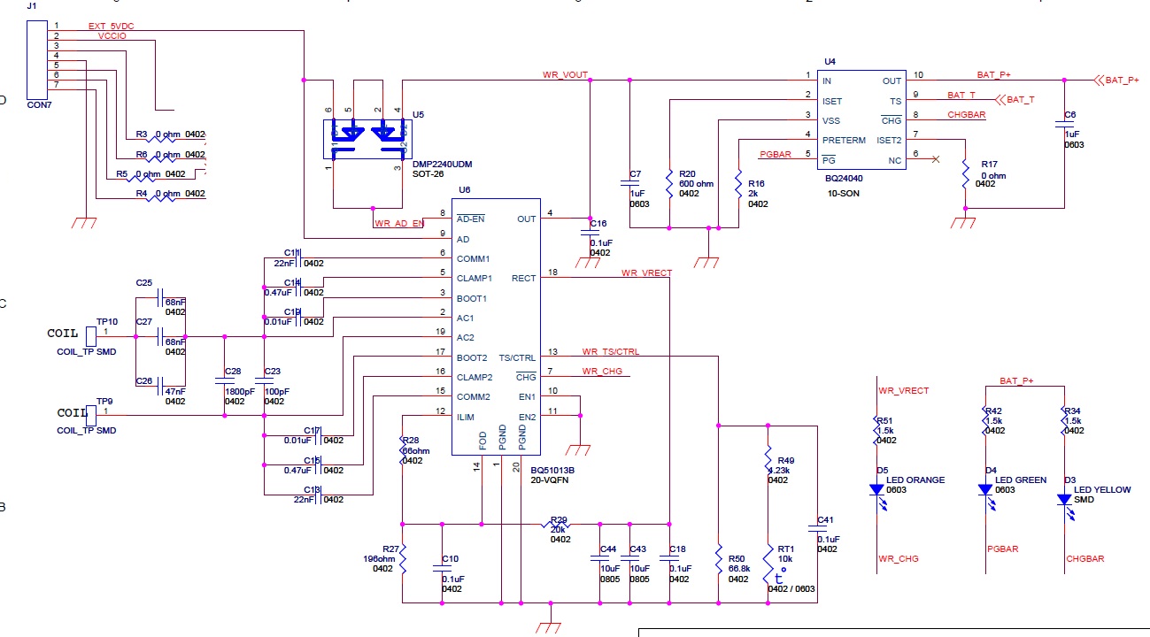

I am using BQ51013B in one of my designs for charging a lithium ion battery. The circuit is as shown.
The circuit works in wired charging mode. When I give a 5V dc at the connector J1 it works and battery is getting charged.
But the wireless charging is not working. There is no output voltage in the wireless charging mode. The design uses receiver coil IWAS4832FFEB9R7J50
(I have used a Qi compliant wireless charging pad bought from amazon)
Please help.
