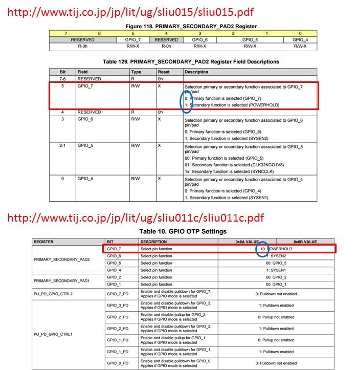

TPS659037 / PRIMARY_SECONDARY_PAD2
I compared Register Map to datasheet, then found different description at GPIO_7 bit of PRIMARY_SECONDARY_PAD2. GPIO_7 is using 2 bit in datasheet but it's only 1 bit in Register Map. Please confirm the correct information.
Sonoki / Japan Disty
  • Sonoki-san,
    GPIO_7 originally had two bits, PRIMARY_SECONDARY_PAD2[5:4]. However, bit 4 has no function, so it was marked reserved.
    The user's guide shows that bits 5:4 are set to "10". This means bit 5 is set to 1 and the function is POWERHOLD.
