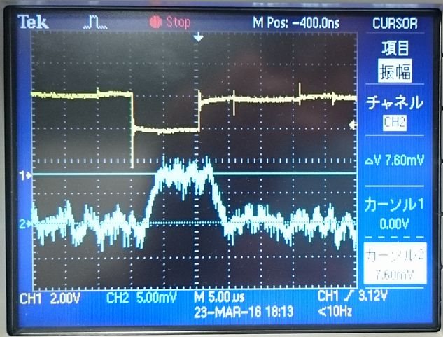

TLC59281's output current is 2μs late for BLANK signal.
※Waveform is attached below.
  CH1:BLANK signal, CH2:Output current
Is this normal condition?
Or, is TLC59281 need to careful with delay time?
【Additional information】
・Distance of device to load is 400mm
・8ch parallel connection
・Total current is 72mA
