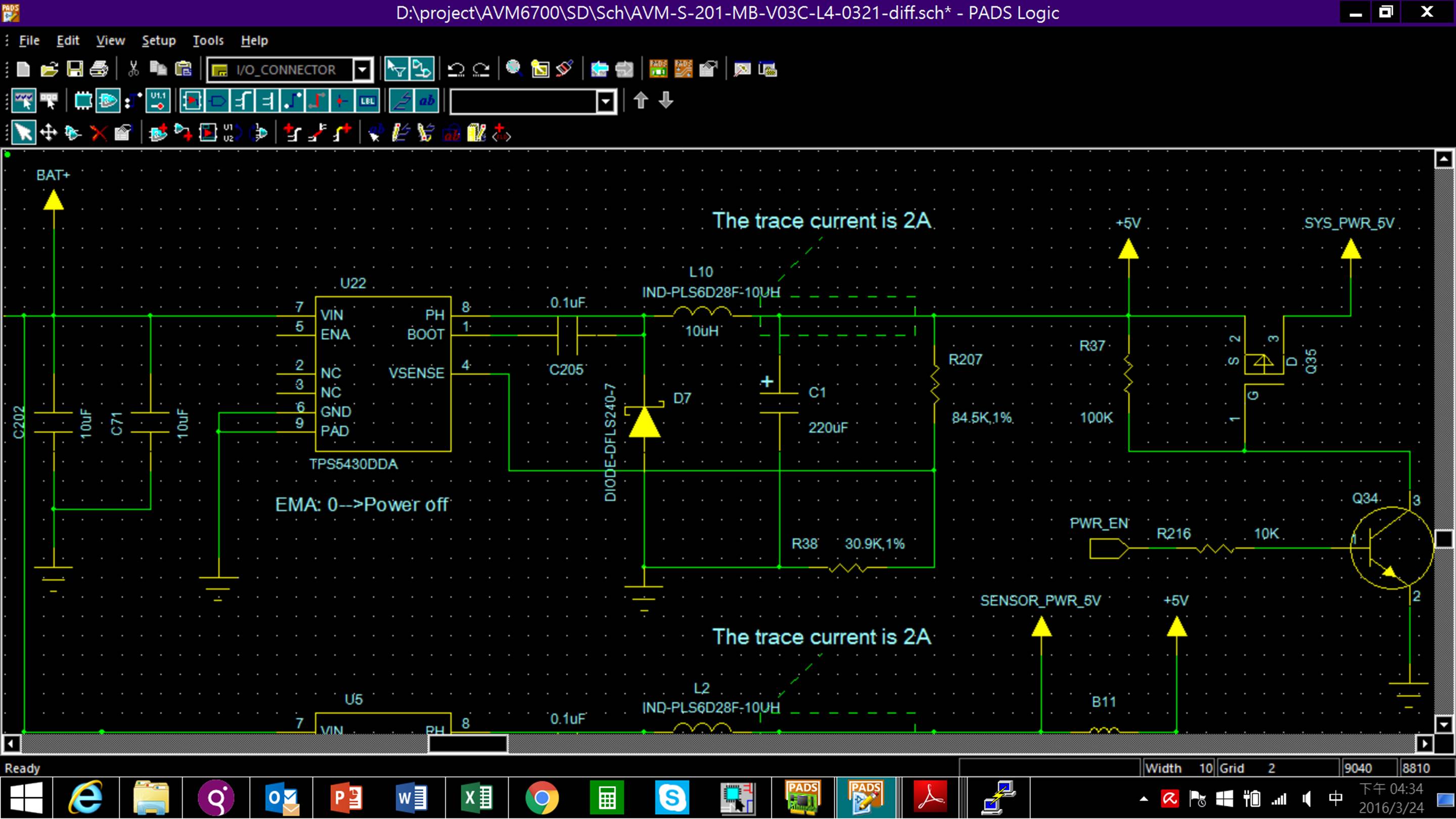

I'm using TPS5430 for following input and output parameters:
Vin = 12V
Vout = 4.6V/1.5A(peak)

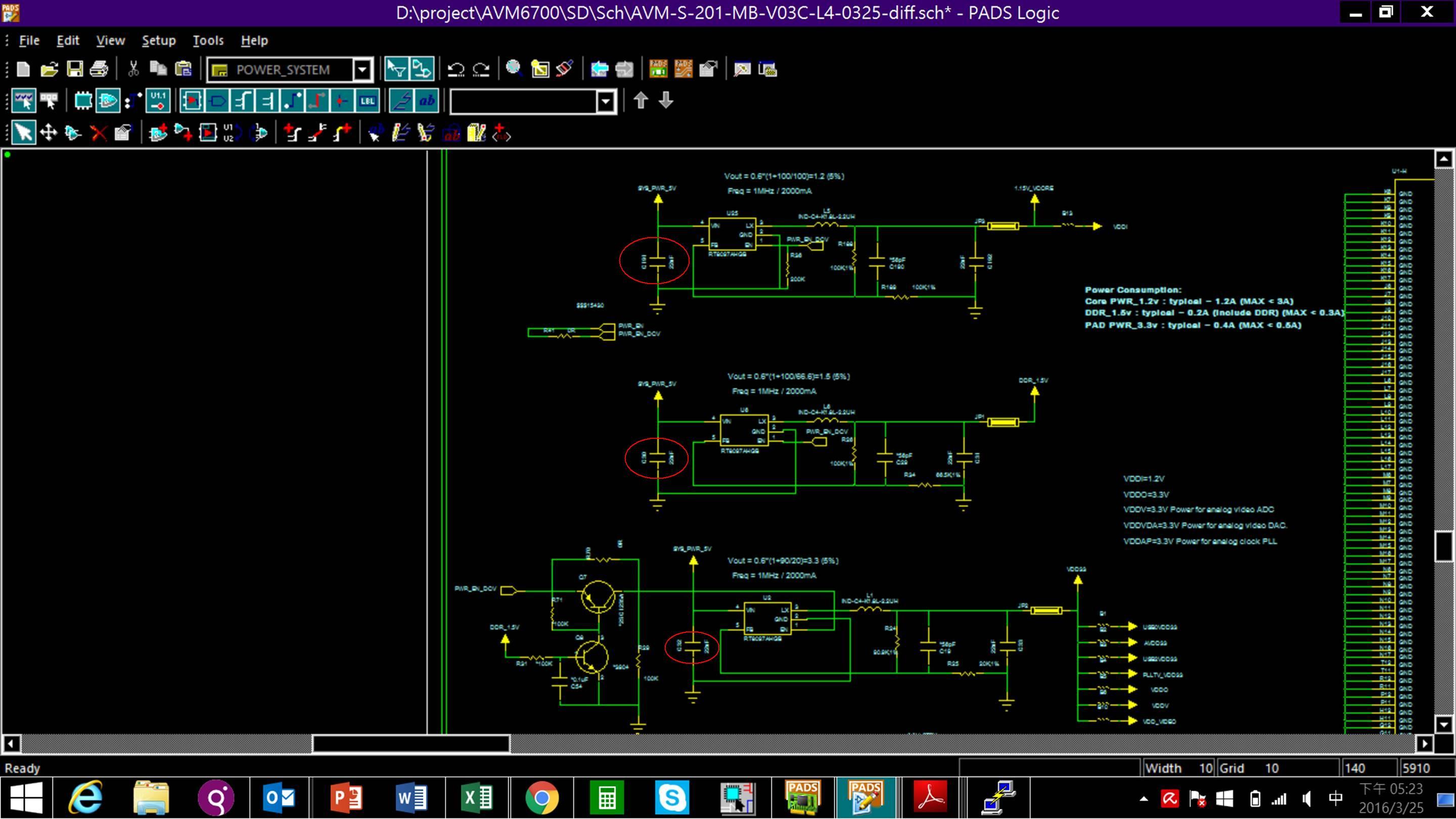

And the schematic were shown as below:
TPS5430 schematic:

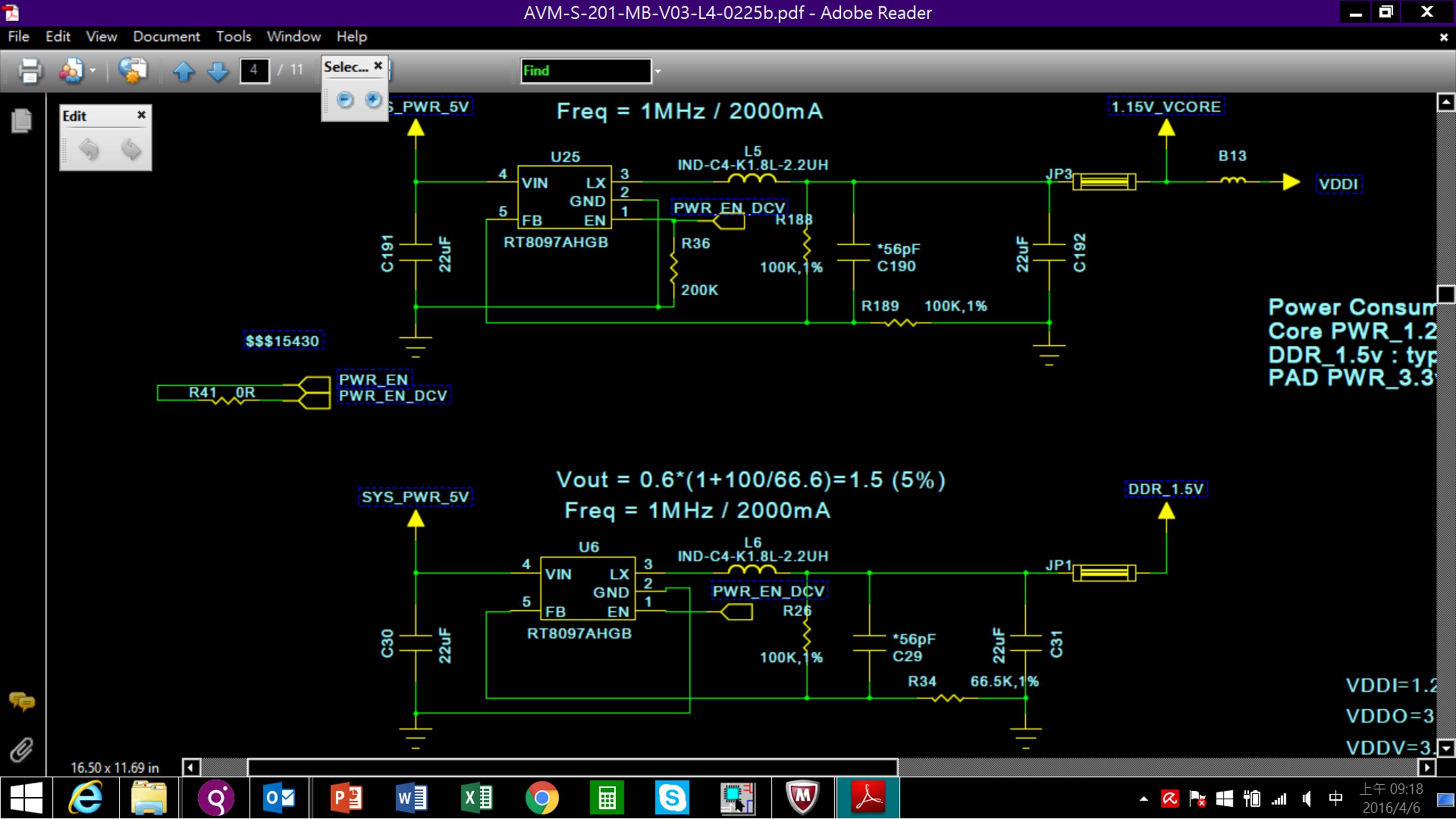

Three buck regulator schematic:

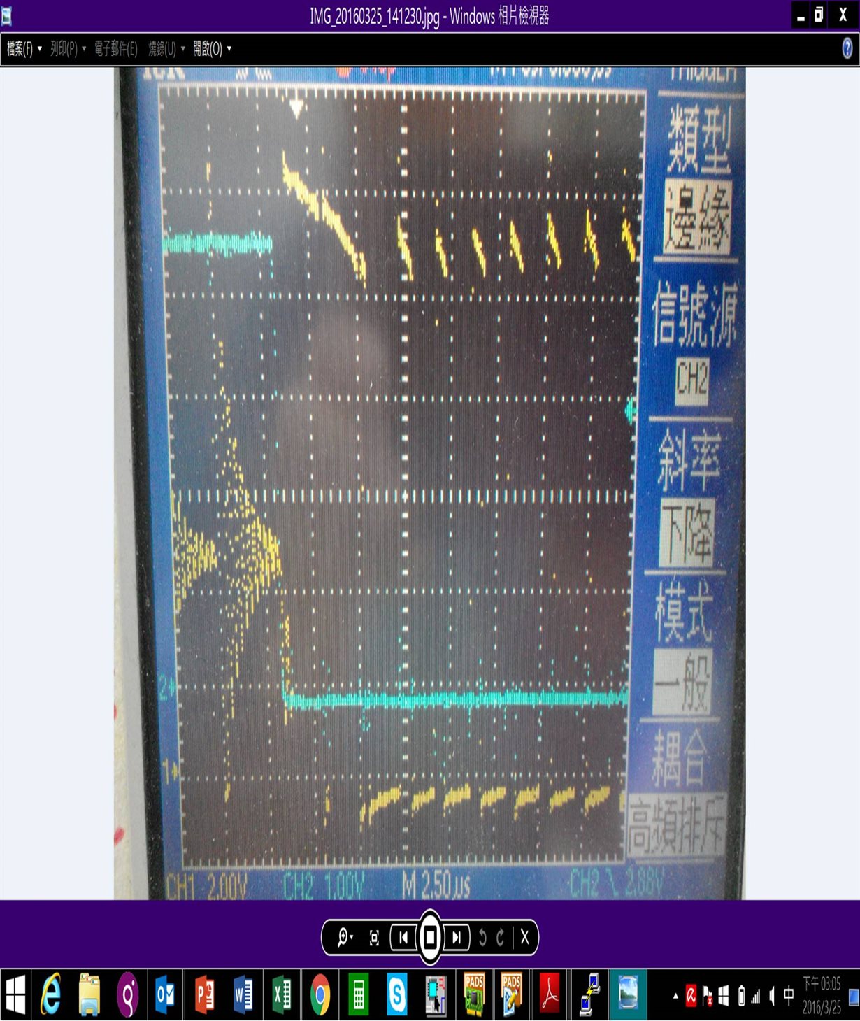

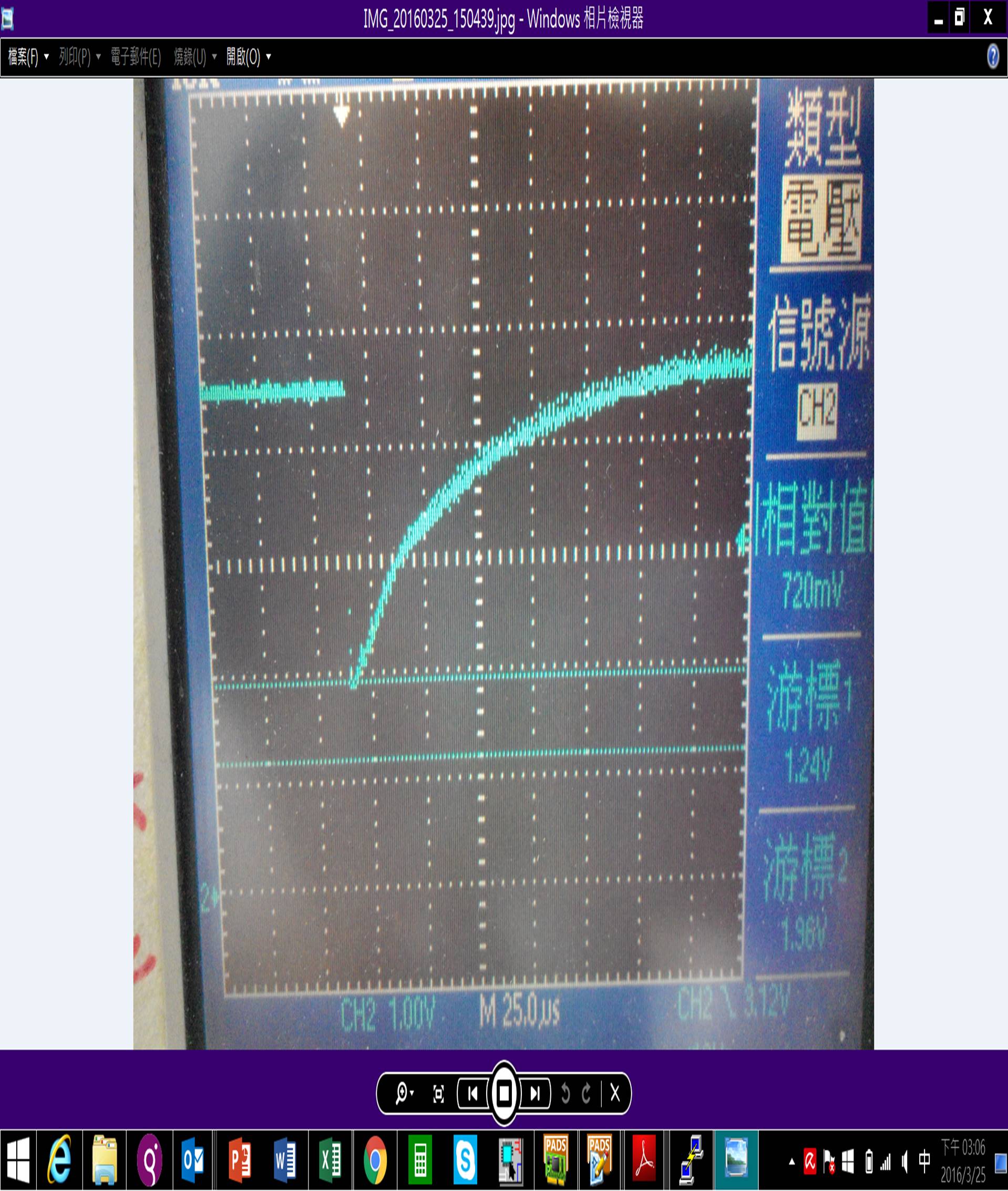

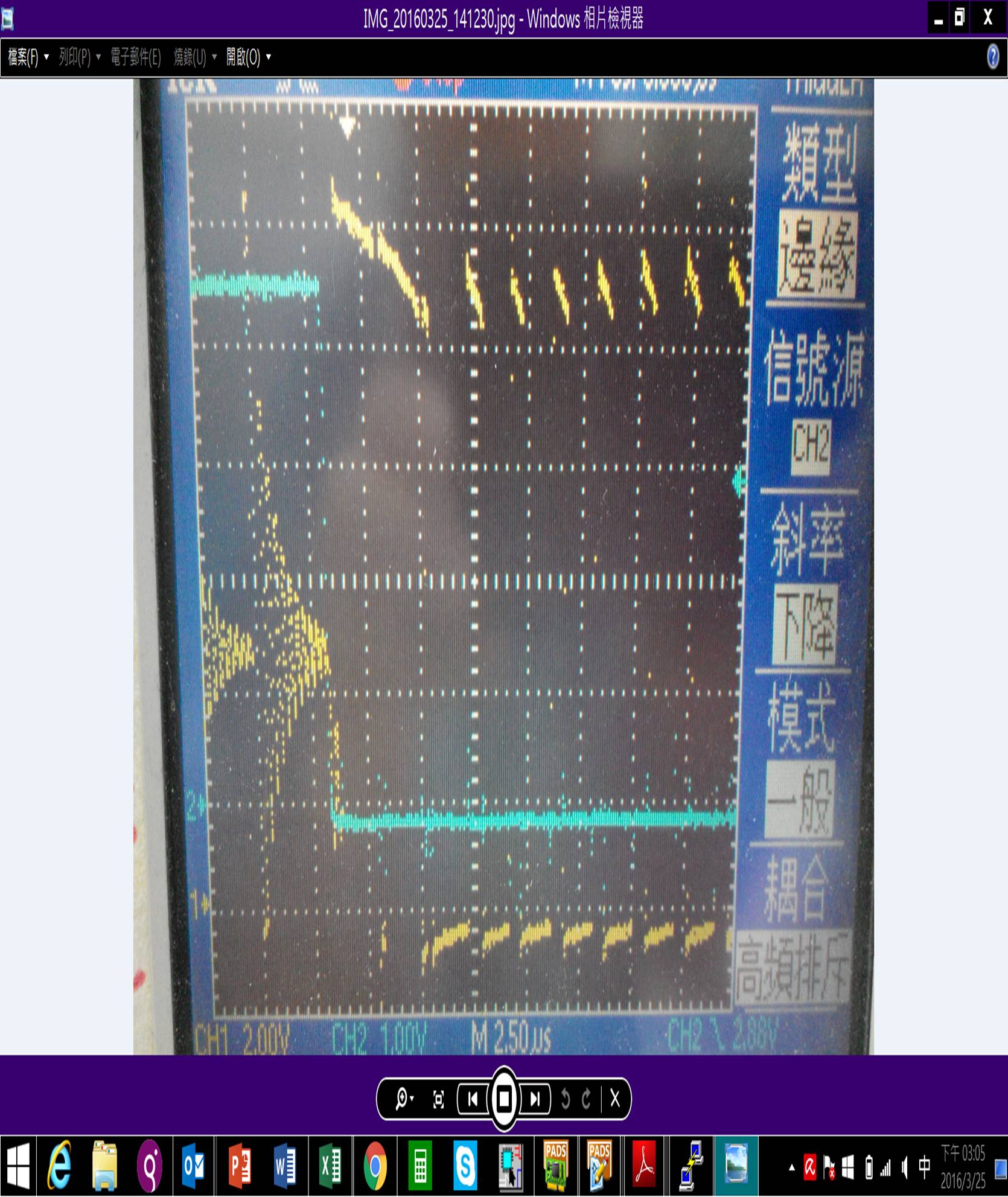

According to the above conditions and we found the voltage drop as below figure:
Voltage dropped when three DC/DC regulators are turned on:
Blue color:Reset signal, High=reset off / three DC-DC regulator turned off、Low=reset on / three DC-DC regulator are turned on.
Yellow color:TPS5430 switching signal.
After analysis, the voltage drop will be disappeared when removed three buck regulator input 22uF capacitor:
But these three input capacitor are be needed for these regulators and we've changed TPS5430 output inductor value from 10uH to 18uH but it still cannot improve voltage drop, even we added a feedforward capacitor with 22pF to parallel with R207 and the result has no changed!

  • The bitmap of the 3 regulators is too blurry to make out.  can you get a high resolution screen shot?  I need to see what kind of regulators they are.  I do not see why
    removing the input capacitors would help.  They need to be there.  One thing I can suggest is to sequence them so they do not all start up at once.  Another thing is
    you can try a larger output capacitor for TPS5430.  Do the three down stream regulators have any internal slow start?

    Is this caused by the reset circuit between TPS5430 and RT8097?because of the reset is our new circuit with this project. With old design we have no this
    reset circuit but for protection concerned and we have add this reset circuit between TPS5430 and RT8097. Do you have any suggestion that can improve this voltage drop?
