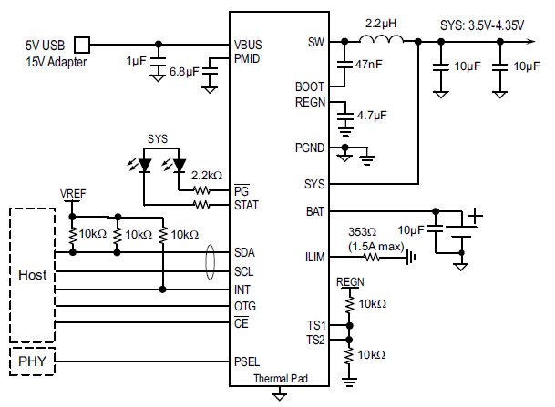

Hi Team,
The datasheet shows the following about REGN capacitor.
If an application that VBUS could accept both 5V USB and 15V adapter, should I adopt larger value(4.7uF) as the following schematic in datasheet page.1?
I believe it but would like to confirm just in case.
