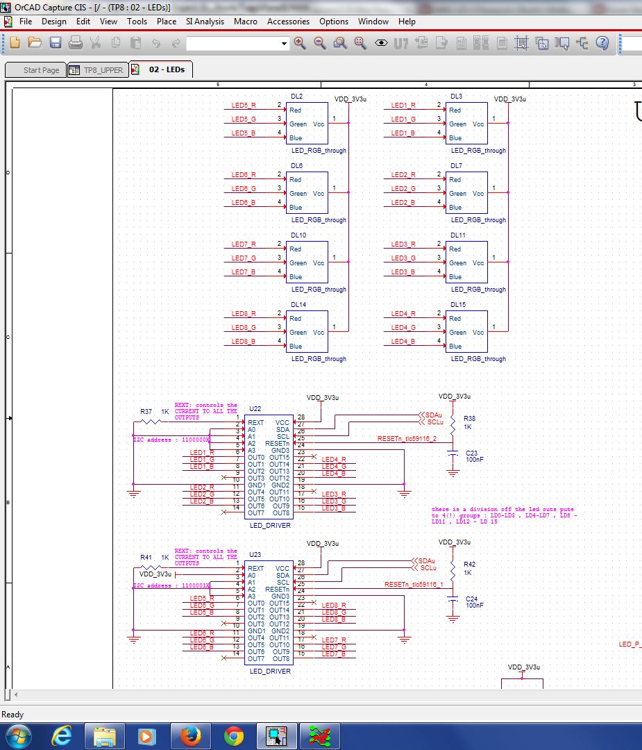

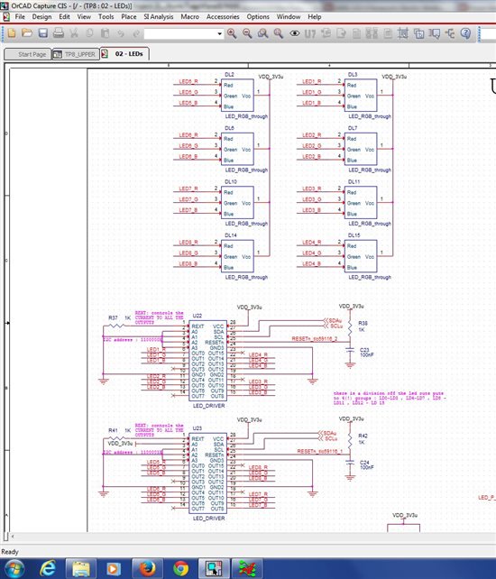

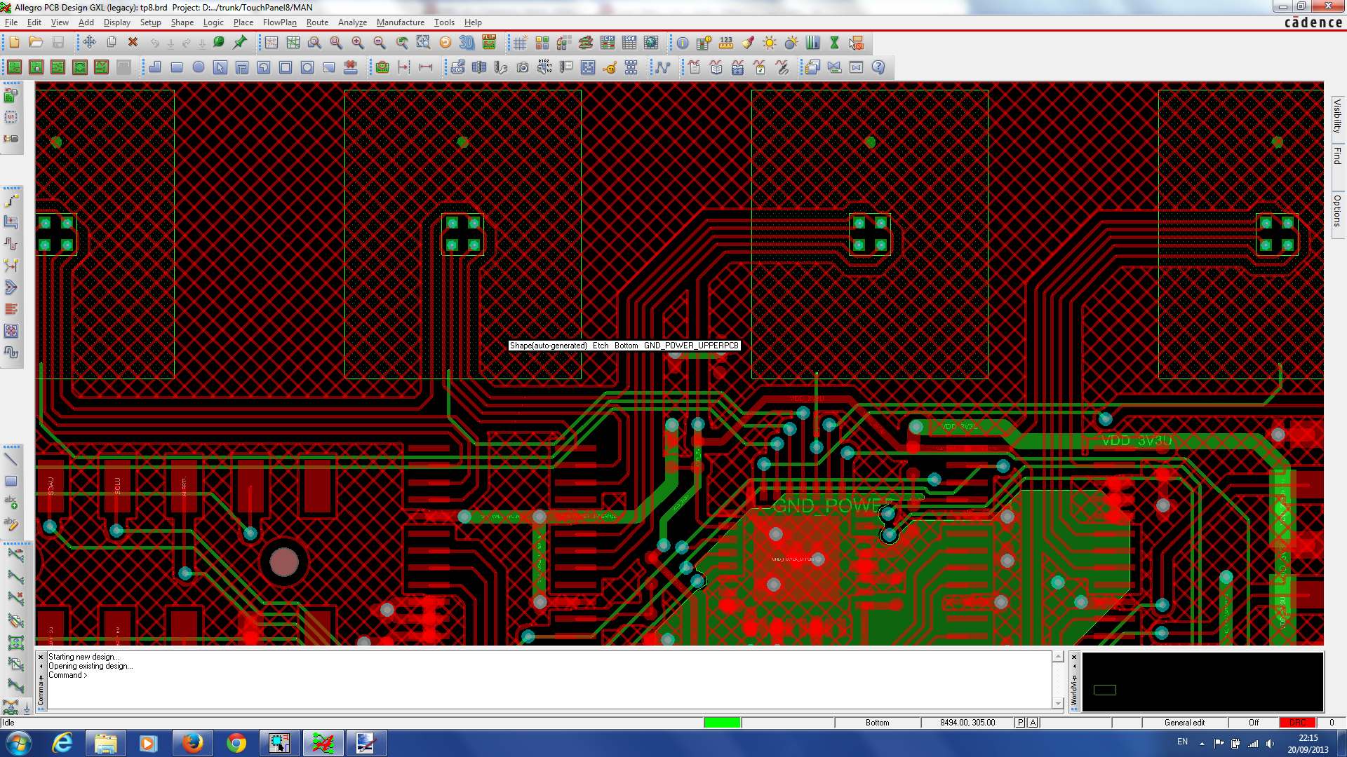

  • Hi Dick,
    The driver PN is TLC59116IPWR. The LED PN is SMLP34RGB2W
    Attached are relevant part of DSN and layout.
    Please, note, the LEDs are located in the middle of capacitive touch button. However, we followed all the rules and the buttons works pretty well.
    Please, advice,
    Michael
  • Michael,
    Thank you for the information.  I have a much better understanding of how you are using the TLC59116.
    The schematic is very clear.  It shows a 1kOhm resistor on REXT which will give about 18.75mA per channel.  The LED datasheet shows ABS MAX current of 10mA per channel with only 50% of that if multiple channels are on.
    The layout looks very clean.
    Have you changed any components to see if the LEDs with weak lighting follow the TLC59116 or the LED?  Does the weak lighting begin with the first power up or does it occur after some time?
    Dick
