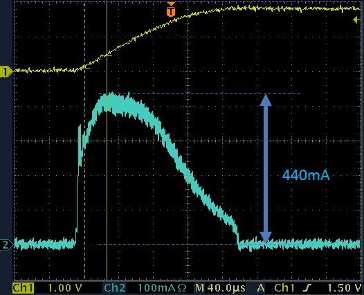

Please give your comment about attached inrush current I confirmed at EVM. Do you think this inrush current will cause of damage to LP5907? I think it will not be problem because this is not reach to current limit and this is short single pulse.
  • Vin=5V
  • Ch1:Vout
  • Ch2:Iin
