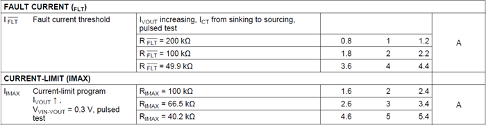

Could you tell me about TPS2420 dispersion?
The following word have been described in the data sheet
Whether the current limit values and the default value has the relevance?
Does this device have a different variation characteristic?
For example,
Does Current limit=4.5A Fault current=4.4A  type device exist?
Customers are concerned that the value of Falt and Current Limit is approximate value.
