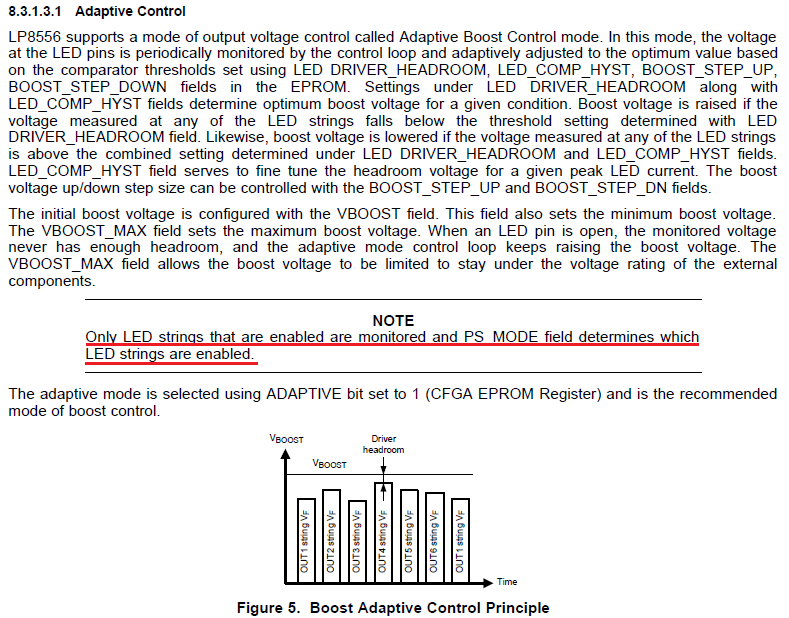

Hi Team,
I would like to ask two questions about LP8556.
1)
The datasheet page.14 shows "Only LED strings that are enabled are monitored and PS_MODE field determines which LED strings are enabled." as the following.
If I disable LED strings by LED_EN (16h, D5:D0) instead of PS_MODE(A5h, D6:D4), could I also disable LED strings?
I believe it but would like to confirm just in case.
2)
If an application require 2 strings only, does PS_MODE[2:0] should be "100"?
Yaita / Japan disty
    LED_EN and PS_MODE settings are AND'ed in terms of string enable, so you can use either one to just enable/disable each LED string, but PS_MODE decides phase shift operation depending on string count enabled.
    LED_EN decides which LED strings are enabled. With the information from both registers, LED phase shift can work correctly.
    In order to use 2 strings only, LED_EN[5:0] = 000011(LED ch 0 and 1 enabled), and PS_MODE[2:0] = 100 can be used.
