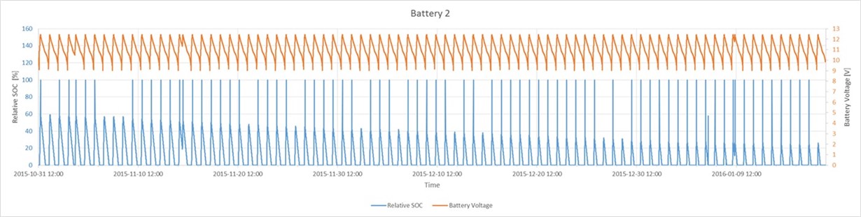

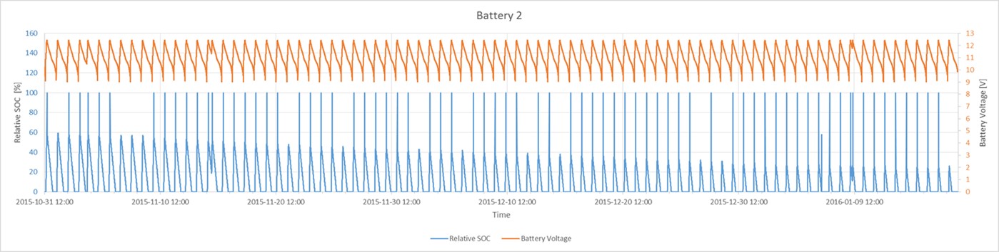

we have some problems with BQ20z95DBT.
The RSoC value of BQ20z95DBT is in about 10% of our battery packs not right. If the battery pack is fully charged the RSoC value is sometimes lower than 70%. This
problem happens not every load cycle it happens only sometimes and we don’t know why. The other 90% of the battery packs works correctly. The software and
application of all used BQ20z95DBT is the same.
Is this problem perhaps known and someone have a solution for this?
