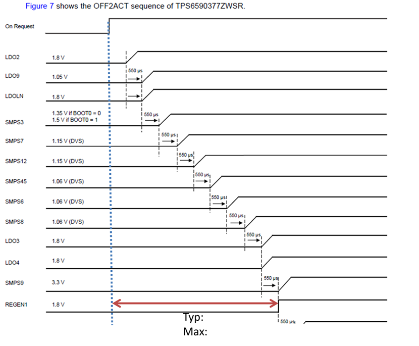

Hi TI Experts,
Please let me confirm the following question.
[Question]
Is TPS659037 defined the specification of the typical/Maximum duration time from asserting(LOW -> High) POWERON pin until enabling the "REGEN1" pin?
If yes, would you please teach me them?
I referred the Figure-7 on  "TPS659037 User's Guide to Power AM572x and AM571x" but there is not uncleared this specification.
Best regards.
Kaka

  • Kaka,
    Sorry for the delay.
    The time from ON request to LDO2 is not specified. Typically this is ~5ms, but this time can be longer if VCC is supplied at the same time as the ON request. If you need to use a maximum value, 15ms is a conservative maximum value.
    We do specify the maximum time for the sequence starting from the first rail. Each of the delay values listed are typical values, and these have +/- 10% tolerance. So to calculate the maximum time, I would use 15ms, plus each of the 550us (+ 10%) sequence delays to get the total time.
    Karl
