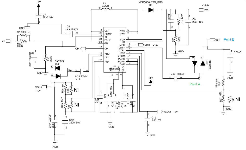

I am using the TPS65150 following the typical application circuit in the datasheet.  I only have problem with VGH
VS = 10.4V OK
VGH = 16 V , desired   ,  design values for R5=1M, R6=82K   --> this resulted in a much higher peaks that is not good for LCD.
 currently using R5=1M,  R6= 87.5K,  C4=C16=0.33uF.
The CPI output is a sawtooth peak = 17V , trough = 15.8V,   LCD is not stable.
I measuring the ANODE of D5 I can see burst of 1.2Mhz pulse when that creates the 17V peaks of the sawtooth output, following by no pulses and the output drops to about 15.8V and the burst comes in to raise the output back to 17V.
Is there a need to change C4 and/or C16?  There is no spec regarding the how much current that LCD needs.

  • Please post a copy of your schematic.
    I would like to double-check that your circuit really is identical to the one in the data sheet.

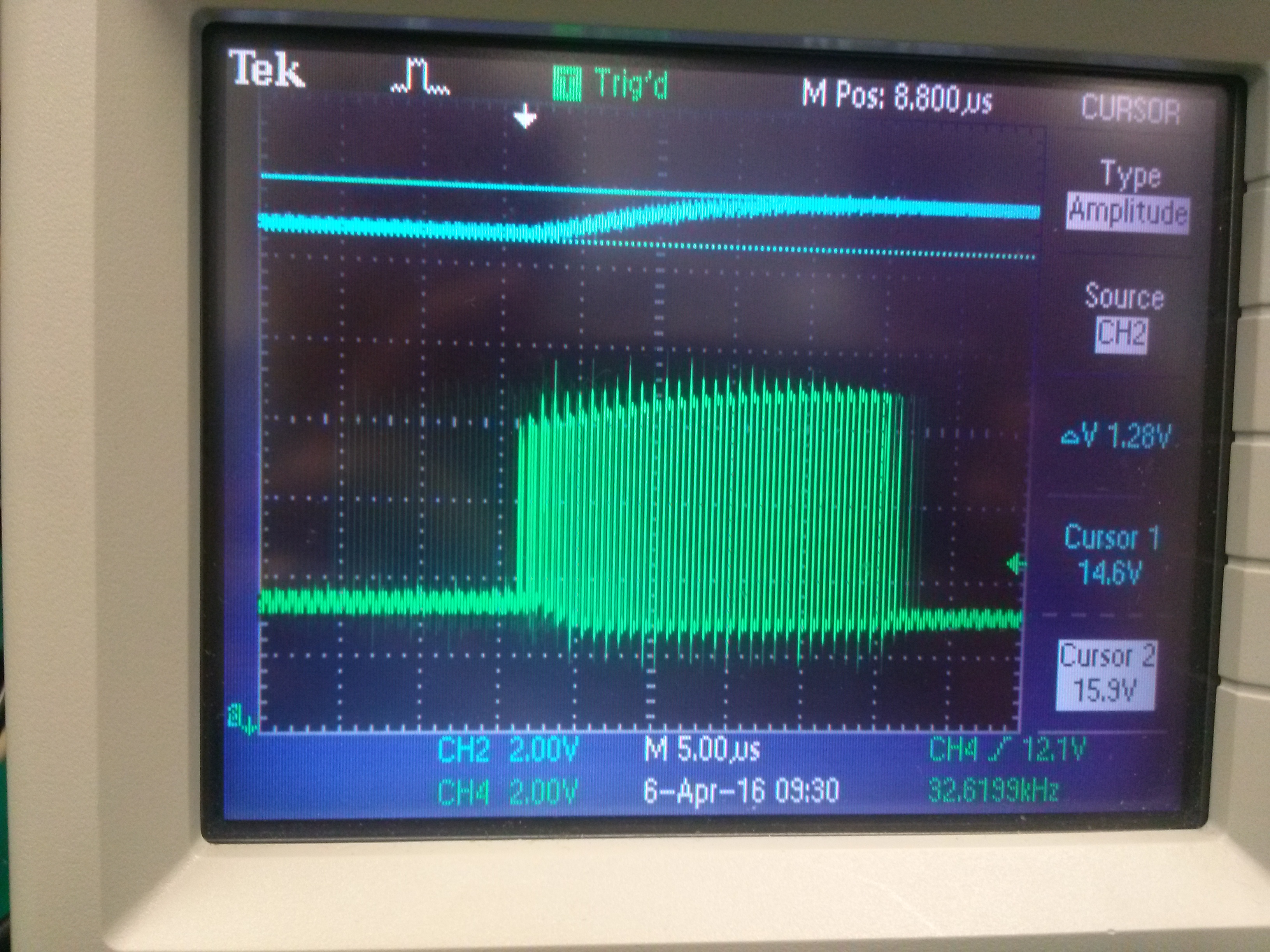

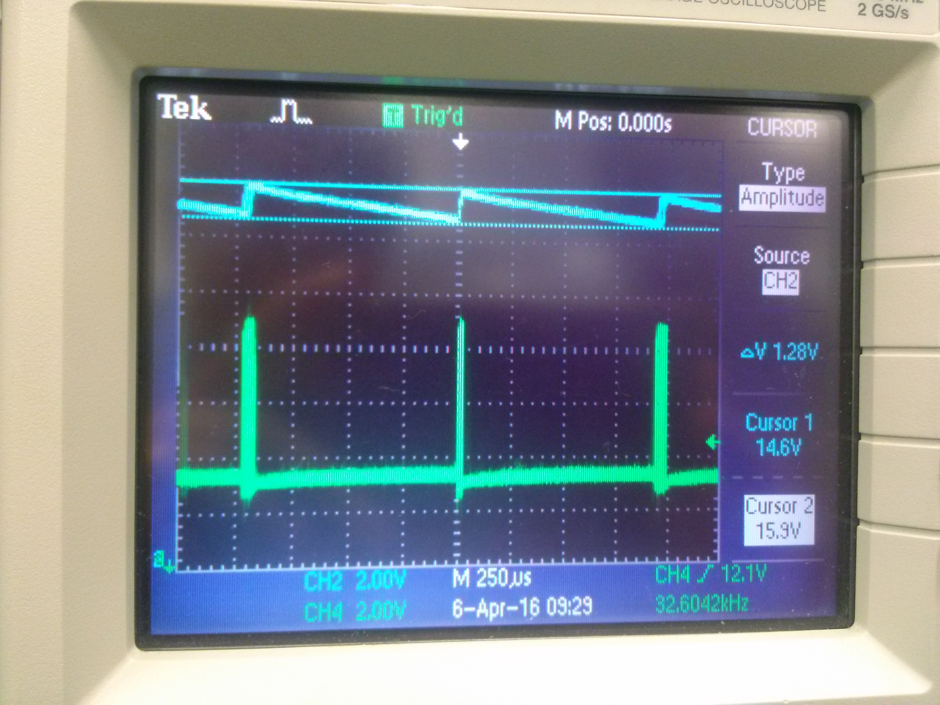

    Thank you for your response.  I have uploaded the portion of circuit and also some of the captured wave form.  Please note that the R27 is not 82K but 90K when the waveforms were captured.
    Blue wave taken at Point B,  the CPI output at the capacitor, see the sawtooth wave.
    Green wave taken at Point A, the burst of 1.2Mhz pulses that push up the CPI voltage, then followed by a period of no pulses.

    From the wave captured, CPI  Voltage is 14.6V and 15.9V.  It seems that the burst of pulse over charge the caps and pushed the output
    Increasing the capacitor at CPI only slightly reduce amplitude of the saw-tooth and lengthen the period of the saw-tooth.

  • The behavior you describe and what your scope plots show is not normal output voltage ripple, so I don't recommend you change any capacitor values. As you say, the positive charge pump switches for a few cycles, and then stops, presumably because the voltage on the FBP pin tells it the output is too high.
    It's possible that the positive charge pump in the TPS65150 is damaged, so I would recommend replacing U1. Your circuit looks fine to me; it's almost identical to the circuit used in our Evaluation Modules, which we know work correctly with these component values.
    Please try your circuit with a new TPS65150 and let me know how you get on.

  • I agree with you, if you have more than one circuit that shows this behavior, it is unlikely to be caused by a faulty/damaged TPS65150.
    I can't see anything wrong with your schematic, and I tested an EVM yesterday and I got 16 V from the positive charge pump with 330-nF capacitors, R27 = 82k, and no load connected. It worked just fine, so I suspect the problem may lie in the implementation of your circuit, not its design. At least, I think that's where we should focus our efforts right now.
    The FBP pin should be at 1.213 V, so something's not right there. Did you look at this pin with a scope, or just measure the voltage with a voltmeter? With the circuit unpowered, can you verify that there's a dc connection between the junction of R26 and R27 and the FBP pin?

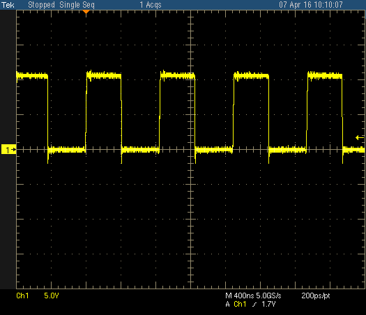

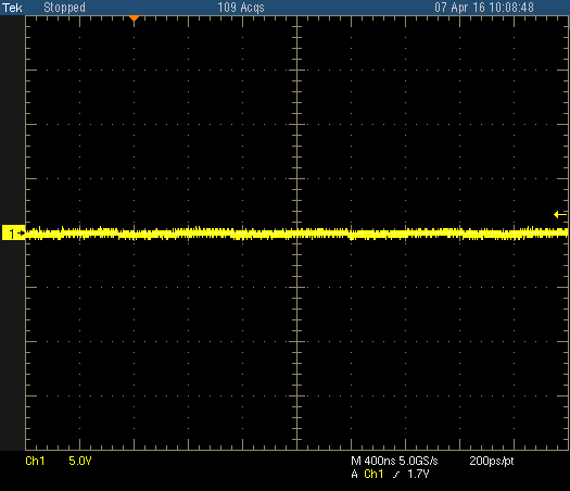

    To test your charge pump, you can do the following:
    1) Disconnect the load from your charge pump.
    2) Apply a voltage greater than 1.213 V to the FBP pin and monitor the voltage on the DRVP pin. The charge pump should stop switching. This is my scope plot of the DRVP pin when I applied 1.220 V to the FBP pin.
    3) Apply a voltage less than 1.213 V to the FBP pin and monitor the voltage on the DRVP pin. The charge pump should switch with an amplitude of about 10 V (the voltage on its SUP pin). DOING THIS WILL FORCE YOUR VGH VOLTAGE TO ABOUT 21 V – MAKE SURE NOTHING IS CONNECTED THAT WILL GET DAMAGED BY THIS VOLTAGE LEVEL. This is my scope plot of the DRVP pin when I applied 1.200 V to the FBP pin.

  • Hi Nigel,
    Thank you for your post.  Your post prompted me to look into another model of LCD display we had that also use the 65150.  I measured VGH for this model and it was perfectly smooth.   Checking DRVP, I noticed that the VGH is actually doing its job and maintain VGH stable and flat.
    Whereas in the problematic model that we were talking about, as you can see from the waveform I sent earlier, the 65150 did tried to regulate the VGH but overshot the desired value.  I figured it might be some noise/ringing due to the PCB layout that affected FBP sensing the voltage correctly.  So I added a 33pf across the FBP and GND.  Now the VGH is smooth.
