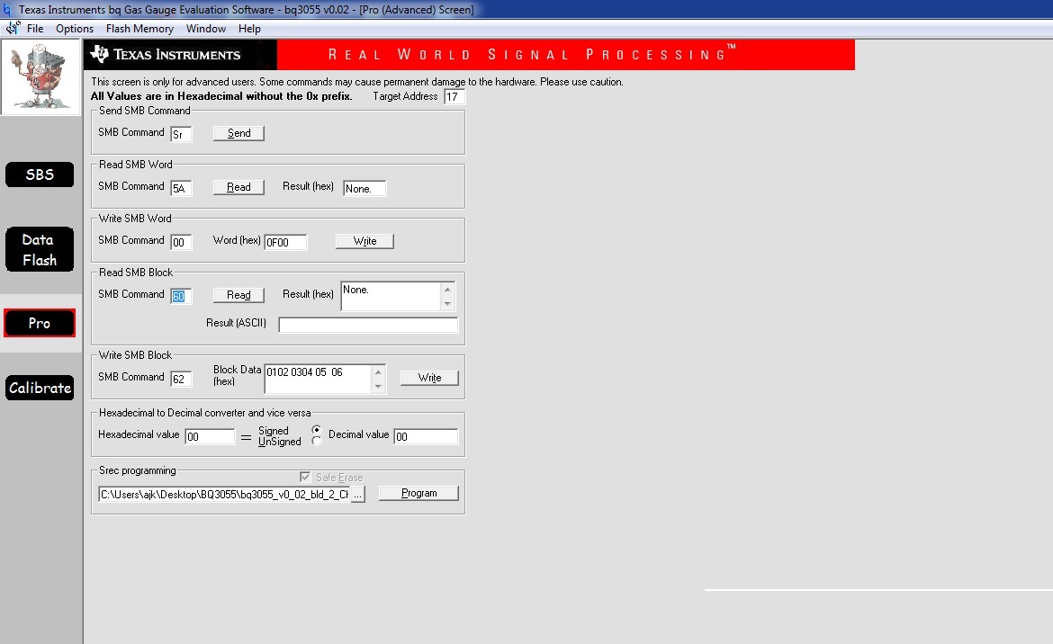

  • Hi Tom
    I've not had much success with the bqEVAL "software" when trying to obtain a .senc file.
    - after putting the pack in to ROM mode it has become unresponsive:
    - the PRO screen offers no option to read FLASH memory and shows "COMMUNICATION ERROR" in the bottom left
    I attach a screenshot:
    Detailed instructions on how to get round this might help us provide the .senc you requested.

  • Put the gauge into ROM mode and then go to the Flash Memory pull down menu and export the senc file. I will check on the K-factor override flag.

    the screeenshot I posted was of the bqEVAL software after I had put the gauge in ROM mode.
    The software we have version 0.9.75 & I cannot see a FlashMemory drop down menu: I would be grateful if you could provide instructions (a screenshot) to help.

  • The Flash Memory drop down menu is shown in the screenshot that you provided in the earlier posting. It is located between the Options and Window drop down menus.
