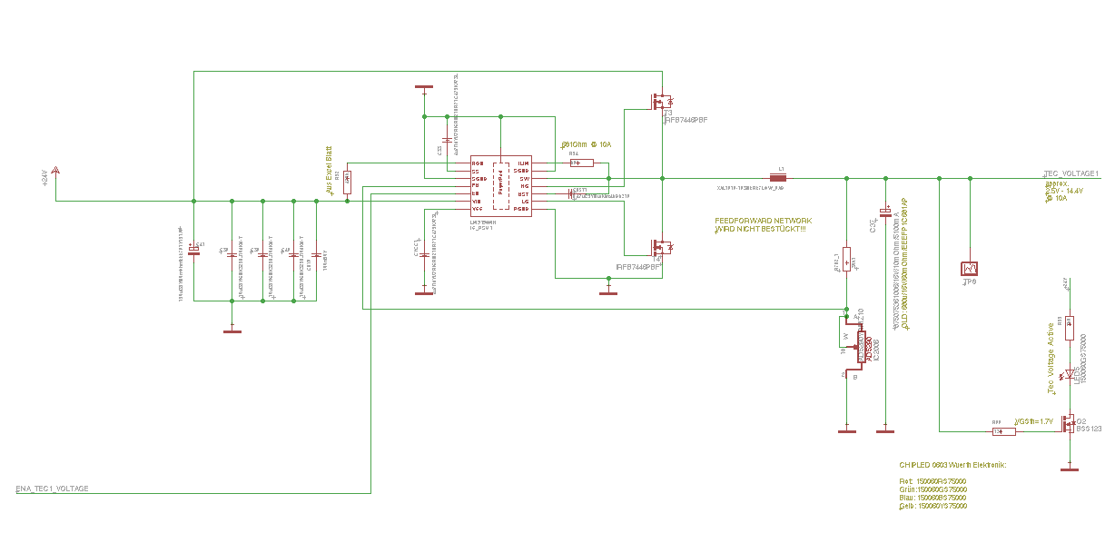

I got a little big Problem with LM3150:
While operating for like 2 Hours at constant Output Voltage and constant output current it happens that the switcher changes output Frequency from >100kHz to
10kHz. You can can hear the inductor start making noise and inductor Temperature rises to around 200°C and unsolders itself. Im wondering what can be the reason for this because the switching Frequency is programmed by a Resistor. It happened now with RON 470kOhm --> 100kHz and RON 220kOhm. I observed that even same Resistor values are used the Output Frequency on different Converters was not the same. Acutally i use 6 of the Converters to get 6 different Voltages which can be digitally programmed by a digital Potentiometer in the Feedback Loop. Can it be that i overheated the IC soldering or can it be ESD damage to the device happened earlier or is it a Layout issue? The device is still working but the Capacitor is getting damaged from the high ripple currents of the low switching Frequency. So how can it happen that the Output frequency can dramatically change while operating?????

  • Thanks for your Answer. This is a very useful Information. Didnt know about a test mode of the device.

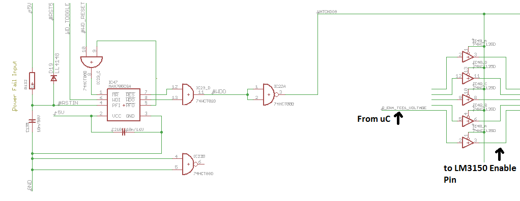

    Generally the enable Pin is connected to a Microcontroller through 74HCT125D Line Driver IC both supplied with 5V. But
    there is a long wire between the line driver and the LM3150. And  I think it might be possible it could exceed 7V by noise for
    short moment. Also the 74HCT125D proved not to be the solution i wanted regarding the watchdog observing power supply and
    the microcontroller toggle pin because of the high impedance off state. It should be grounded in off state.
    Guess im gonna put an RC filter in front of the enable pin to avoid it can exceed 7V and acting as pull down to ground in high
    Here the schematics. After a lot of calculations from the datasheet the panasonic capacitor came out because it fullfilled the ESR
    requirements. then i tested the Würth Capacitor after the first capacitor blow up and it proved also to be working up to like 15V output Voltage
    till its getting unstable. Its more then i require for the project. The output voltage should be programmable from around 2.5V till 14V with up
    to 10A of Current. This was the requirement. I removed the feed forward network because it worked without it.
    Thanks for your help.
