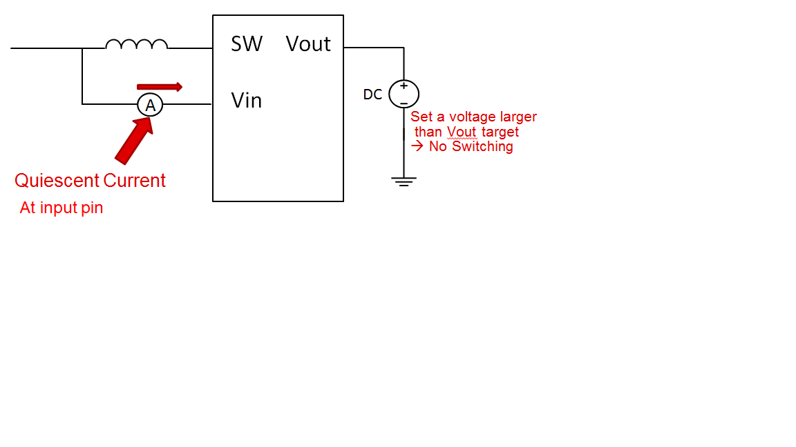

    When the mode pin is connected to the GND, and let the converter works in the PWM mode, the no load current will be big, in mA level.
    When the mode pin left open, the converter works in PFM mode, the no load current will be small, in uA level.
    In no load condition, the IC is still switching.
    But the quiescent current in datasheet is tested when the IC is no switching.
    So no load current and quiescent current is a different item.
    What is your application, could you let the mode open and make it work under te PFM mode? thus the no load current will be much smaller!
    BR,
    Helen
  • The following picture gives out the quicesent current test at Vin pin. So it is different with no load current you tested.
