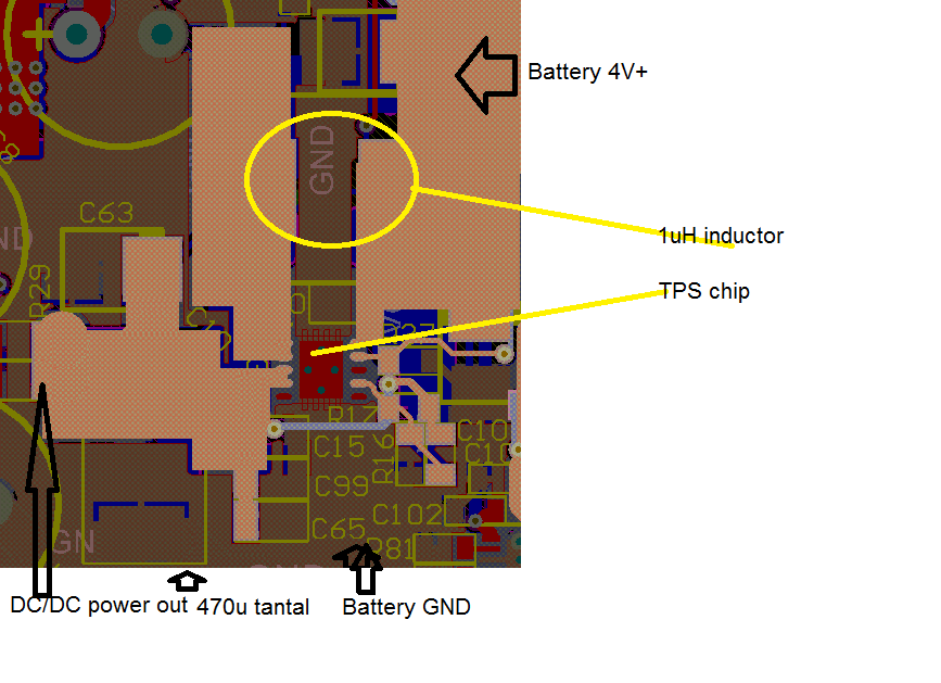

Hello. I use TPS6123x as typical DC/DC step up converter form Li-ion cell (3-3-4,2V) to 5.15V DC 1,5A power out.
My problem is that TPS is occasionally  damage  (burn). Unfortunately it caused burn whole PCB....... (high energy from Li-ion cell)
It is typical application exactly within TI suggestion

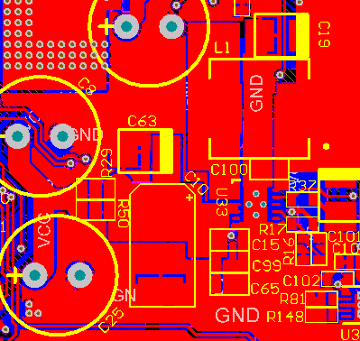

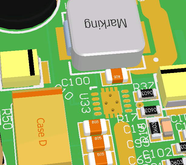

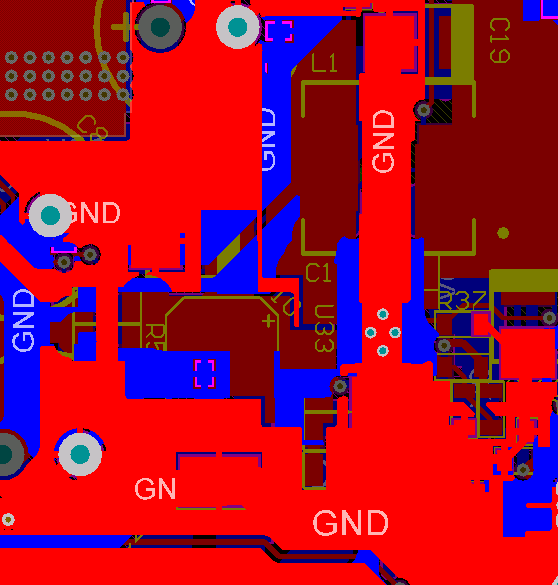

    please look in schematic (partly simplified for better understanding)   and PCB layout (.png) and Atium PCB
  • the COUT and the IC are connected on the same layer, right? if yes, the layout look OK.
    could you help to check the stability of the boost converter? and optimized the Cff, Refer to this application note SLVA289
    it seem the device is only damaged by short circuit from your experience, correct?
  • Hi Jasper
     COUT, are you thinking about 3x capacitor 22u/10V X5R (marked on my schematic as c15,c65,c99)?
    if yes, capacitors are connected on the same layer, please take a look that i have additionally tantalum capacitors connected on in input (2x 100u)  and output 100u +470u, also very close on chip and connected on the same layer.

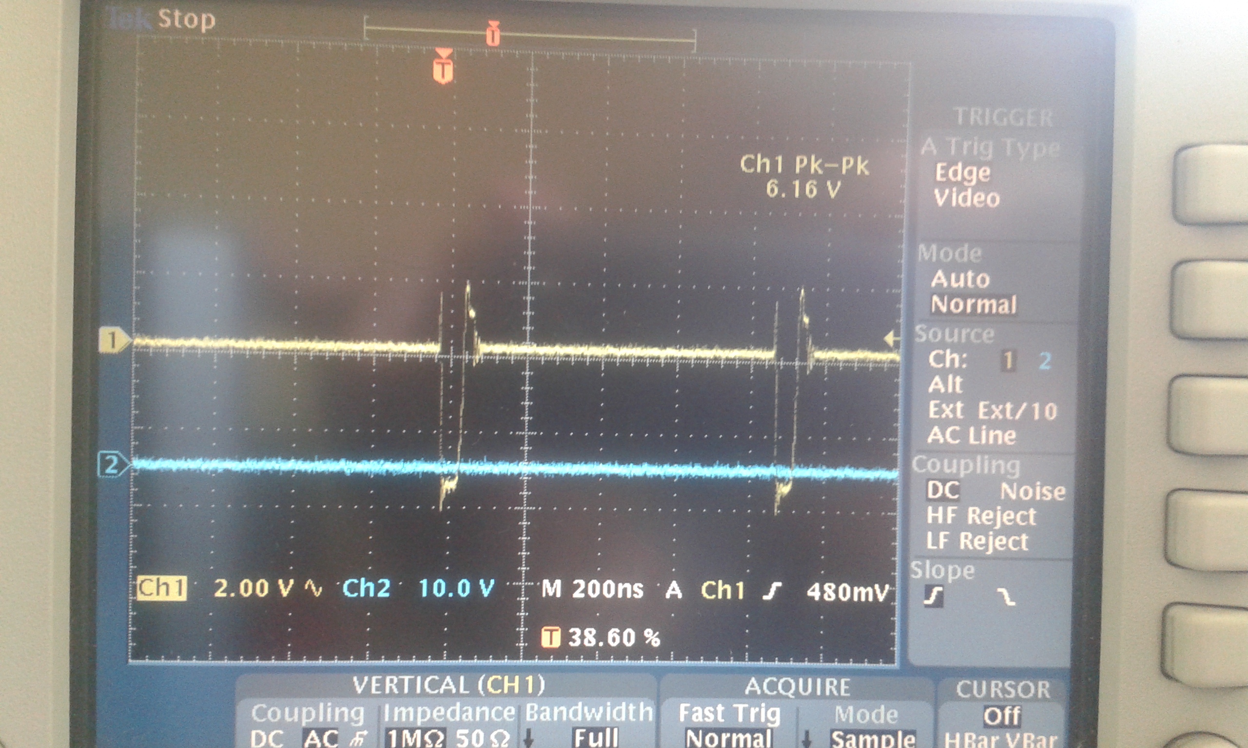

    could you help to test the waveform SW, VIN, VOUT and inductor current at the time the TPS61230 is enable by the MCU? you can test the waveform in the good system board. i want to check if the device operates normally in the system board after the device enable.

  • hello Jasper i t thought  about conditions for  waveform:
    please take me rules for measuring, my DC/DC converter should be  be work  in range  0-1,5A/5,15V.
    I need to know current output for waveform..... and input voltage.....
    regards Mariusz

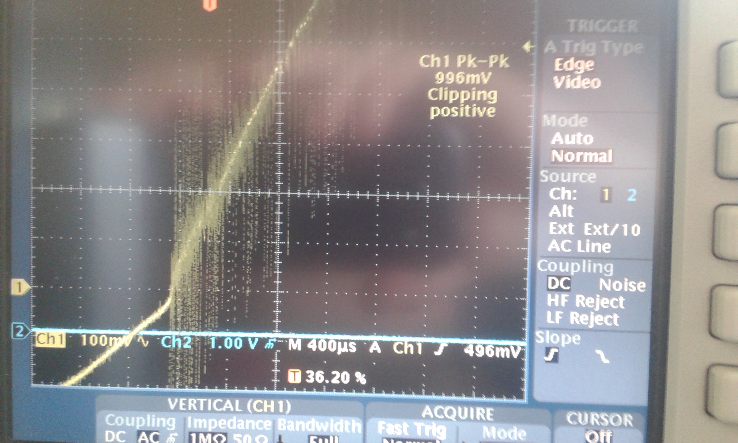

  • the test condition should be VIN=3.6V, IOUT=1.5V. please measure the waveform at the moment that the boost is ENABLE and startup to switching.
    and also the waveform after the device is stable and operates at VIN=3.6V, IOUT=1.5V, VOUT=5.15V condition.

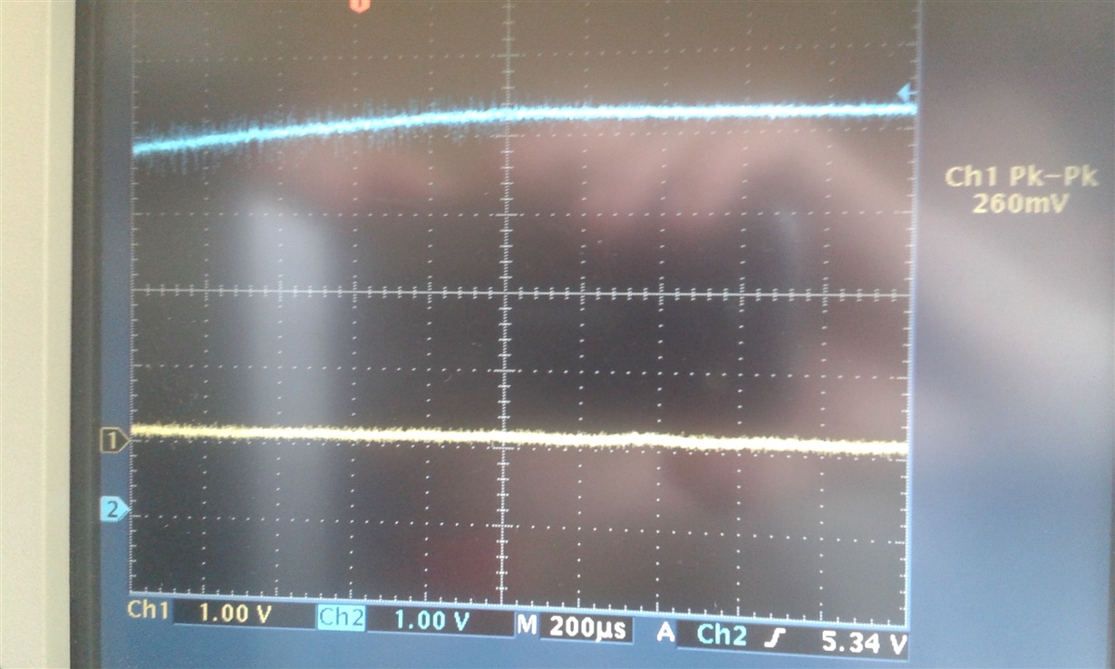

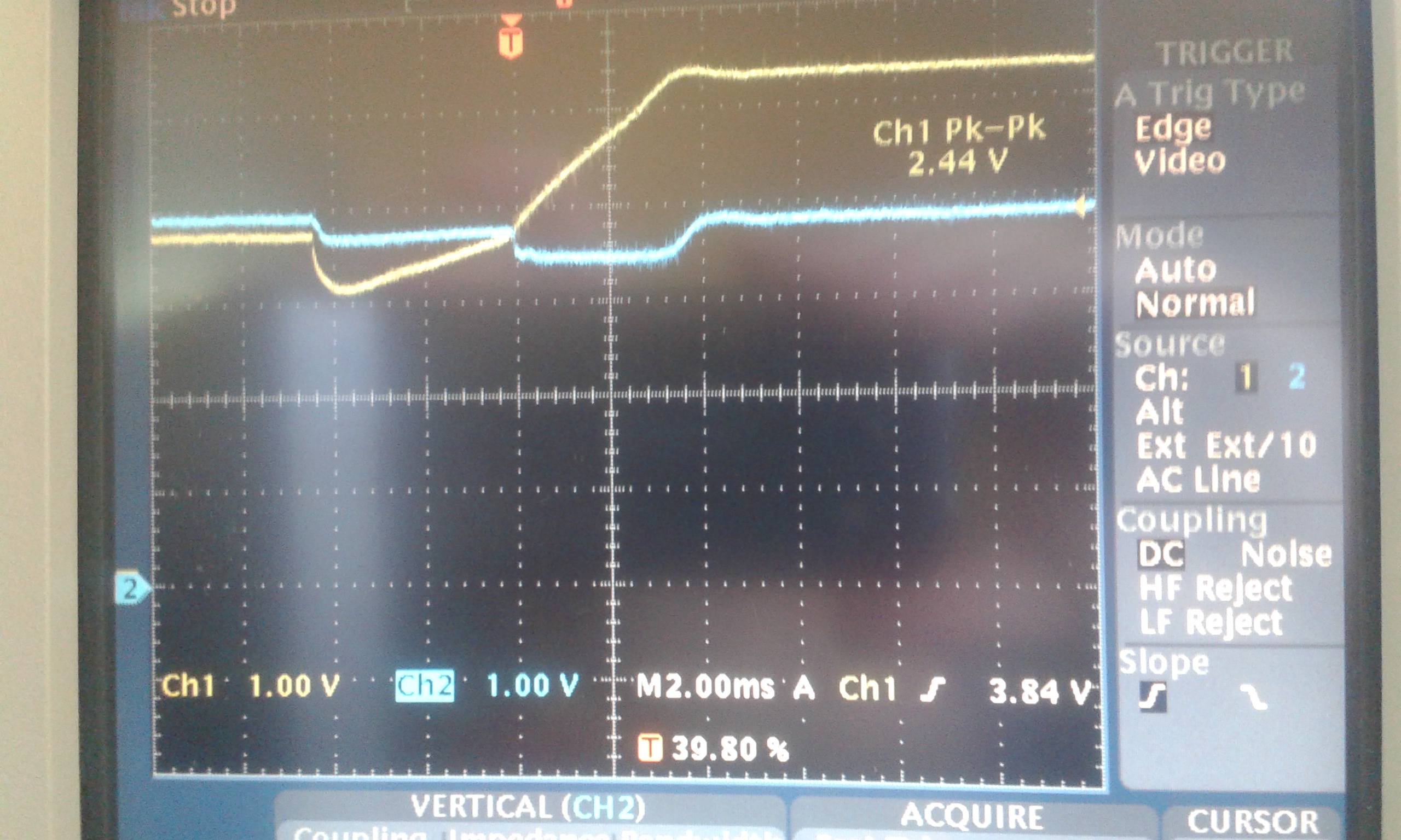

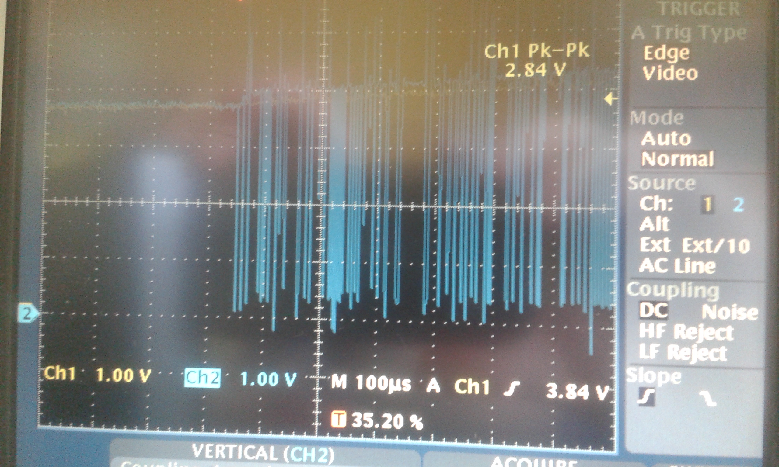

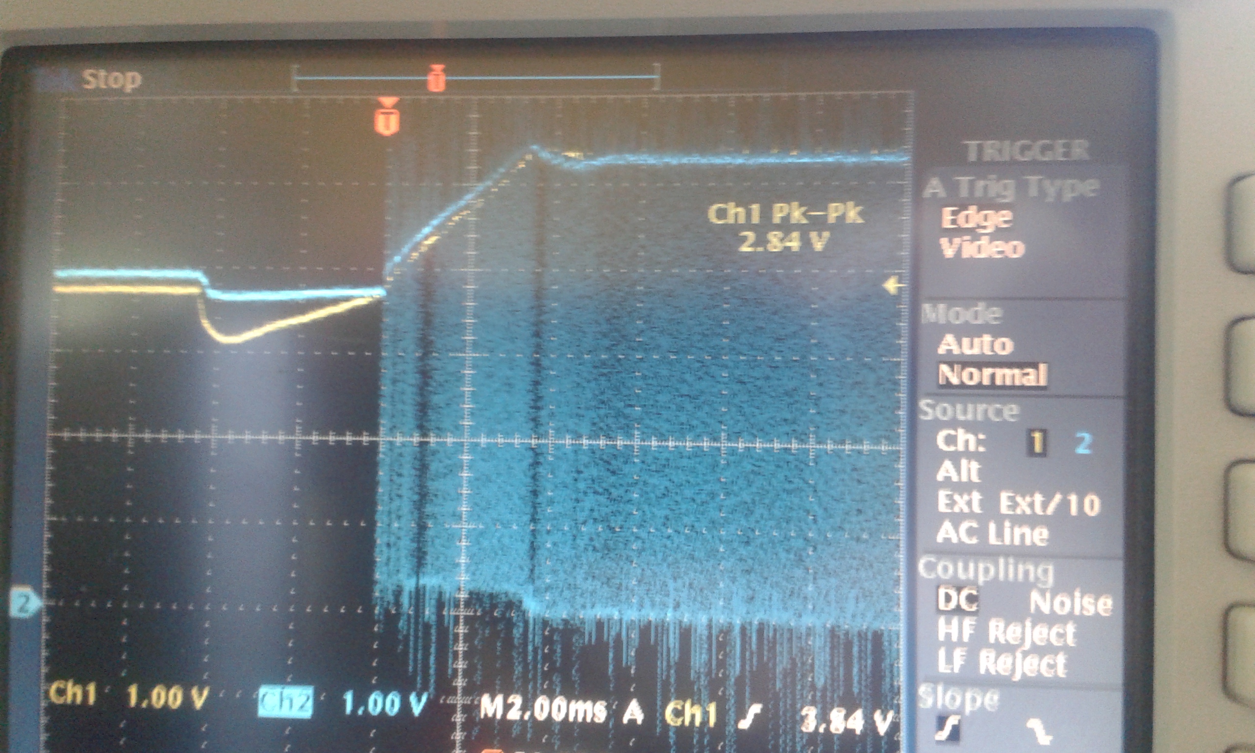

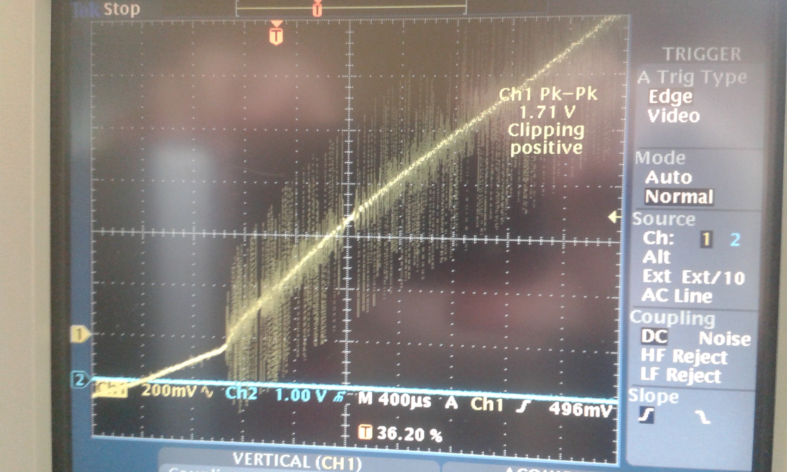

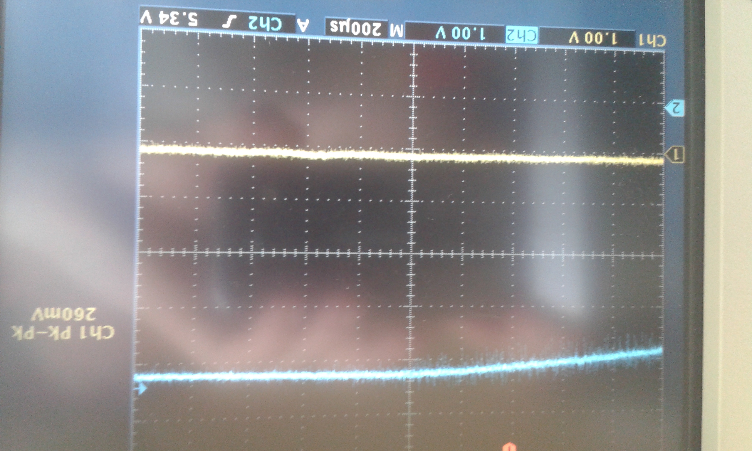

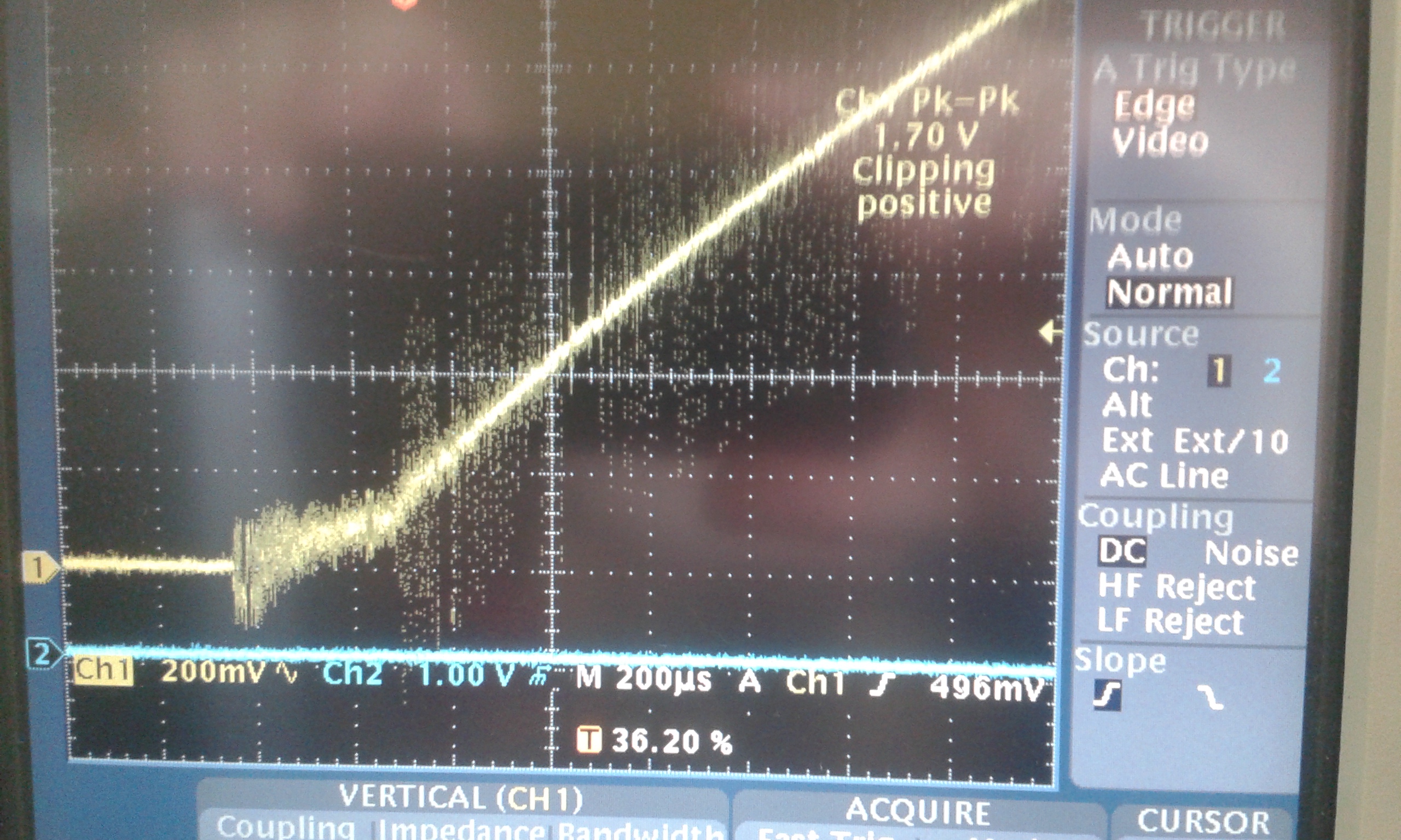

  • Hello Jasper.
    I the probe was done. In case voltage between GND and SW pin
    You can see two case
    1) voltage drop (current on track between accu and chip) (unknown resistance but probably  ~~40mohm)
    2) SW-GND normal work with full lead
    3) SW-GND in start converter
    4) Out - GND  voltage output on start
    Do you have an idea how to measure current inductor without increase inductor circuit resistance ?
    current coil is difficult to measure so i made measured voltage droop on track from accu to chip.
  • 1. the inductor current should be measured using current probe. place a wire in series with the inductor, and measure the current flowing through the wire
    2. for the fourth waveform, the VOUT drop down 3.2V then ramp up. may i know why? could you measure the VIN and SW at this period?
    and i don't see problem in the other three waveform
    3. there is an external power supply connected to VOUT of the TPS61230 as mentioned. does the power supply sink current? i just want to confirm that the external power supply does not sink large current and damages the TPS61230.

    1) VIN (blue)  vs Vout (yellow)
        Vout  vs SW
    the same but.

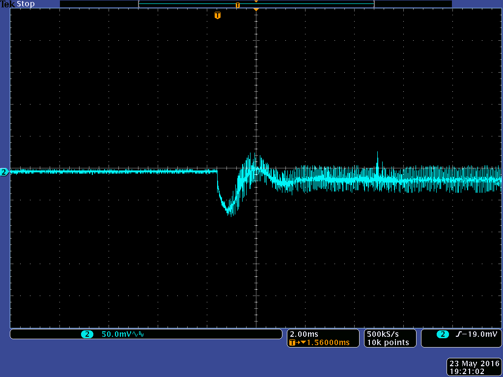

  • yes. it is hard to measure the inductor current with current probe.
    from the VIN , VOUT, SW waveform, the device operates normally. so don't need to measure the inductor current.
    could you measure the load transient performance according the page 5 of application note "SLVA289"? i want to check the stability.
  • Hi Jasper.
    please look in my measure circuit. I think that it is OK.please confirm.
    What signal i can use for trigger probe?  in mentioned document is used load current  (in my circuit I don't have this possibility)
    what should be expected  time-line in oscilloscope ?
    In this case i used slope for trigger
    within mentioned document my R1=430K R2=102K C=470p

  • 1. the measure setup is good. you can just measure the VOUT ripple when the load is switching between 0A and 1.5A. the VOUT ripple should be level of 100mV~200mV. the time scale 100uS to 1ms

    My scope  waveform was as attached pictures . I don't see typical Waveform pattern within SLVA document (by DC/Dc started)
    What  do you need else, to confirm that the device are stable or not ?
    blue line = measured voltage output when DC/DC are starting (full load 1,5A capacitance  4000uF from 0V )
  • could you measure the VOUT transient waveform (IOUT = 0A->1.5A)? the VOUT waveform should be AC coupling. and scale should 100mV/div.
    you can capture the waveform when a load, such as 3ohm resistor, is connected to the output of the boost converter. you'll observe the VOUT drop down several 100mV, then increase to normal voltage.

  • Hi Jasper
    I made few pictures with different  base time
    so first three, presents when module isn't on circuits.(without right side load)
    in ths case on TPS output is connected 3x1000uF (aluminium)  and 470uF (tantalum) and 100uF (tantalum),  in this case, load for other PCB elements is very low..... <100mA
    next pictures presents waveform when module is on circuits (right load side is connected for TPS)
  • Attachment is my measurement with the TPS61230EVM and 10000uF output capacitor. it seem good.
    what you attachment should be startup waveform, i don't see problem from the waveform
