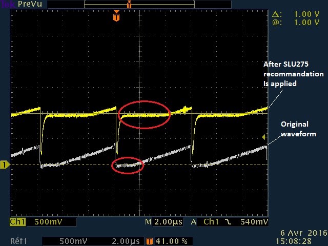

I am facing an issue with ucc2895 which corresponds to the problem raised in SLU275.
OUT C and OUT D are assymetrical when COMP is approx. 0.87V. As recommanded in SLU275, I have inserted a 1V DC offset to the ramp with a 2.2k resistor. The ramp now looks like what is shown in SLU275. Now, the operation is correct at 0.87V but the operation is assymetrical again when COMP is approx. 1.82V. Bascically, I have pushed the issue 1V above. Have you experienced a similar situation? (Normally pictures should be enclosed in this post).

    To sum up the situation, I am in Peak Current Mode Control and I operate in open loop i.e. EAN=EAOUT and EAP is controlled with an external power supply.
    No 400V input but I only supply VCC to circuit and control EAP with an external power supply. OUT C and OUT D asymmetrical behavior occurs when COMP cross the lower part of the RAMP :
    - When SLU275 is applied (@COMP = approx. 1.82V)
    - When SLU275 isn't applied (@COMP = approx. 0.87V)
     I do not know if the flatness of this area can explain this behavior (see picture below).
    This situation is similar to a Voltage Mode Control with a low RAMP signal, isn't it? So I wouldn't expect this behavior.
    Assymetrical operation at COMP=0.87V.TIF

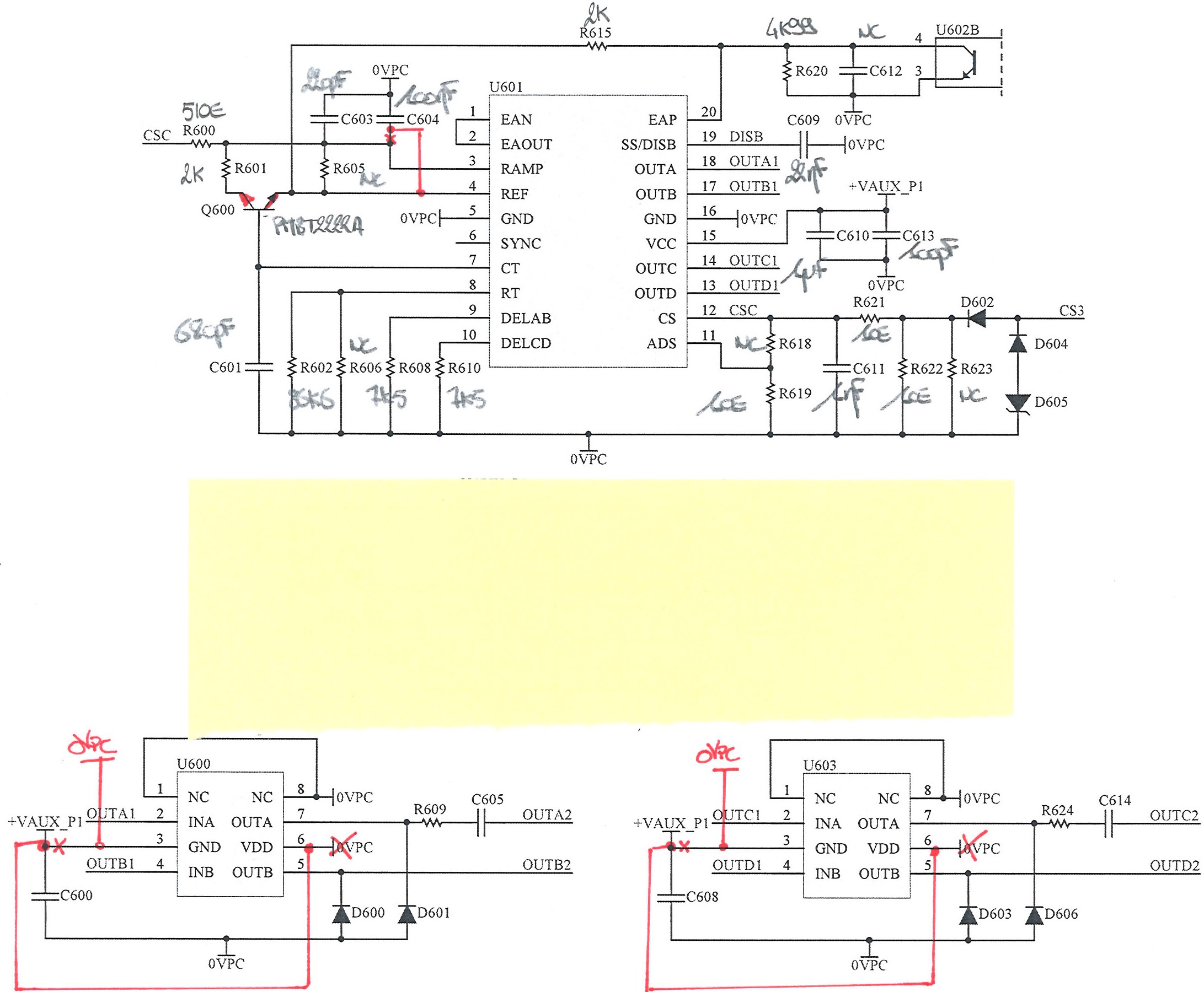

  • Hi Guillaume,
    We will take a look at this, do you have a schematic of the circuit around the controller that you can share?
    Peter
  • I read the app note, SLUA275 and you seem to have implemented it correctly.
    I don't know how much slope compensation you have applied, normally one adds a ramp whose slope is 50% of the output inductor downslope and in this case I would suggest you increase the amount of slope compensation applied to the RAMP and CS inputs and see if the behaviour improves.
    There is also a possibility that noise is being injected on to the CS or RAMP inputs but I'd check the slope compensation first.
    Let me know how you get on.
    Colin

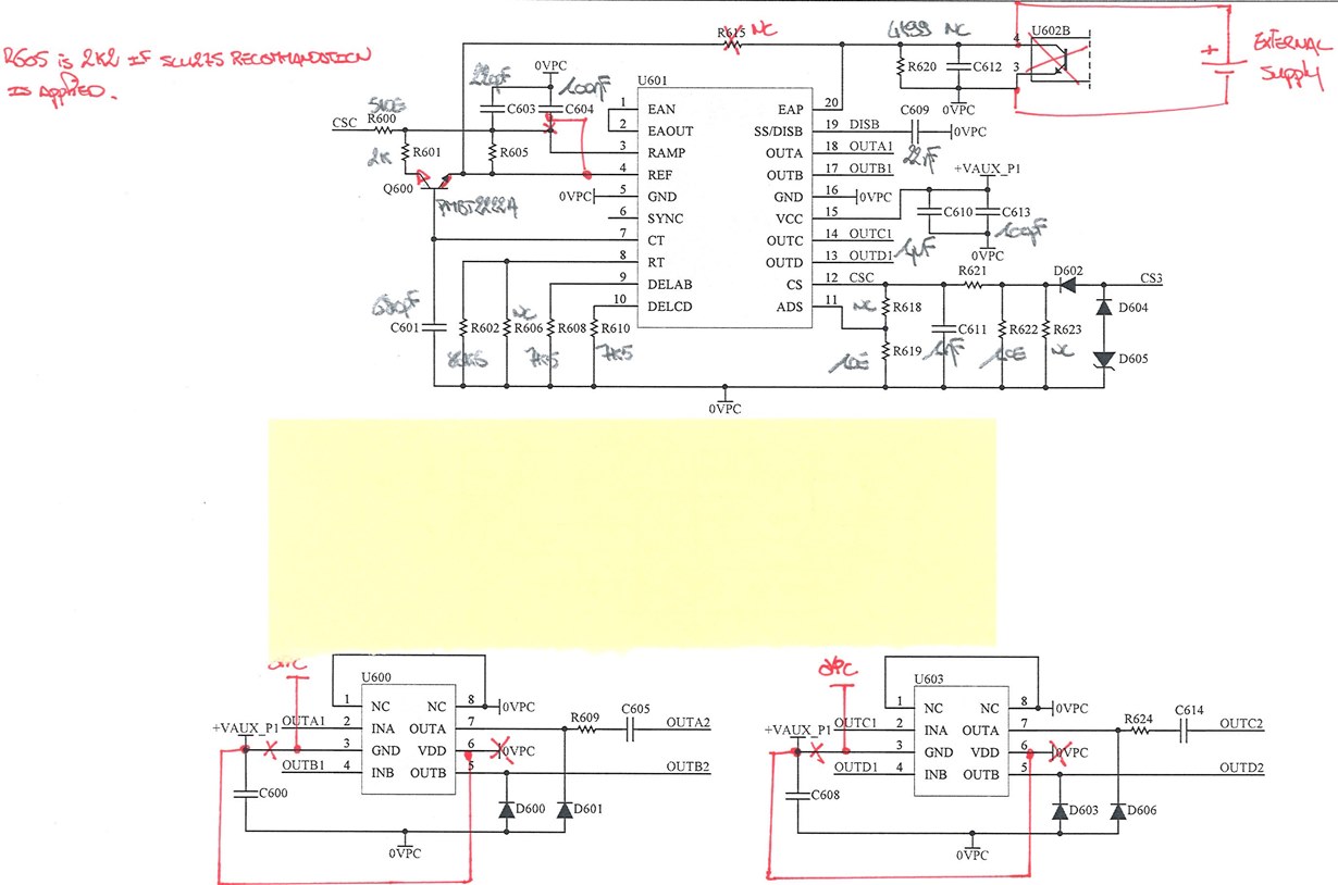

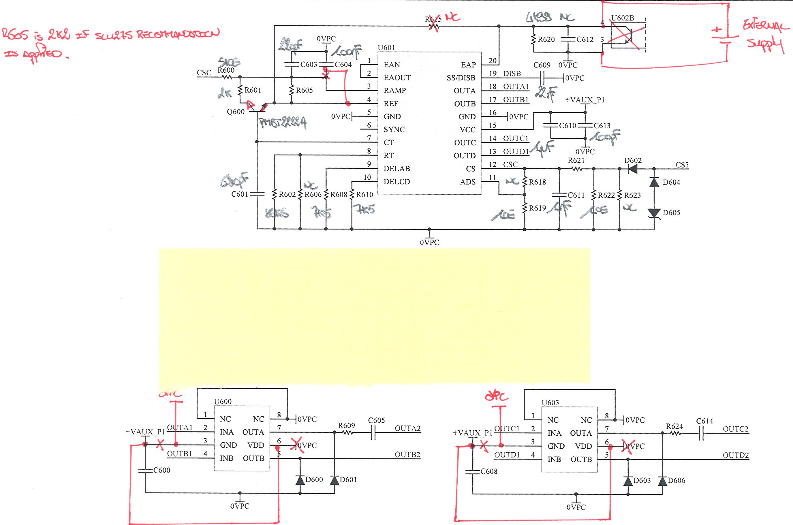

  • Yes Peter. Please find two schematics below:
    1- Original schematic
    2- Schematic when testing with EAP tied to external supply
