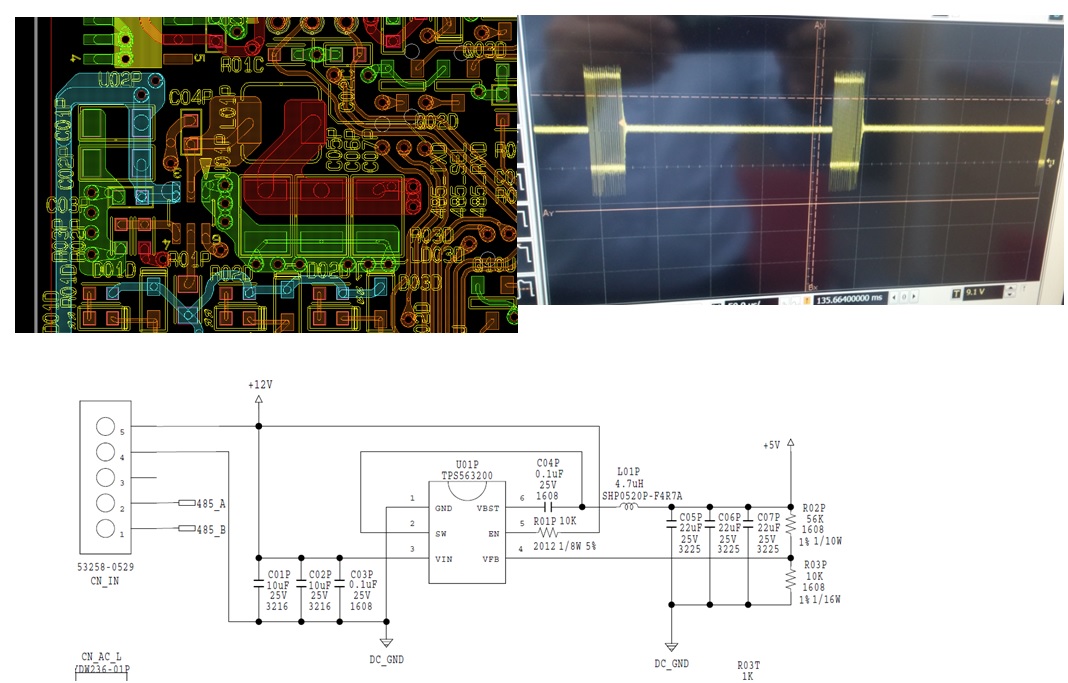

Customer made a TPS563200 board, input is 12V, output is 5V, load current is 40mA.
But IC always works like burst mode operation. When added additional load with electric load, IC didn't work like DCM or CCM, just increase burst mode interval.
Checked layout and it looks not bad, what case make IC works like burst mode?
Any advice will be welcome. (attached data)
