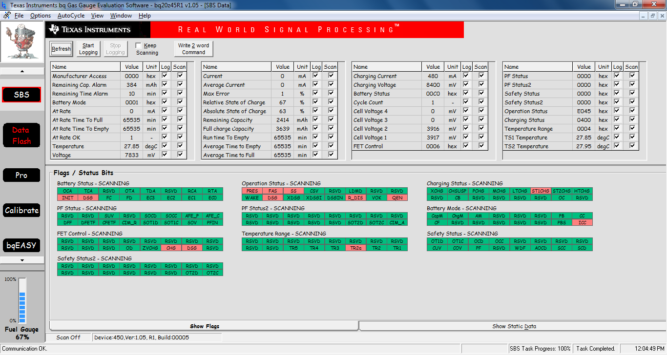

    Since we are working only with the battery pack, we don't have the access to the gas gauge inside the pack. The problem we are facing now is, we could not get the battery voltage at the terminals even if we pull the "/PRES" pin to GND. This could be due to the damage of "/PRES" pin. But we are able to communicate to the battery through SMBus and could read that battery has enough SOC in it . Please see the snap shot of the register values read through gas gauge evaluation software.
    Can you please inform whether there is a way to activate the battery pack if /PRES pin is damaged?
    SUNIL
  • Hi Sunil,
    I notice from your screenshot that your PRES pin is not being set. If you are pulling the pin low and still cannot get this bit to set, there could be an issue. There is a bit in Op Config B, [NR], which when it is set, it can ignore the physical pin's state. However, if the PRES pin is indeed damaged, it is likely you will not be able to charge or discharge, and the IC will need to be replaced.

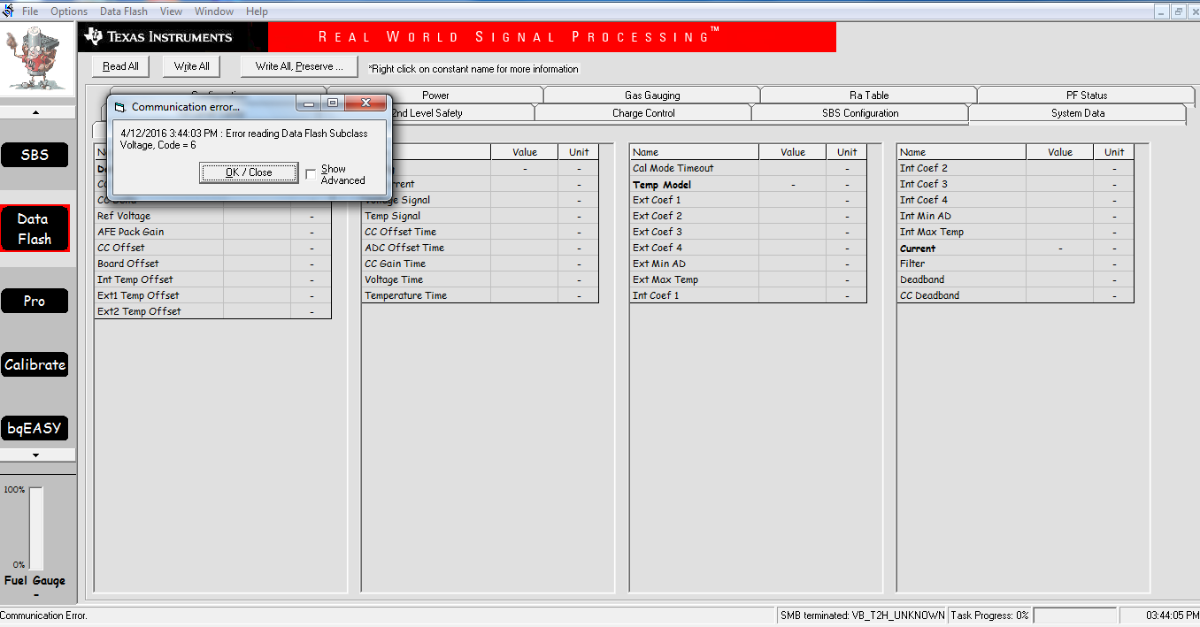

  • Hi Justin,
    We have tried to read the Operations Cfg B register, but it shows some error message while reading.
    Please find the attached screenshot.
