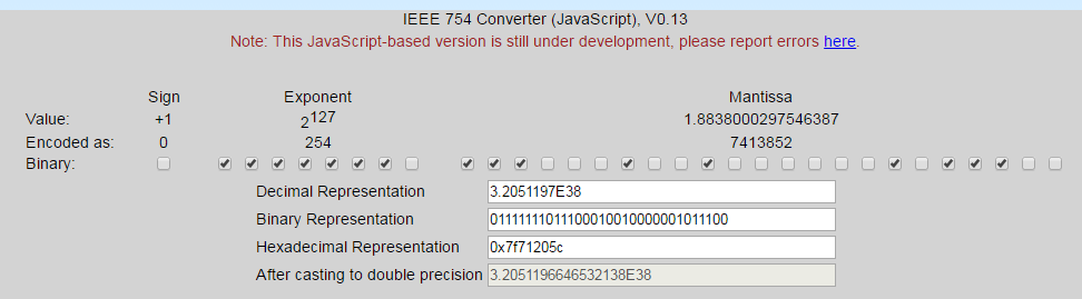

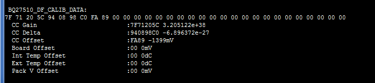

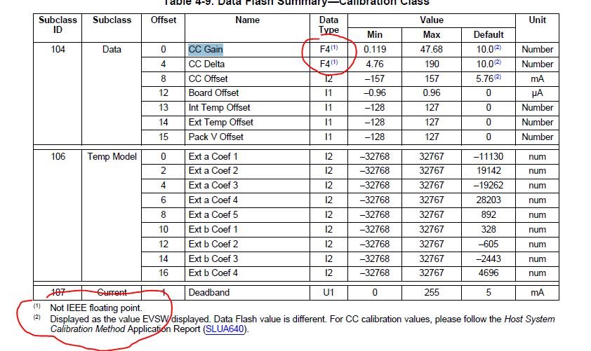

1. What is the floating point format used for CC Gain and CC Delta?  It doesn’t appear to be IEEE 754 or the byte order is mangled.
I am getting very large values that are out of range.  Here is debug showing 32 byte read of calib data and subsequent decoding.
Double checked CC Gain = 0x7f71205c hex to floating point conversion and it shows same large value.
http://www.h-schmidt.net/FloatConverter/IEEE754.html

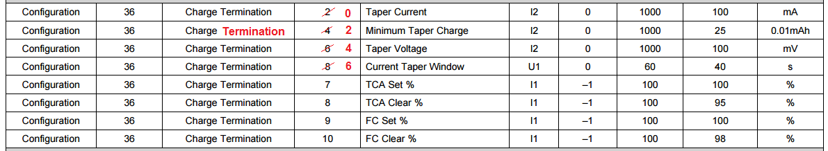

2.  Datasheet page 17 has incorrect offsets values for Configuration Charge Termination.   Here are correct offsets:
cid:image012.png@01D19008.FE3B43D0
