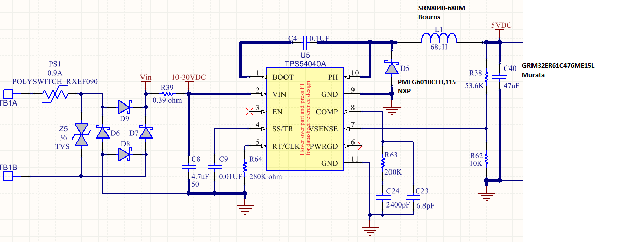

I need some help right away.  We are using your TPS54040A in a design with a rechargeable battery.  It works great unless the battery is low and needs charging.  Then we sometimes have a startup issue where it locks up around 1.5V.  When the battery needs charging the in-rush is close to 1A so I understand why it hangs up.  We dropped in the TPS54160 expecting the problem to go away.  It comes up all the time even with an added 250mA load so it solves that problem but now the output has a 1V ripple on it where the older design had 50mV.  I have used the switcher pro designer and adjusted my values but I can’t get rid of the ripple.
Attached is the 5404 design
My requirements
Vin Min = 7V at the chip
Vin Max = 34V at the chip
Iout Max = 0.750A
Iout Min = 0.050A
Thanks.

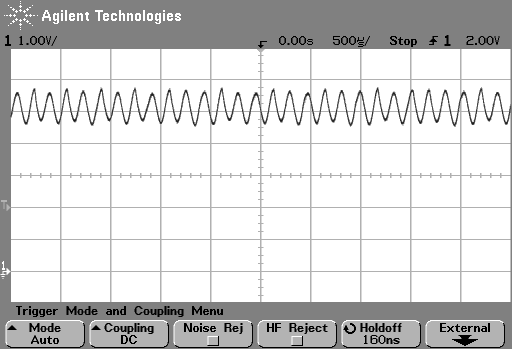

  • Can you post the conditions where you see 1 V ripple? Waveforms would be helpful. Please show Vout, PH, Vin and COMP.
  • It is much worse when charging the batery at 0.5A load, otherwise the ripple is about 0.4V at 50mA load.
    Captures were taken at 12V in and 0.55A load.

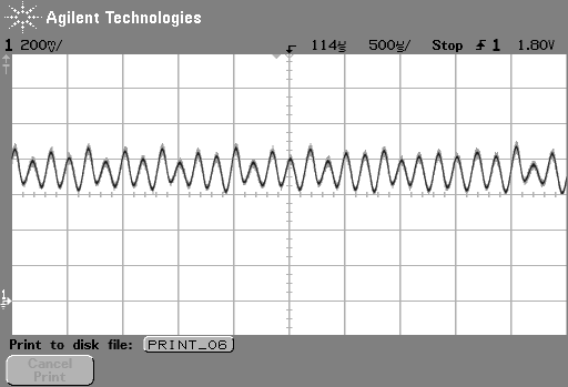

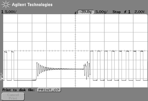

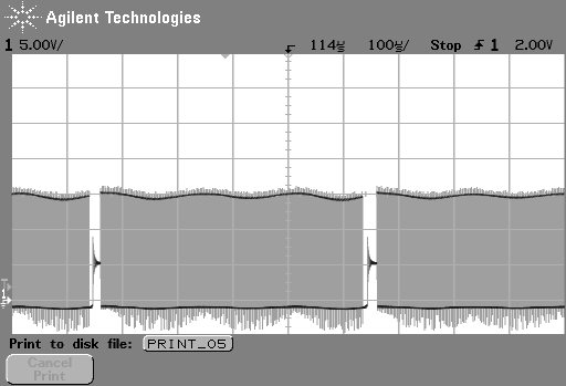

    Vin, Vout, COMP, PH, PH Expanded
  • Looks like your ripple is very low frequency, not at the switching frequency. It seems you have rather a lot of ripple on the input as well (and the output ripple may be tracking the input ripple). I would try shorting R39. Maybe add 100 uF electrolytic in parallel with C8. It may also be your load current is fluctuating. Can you try measuring the ripple into a purely resistive load? Can you try using a DC power supply as the input directly across C8?

  • In the last two screen shots, you can see that the current is dropping to zero. Is it possible to measure the inductor current directly? Do you have access to a current probe?
  • No I don’t have a current probe for something like that so I don’t have a convenient way to measure that.  What could cause the noise to be 1V on a 5V output?  Could the compensation network be that critical or is it more likely the inductor.  Should I use a smaller inductor if it appears the current is droping to 0?  I have never had this much trouble with any regulator I have worked with in the last 15 years.  Seems like I am missing something basic for this type of problem.  If I was trying to get the ripple down from 150mV to 50mV I could understand tweaking the compensation  network and some other things, but that isnt where I'm at.
  • its often difficult to troubleshoot this type of issue over a forum. It looks to me like the output voltage ripple is tracking the input voltage ripple. The ripple frequency appears to be about 6 kHz. That is right in the range of possible crossover frequencies. The p-p inductor ripple current during normal DCM operation is about 114 mV. The time for the current to drop to zero after the last on time is about 7.5 usec. That implies the current was at about 1.72 A peak when the high side shut off. It seems just below current limit, so maybe you are reaching current limit. In any case, your load current is definitely varying. You could also be unstable. It would great help if we could see the actual inductor current. Alternately, can I see COMP and SW node on the same scope shot? Both 100 usec/div and 5 usec / div. Also can you post your final schematic with TPS54160?
    Who do you normally work with at TI? Do you have an FAE you typically work with?
