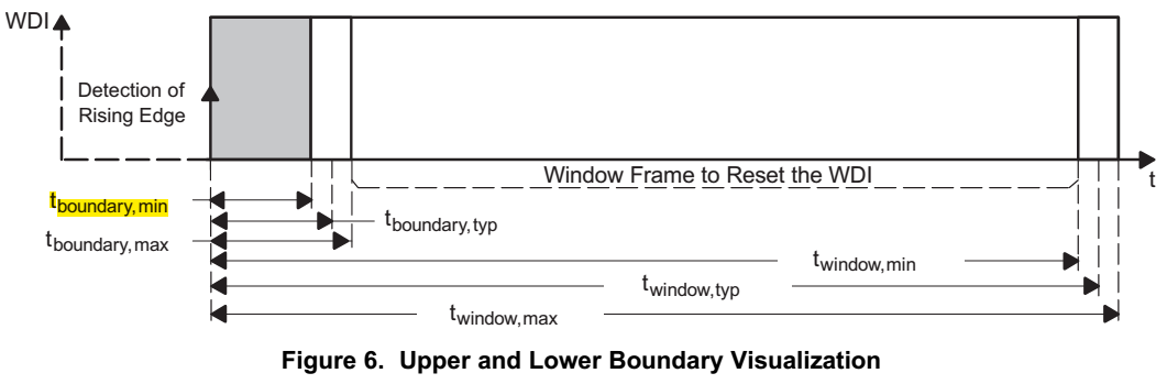

Hi Sir,
Please help us confirm some question about TPS3813 function, thanks.
1. tboundary mean is low to high signal?

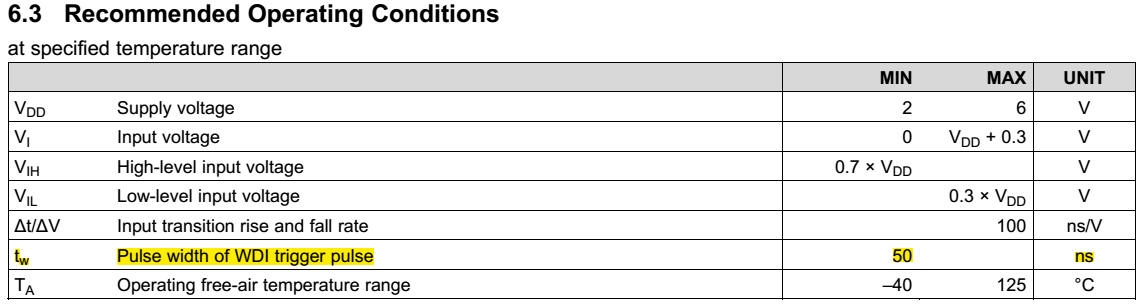

2. Confirm set GPIO is how long to sent a signal low to high for WDI PIN, it will be not reset.
3. The low to high signal pulse width request min 50ns?

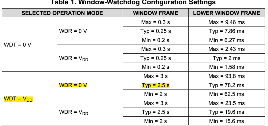

For example, In the condition WTD = VDD, WDR = 0V
If after 2 sec, WDI no recive low to high signal, it will be reset?
