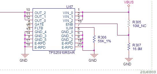

Hi Sir,
I used the TPS25910, shch as the below schematic.
R305 is NC, and ENB has the pull down resistor R307 16.8M.ohm
I found if I used the 16.8M ohm, the ENB Voltage would be around 2.5 to 3V. and the TPS25910 would be disable.  (100K neither)
But If I use the 10K ohm to gnd, or let it connected to gnd directly. The function will be normal.
could you help to clarify this issue ?
thanks
