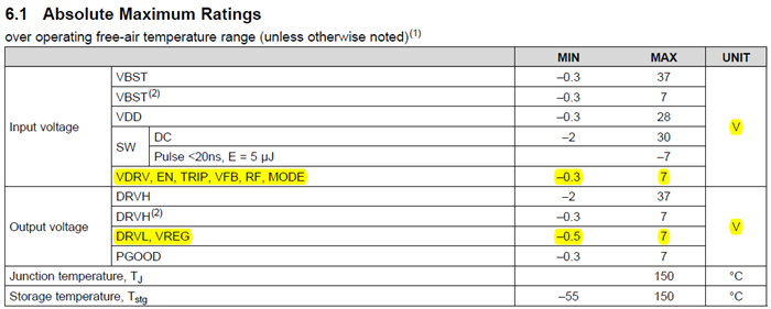

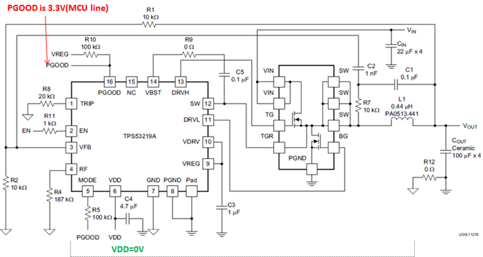

Hi Team,
Our customer are evaluating TPS53219A.
3.3V is applied to MODE, VDRV, VREG pin at VDD=0V.
I understand that those pins doesn't have any problem.

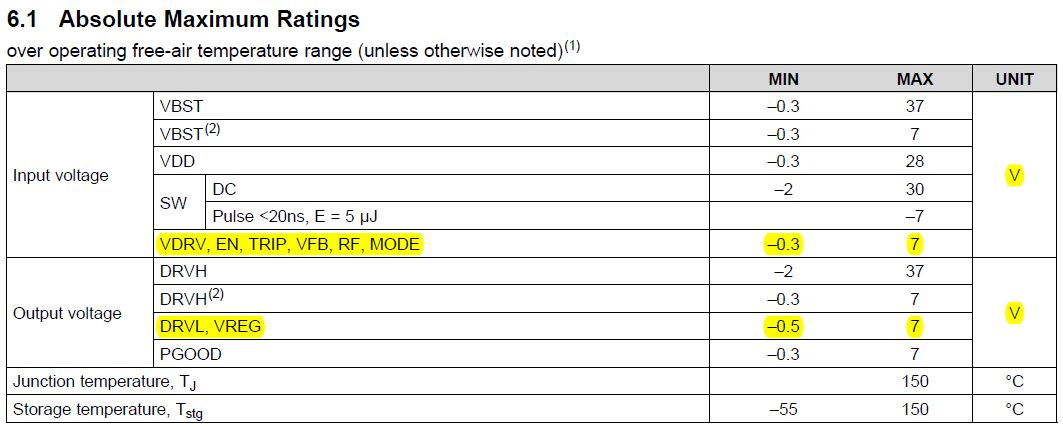

Because, absolute maximum of those pins is the following contents.
Could you please let us know if you have any concern?
