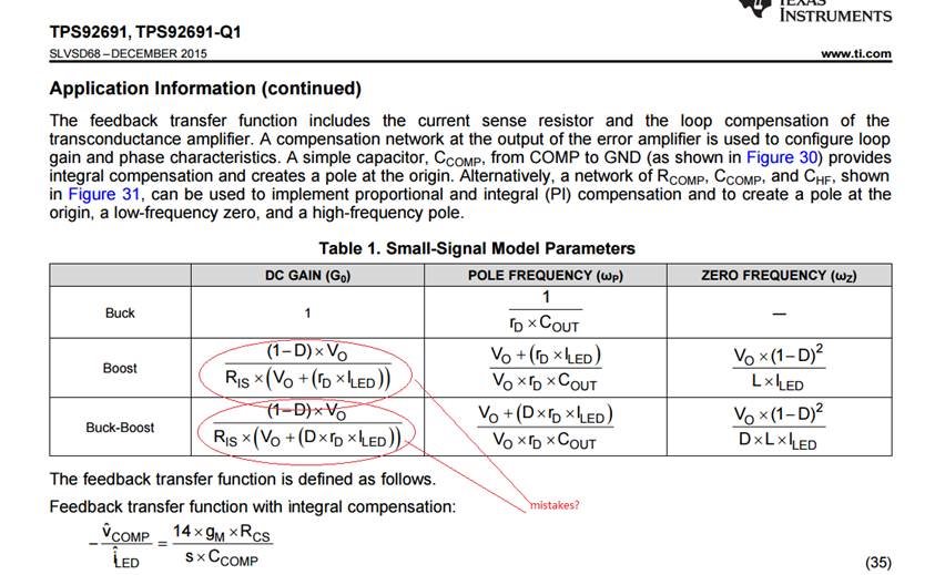

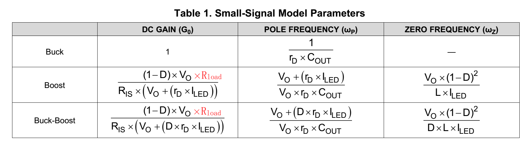

Our customer is evaluating TPS92691 for LED lighting projects. They have some questions about the small signal mode parameters calculation. Shown as below:
Could you kindly check this and express the calculation process in detail, please?
I am also eager to learn about this. It's urgent, thank you!
