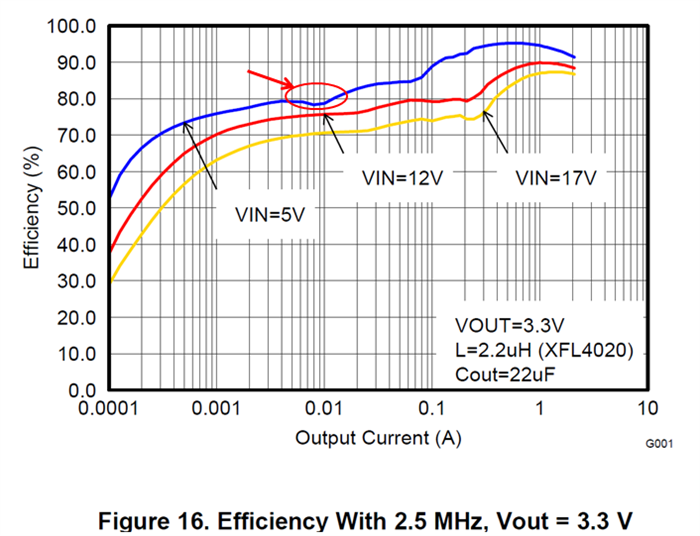

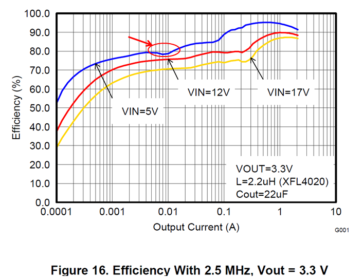

Hi Team,

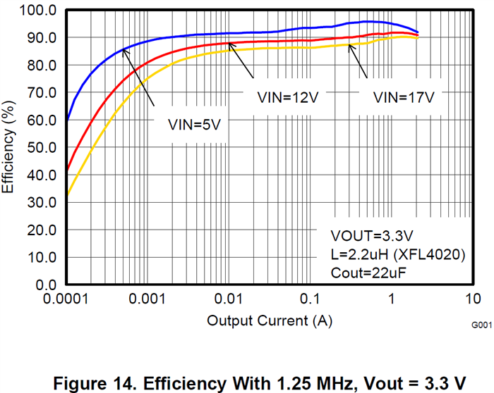

We would like to know about efficiency curve (Figure14 and Figure16 of datasheet).
What is the cause that efficiency falls to with the following points?
On the other hand, we can’t confirm this phenomenon in Figure14.
So, is this phenomenon affected by the switching frequency?
And, I have one more question.
Could you please let us know your efficiency measurement method?
Kanemaru
  • Efficiency is measured as it always is (and as is always has to be): (Vout * Iout) / (Vin * Iin).
    Does your application operate at that operating point (5Vin, 10 mA load)? There are better devices to use.
    If efficiency is important, then use the lower frequency selection. This gives much better efficiency,
    In light loads like this, we are in power save mode. There can be some jitter of the switching pulses at some points so that it makes it harder to correctly average out the input current to compute efficiency. Operation at this point looked perfectly fine.

  • Thank you for posting your real question. Please don't ask theoretical questions like your first post when you have a real issue.
    Yes, your DCR is almost 10x higher than the inductor used in the D/S. This makes lower efficiency. As well, you can use the 1.25 MHz setting and get higher efficiency.
    This is a good device for your Vin and Iout needs. We also have the new TPS82130 module if a much smaller size is desired.
