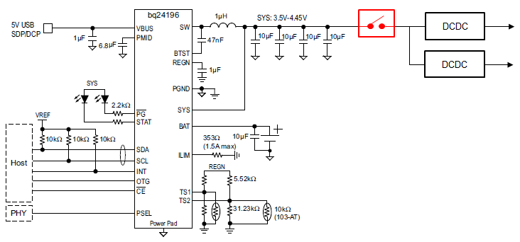

Hi Team,
My customer wants to set SYS output to high-impedance.
I believe it is possible to set the following.
Is my understanding correct?
- High-Z mode (REG00[7]=1)
- BATFET disable (REG07[5]=1)
If it is impossible, he considers to put a load switch as the following.
