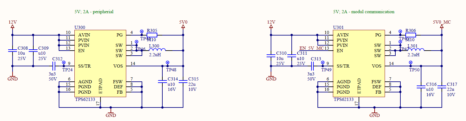

  • On the board there are 2 instances of the TPS62133-based DC/DC converters: U300 and U301 (see schematic). U300 never failed so far, but it is also loaded a little less (about 0.5 A) and the layout is minimally different.

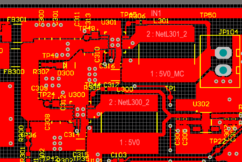

Current schematic and layout
-          Note: U301 failed sporadically (U300 is just shown for sake of completeness, e.g. with respect to thermal considerations or similar)
Top layer and top overlay
Bottom layer and top overlay

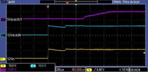

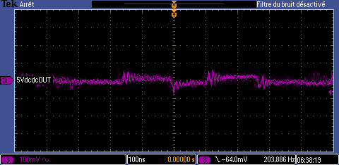

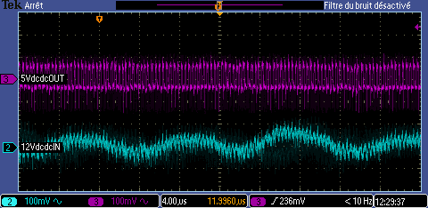

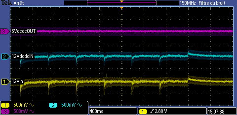

Measurements of input-/output-voltages
-          Switching 12V input “on”:
-       5VdcdcOUT corresponds to 5V0_MC
-       5V0_MC is loaded with about 1A by a LCD/backlight module.
-          System in “standby”:

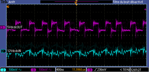

-          System during “normal usage cycle” ”:
-       Note: The “spikes” on the 12V input are due to load transients (~2A) on the second TPS62133 regulator generating the “5V0”.
-        System in “standby” – measured on a modified pcba:
-       For this measurement a second 22uF capacitor was soldered on parallel to C317.

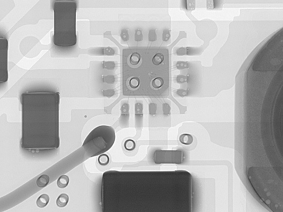

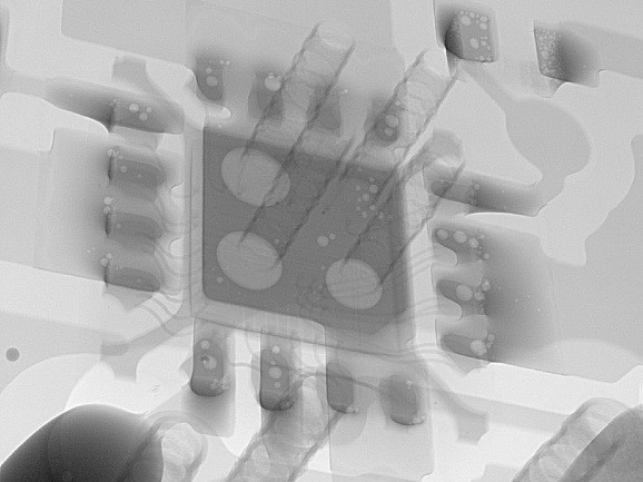

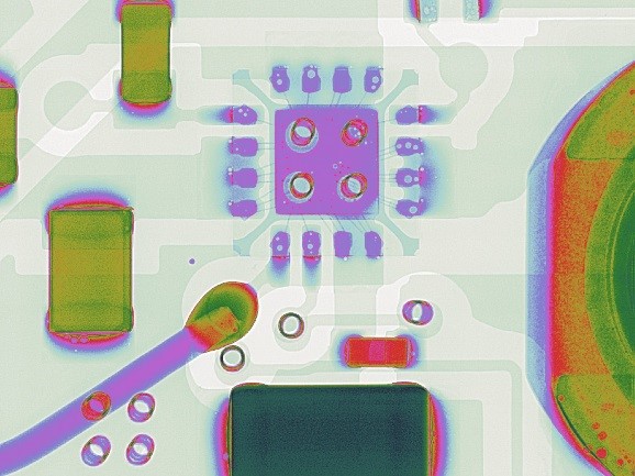

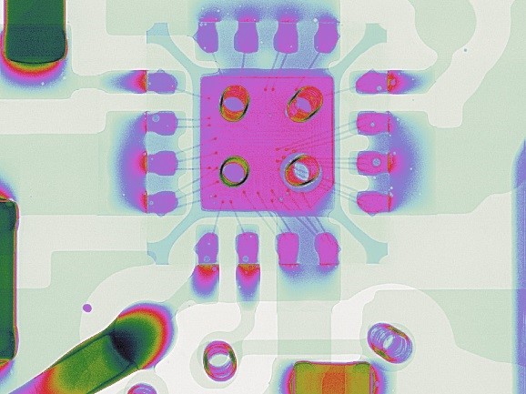

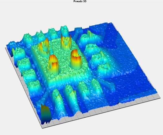

X-Ray analysis
-          Initial comments
  • So far only 1 boards/U301 were x-rayed.
  • 1 of these boards had “failed” before x-raying
  • 1 of these boards had worked for several weeks (without failure) before x-raying.
  • It seems that there was no significant difference and the wetting/soldering of the thermal pad seems ok.
  • X-rays of approximately 30 more boards will be added soon.
-          X-rays of a “failed” board
-          X-rays of a “good/working” board

    • Only 4 vias are used.
    • These 4 vias are “plugged” and seem “hollow” (see x rays)

-          Production problem / bad thermal contact on some boards
  • Seems to not be the cause, because
    • The first 2 x-rays showed no significant difference and looked “good”
  • Anyway it may be a problem because
    • Only 2 boards were x-rayed so far

    • The “pulses” on the 5V0_MC output (~100mV) seem a bit too big and are drastically reduced by placing an additional 22uF capacitor
      • Note: as 22uF ouput capacitor (C317) “Murata GRM31CR61A226KE19L” are used.
      • The datasheet of TPS62133 (SLVSAG7C –NOVEMBER 2011–REVISED JANUARY 2015) indicates in Figure 26, that the “output ripple” should be below 20mV.
        • It is though not totally clear what “output ripple” means in this context as e.g. Figure 32 indicates that the “noise” on the Vout is about 100mV (peak to peak).

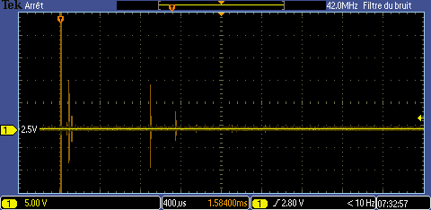

    How did we determine that no spikes were present on Vin?
    - We bulilt up the system "as normal"
    - We soldered on a few wires (about 3cm) to both pads of C310.
    - We then connected an oscilloscope probes to these wires
    - Then we typically first "looked" at the oscilloscope during various situations e.g. During standby, turn 12V on/off or in use when some motors etc turn on/off.
    - Then we set the trigger to a reasonable voltage (typically slightly above 12V) and "recorded" the Vin in the situation to analyze ("single run" style).
    - The above was repeated at various oscilloscope settings (time / voltage resolution, ac/dc coupling, filter on/off etc..)
    - Generally we repeated the "switching on/off" also 10 times or more, to have at least a chance to "see" spikes that maybe only come once in a while.
    Doing this, we never saw a spike exceeding about 17VDC on the 12V input. The "worst" spikes we saw happened when "turning on 12V by plugging in the 220VAc/12Vdc power supply into 220V mains outlet" (see image below)
    Schematic of 12V input path (from connector to "on-board-12V"):
    Spike on 12V /Vin when plugging in Ac/Dc converter (here only about 10V but can go up to about 17V. Note: the level seems to depend a lot on the oscilloscope probe/cable "orientation" -> probably mainly a measurement error/induction effect)

    If I understand correctly, you have a motor and some power LEDs on the output of the failing rail, but do not have these on the 'good' rail? Do these loads plug into JP104?
    It is probably worth to zoom in on the spike you show above. It is likely just noise coupling into the probe, as you thought, but it's difficult to tell at 100 msec/div.
    Besides some possible noise on the output and input, my main concern is on the input cap. There is a small but possibly significant layout difference in the GND connection from the input cap to the PGND pins. This connection is longer due to that EN via which is in the way. This adds extra inductance which creates higher voltage stresses on the device.

    - Zoom of the spike on the 12V input: well we only have a "bit" of a zoom (not helping a lot) - we could not reproduce the spike anymore at a higher time-resolution setting unfortunately. As the failure does not occur during swiching on (but during standby several days after switching on): how do you think this spike could be related to the failures? Stress which causes failures at a later time?
    - Regarding the inductance/layout difference: Well but we talk about a few millimeters. Do you really think that could be a (part of) the problem? How would you recommend to layout if the EN signal is used?

    It sounds like the Vin spike does not correlate to when you have seen the failures, so it can be ruled out.
    The EN via should be kept closer to the IC so that the GND plane can pour it around it better and make a shorter path.

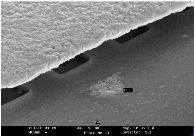

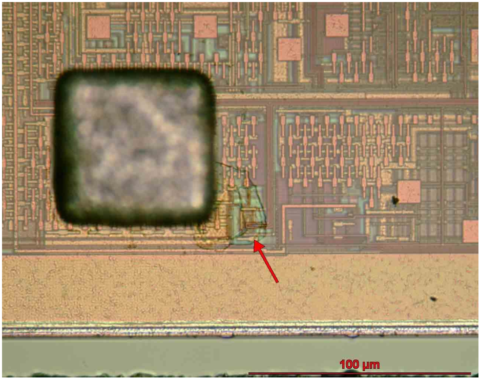

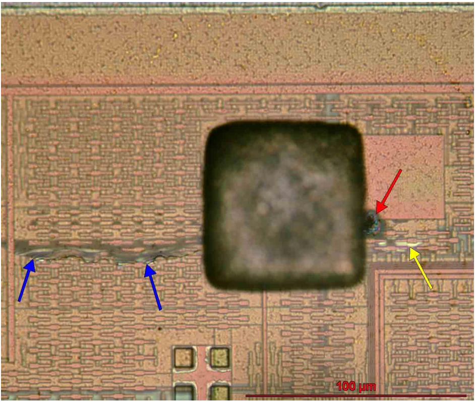

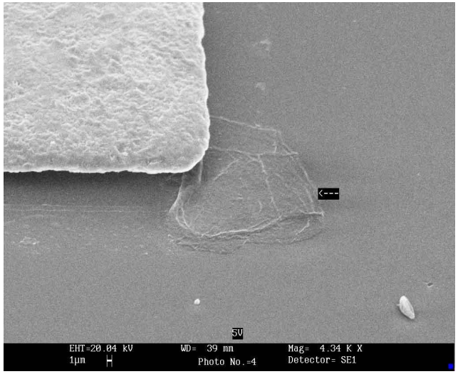

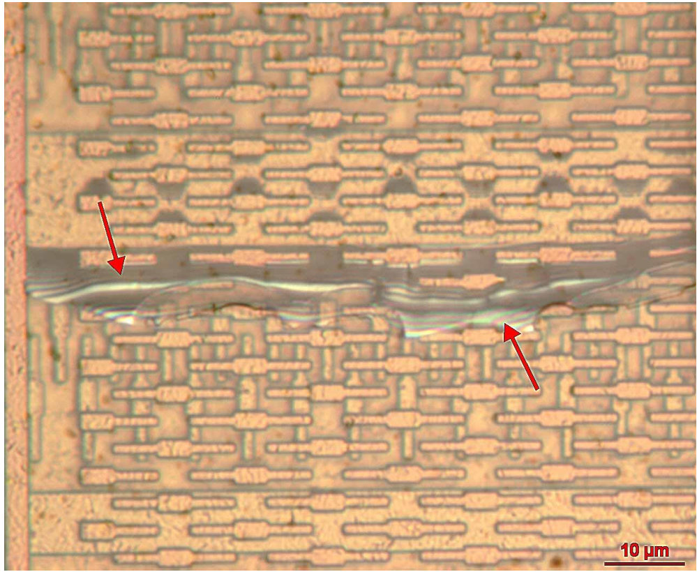

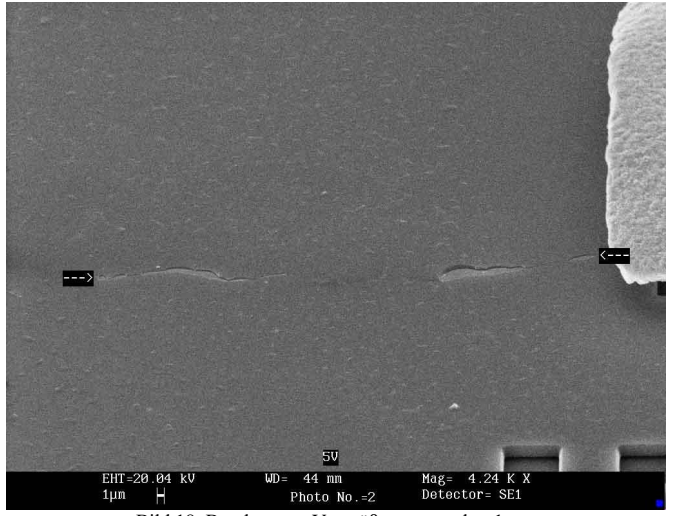

  • In case others are interested in this topic I will try to summarize the "results" below.
    - Modifications of the capacitors and (minimal) layout modifications did not significantly change the behaviour/failure rate.
    - An external analysis showed, that some "micro-cracks" appeared in the TPS62133 (see below). If they are the cause, part of or a result of the problem remains unknown and  also why they appeared on this IC (but not on the other one on the same board).
    - Long story short: we solved the issue by replacing the TPS62133 with another dc/dc converter. It is from another brand, has a SOIC case and operates at lower frequencies.
    Best regards and thanks to TI for the support.
    And last but not least a better picture of the soldering
  • Somehow the pictures did not work in the last post
    Some pictures of the micro cracks:
    And finally FYI a better picture of the soldering
    I have a very similar problem in my project with TPS62133: it fail without apparent motives.
    Could you try to post the images with the micro crack?
    Fabio
  • Hi Fabio
    I'll try. Anyway I wish you good luck with finding and/or solving your problems.
    Best Regards
    Diego
  • I thank you for publishing the images of the micro crack and compliment for your detailed analysis: very interesting the DIE analysis.
    Did TI company ever admit any problem with this device?
    Does the AUTOMOTIVE version have the same problems?
    At this point, since I don't understand the cause of the failure, I think I will revisit my project by replacing it with another DC/DC.
    Thank you again for your analysis,
    Fabio
  • Hi Fabio,
    As evidenced by this thread, the root cause of the previous failures was never reached. I can say that we do not ship these ICs with cracks in them.
