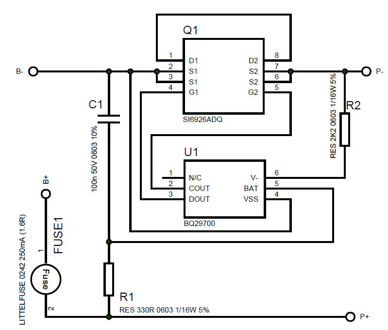

  • Alessandro,
    You are correct in expecting the system to recover when you remove the short and V- returns to 2.54V, but the specification for VSSCR is TYPICAL 1V, meaning there is going to be some distribution around 1V.
    Are you using the 2.2k resistor or a different value? The current source that is connected between V- and VSS may be losing headroom and not continuing to pull charge off the V- pin to continue dropping the voltage.
    As Charles states, connecting the charger is normal operation.
    I'll look into available information on the distribution of VSSCR. Just for completeness, have your tried running this test with a higher battery voltage?
    Todd

  • Thanks for your reply Todd.
    Here follows the schematic:
    SI6926 is Dual N-Channel Mosfet.
    The fuse has a cold resistance of 1.6R
    I thought the fuse could be the problem so I've repeated the test with and without the fuse and the problem happens either way.
    I also did what you suggested. I tested with a fully charged battery (4.06V - It'll not charge more than this because of the fuse cold resistance).
    The voltage between VSS and VBAT was 4.05V and the voltage between V- and VSS was 3.26V.
    I've tried putting some load on P+/P- but the V- voltage is always 3.26V.
    I've tried with 9R, 18R, 1K and 10K.
    I've waited about 1hour and the voltage was still 3.26V.
    I don't have a battery with a higher voltage, but I can make a 8V battery using 2 cells if you think I should repeat the test.
    I'm also assuming that this test could not be done using a linear power supply because of the battery impedance.
    Please let me know if need any waveform from the scope.
  • Hi Alessandro,
    I believe you can try to use a resistor as the "battery" and play with the voltage this way to make sure you can play around with the voltage.
    can you confirm if when you remove the "load" the V- pin goes to Vss (BAT/2) potential?
