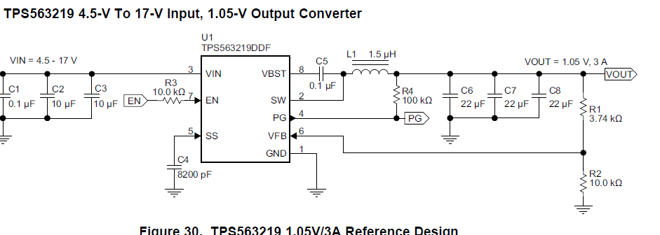

at TPS563219 datasheet,
do not recommand too high feedback resistor.
But in my application(STB), R1 = 10kohm, R2 = 32.57kohm for using CPU AVS power.
Vinput = 5v
Vout = 1v
Max current = 3.85A
is it possible for using feedback resistor value?
