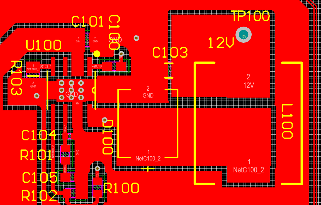

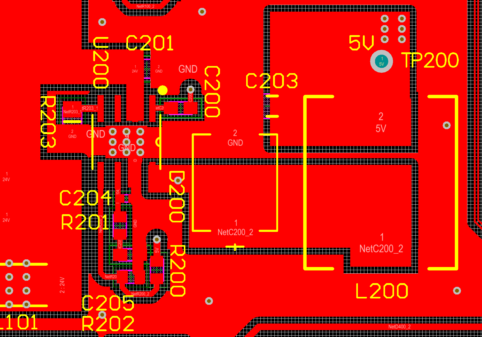

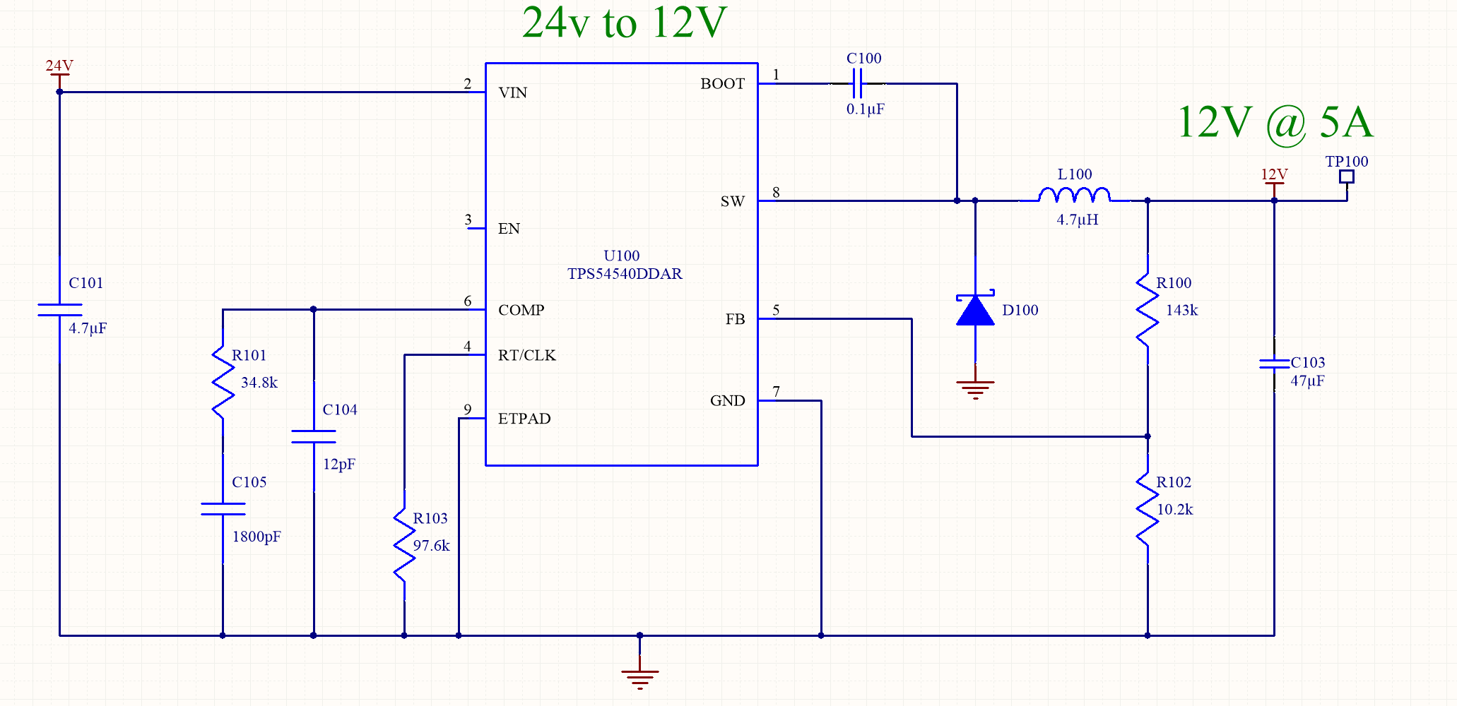

I recently brought in the TPS54540 to one of our boards. I am using 3 of them on 3 different power rails. The input for all of them is 24V.
Power Rail 1: 19V @ 810 MHz

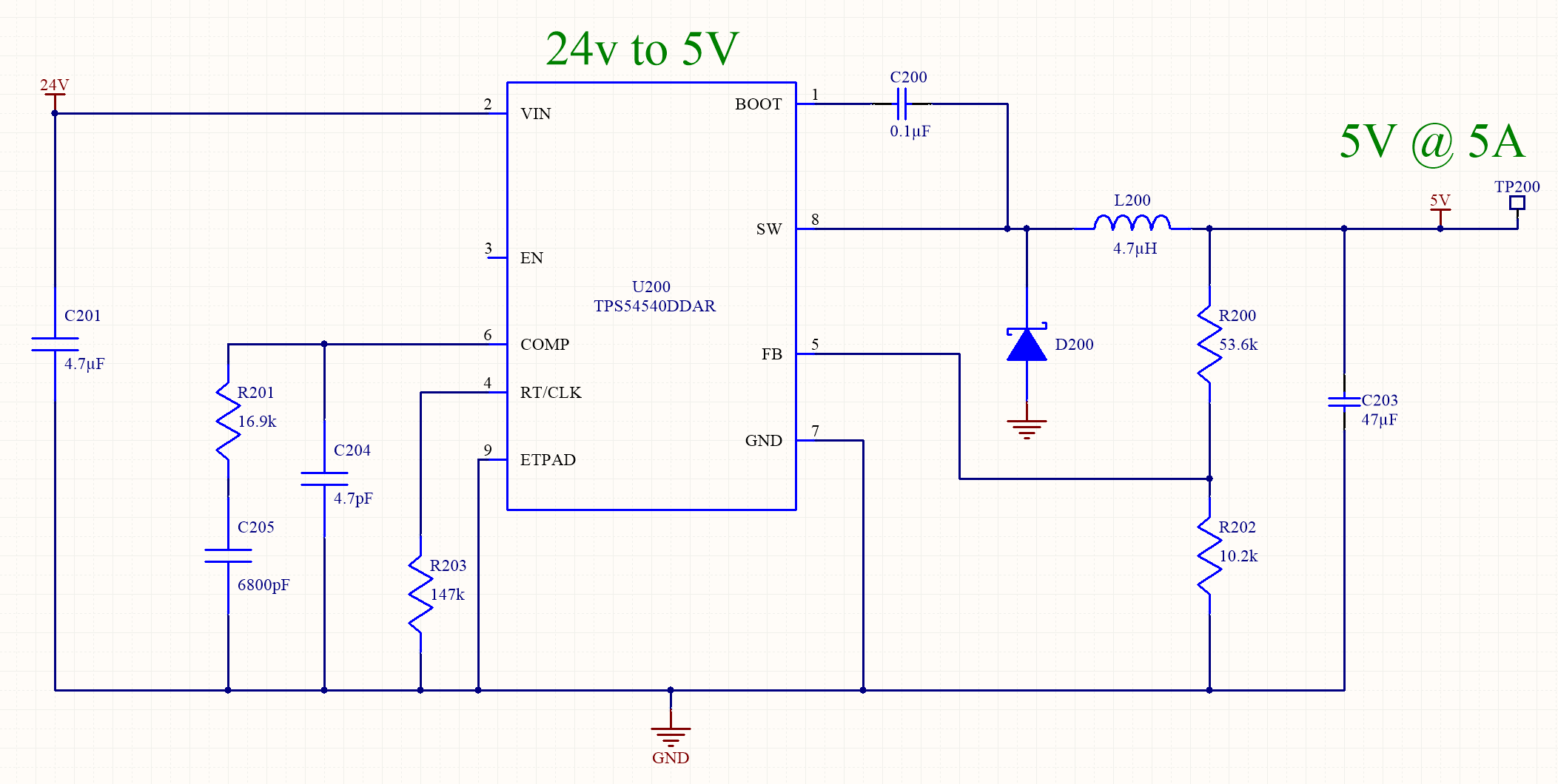

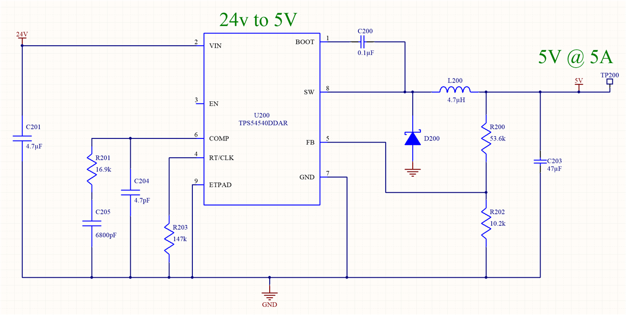

Power Rail 2: 12V, 1A @ 1MHz
Power Rail #3 5V, 5A @ 666KHz

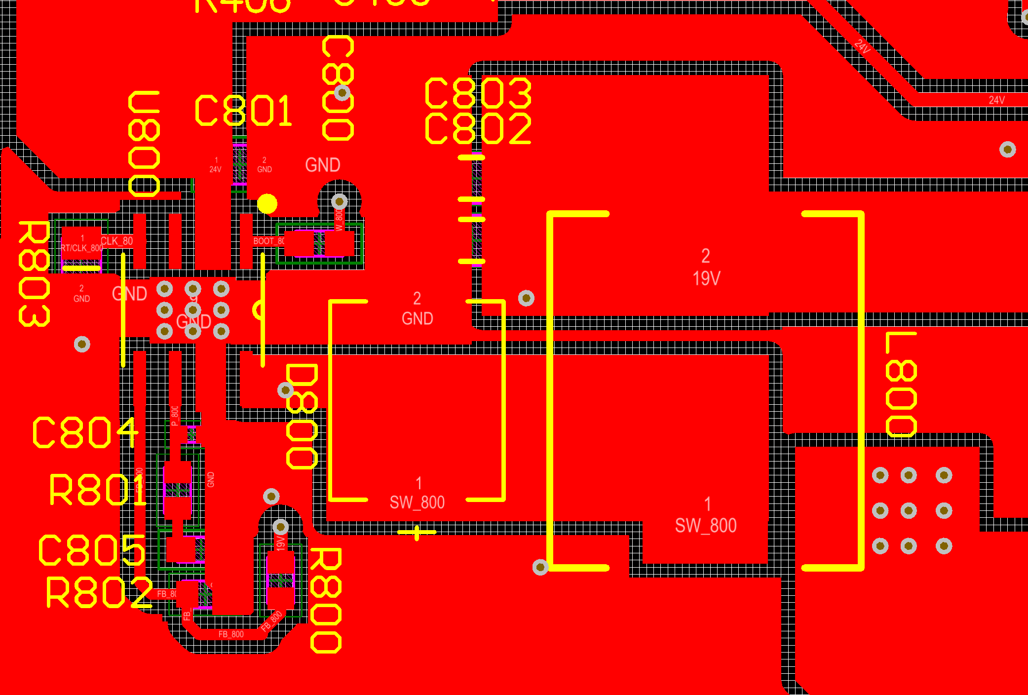

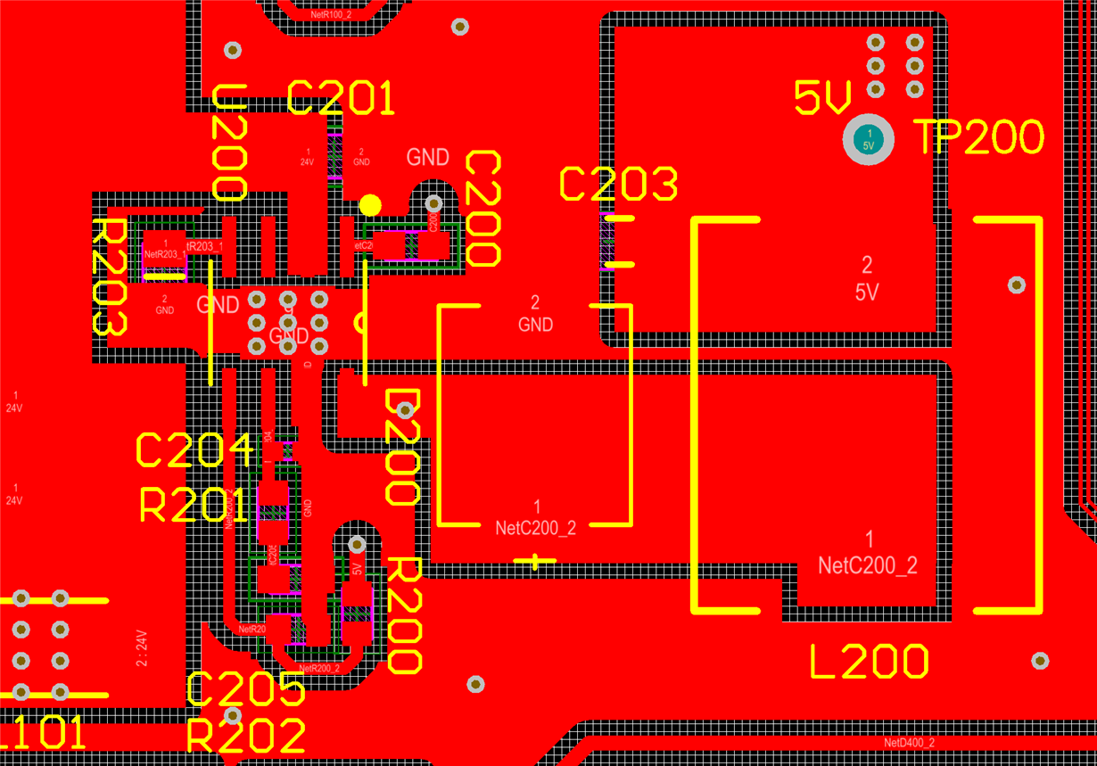

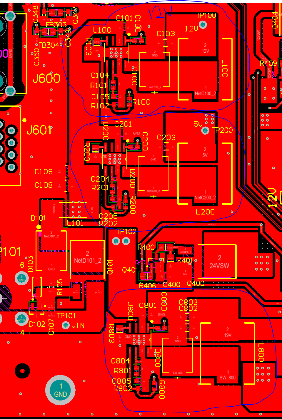

All the layouts are basic carbon copy of eachother, so if one is wrong, I am guessing they are all wrong.
I used TI's webtool to design the circuits and validate the temperature performance. And it seemed to be OK.

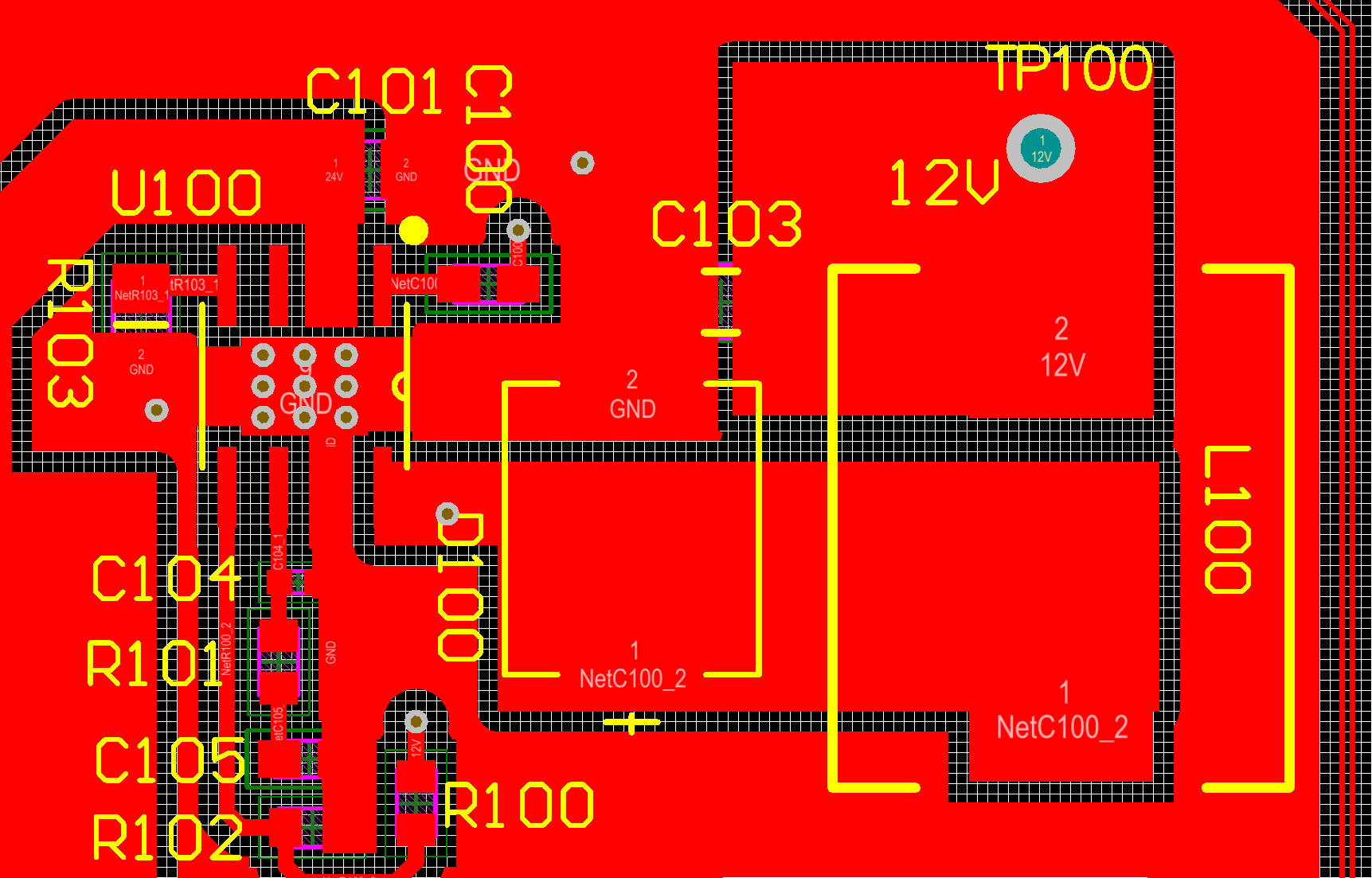

Lay 2 is full copper ground pour.
This is the location of all the DC/DC Converters
The Shottky is a B540C-13-F
Any help is appreciated.
  • The layouts seem reasonable to me. I see the inductors are all the same values. That is somewhat unusual. Can you send me your webench designs? You can share them inside webench to j-tucker(at)ti.com.

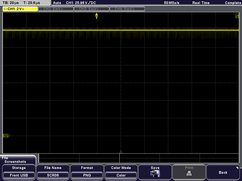

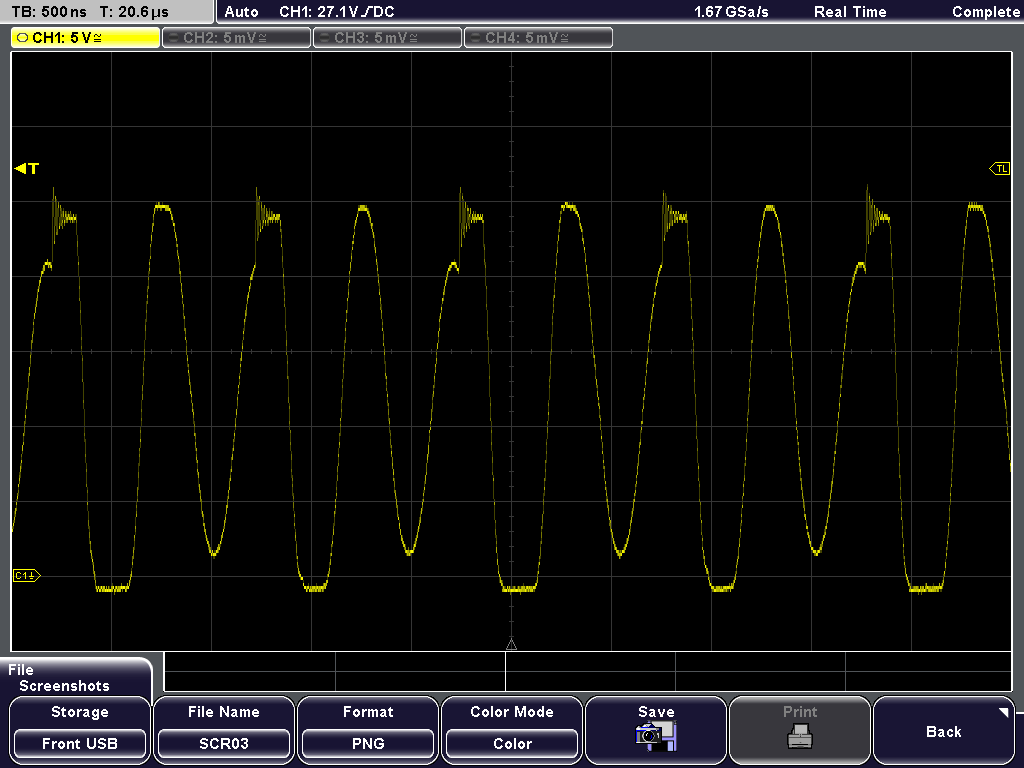

    For your 12 V output you claim it is not stable. can I see the SW node. Vout and COMP waveform?
    The other 2 rails you suspect thermal issues. That should be easy enough to verify. Are the ICs getting hot? Are the exposed pads well soldered to the PCB?

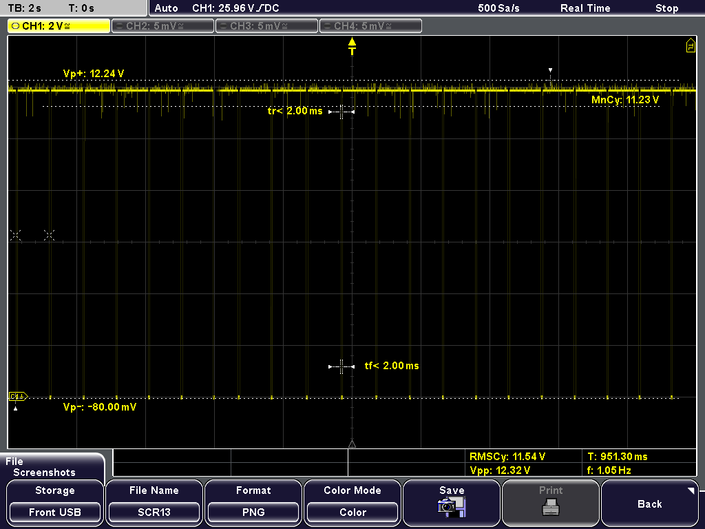

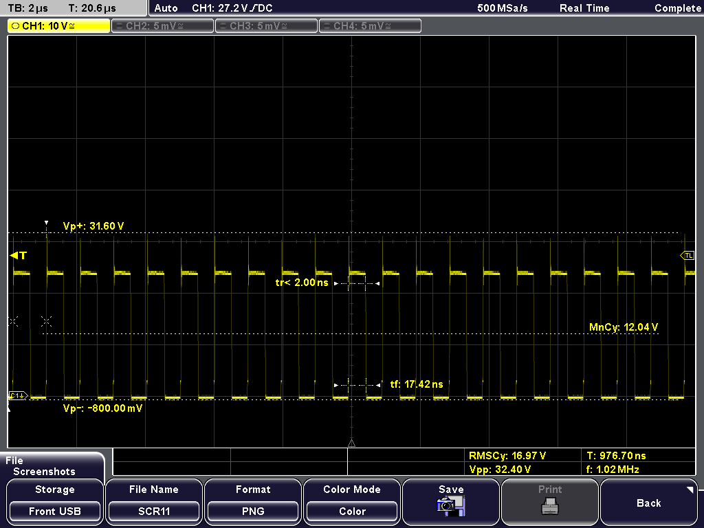

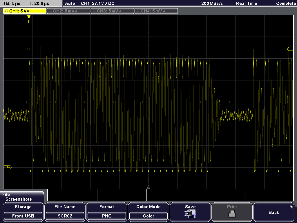

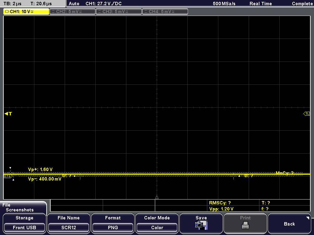

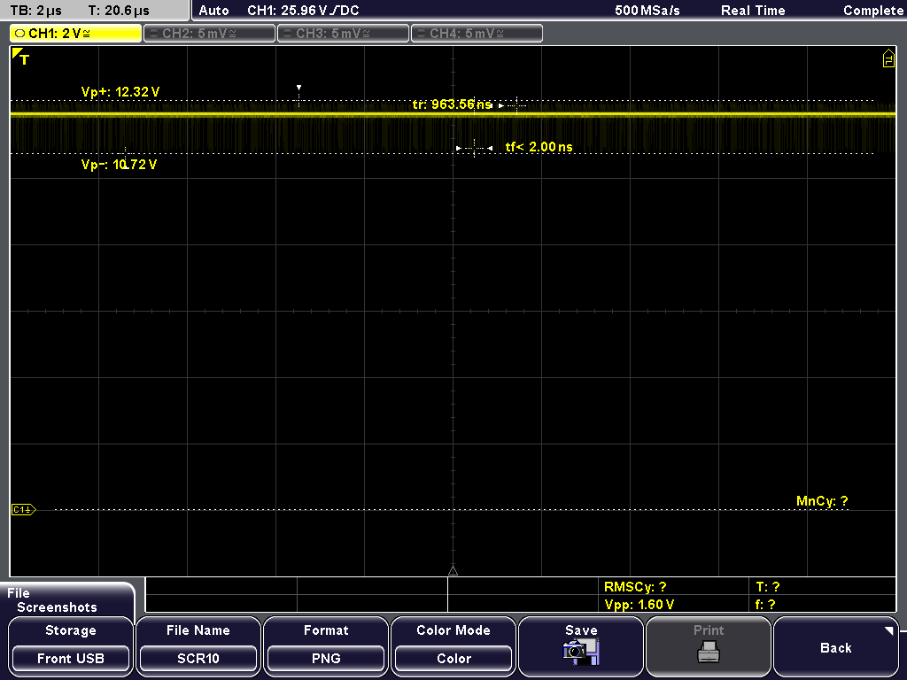

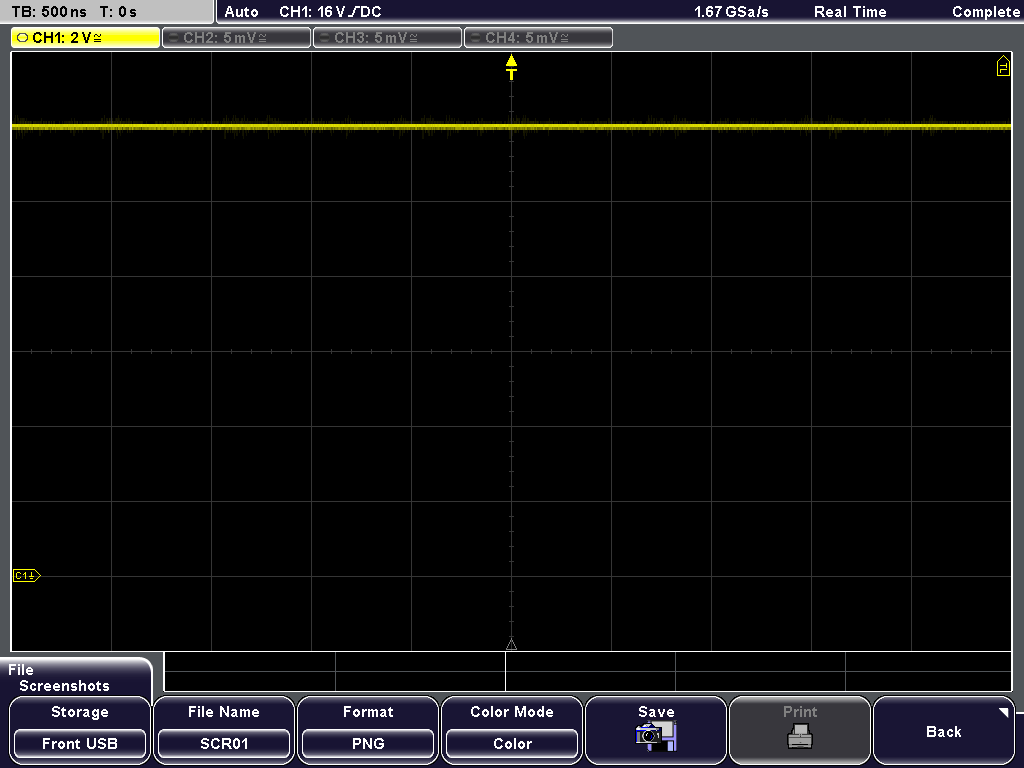

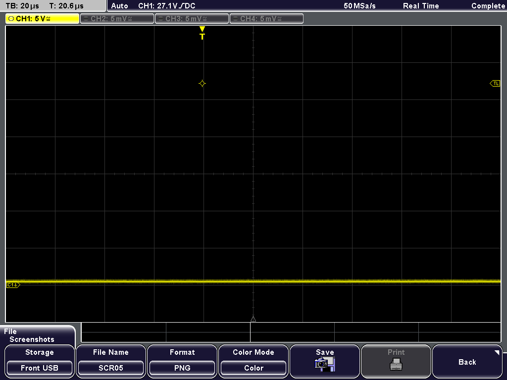

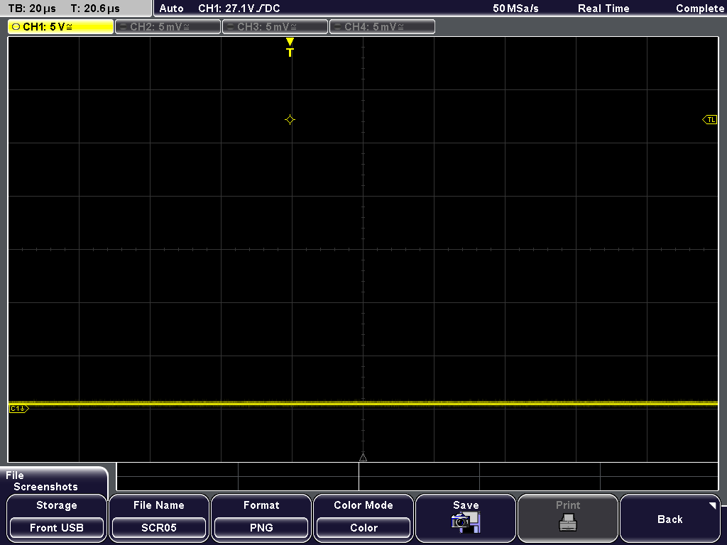

    See images:
    Vout (minimal load):
    SW (minimal load):
    COMP (minimal load):
    Vout (0.5A load):
    SW (0.5A load):
    COMP (0.5A load):
    Vout (1A Load):
    SW (1A load):
    COMP (1A Load):
    Vout becomes unstable after a couple of minutes of 1A load:

    The heat is being generated by the 5V rail (on the board with the depopulated 12V rail). The Shottky is getting very hot indeed, so is the TI controller. But I'm only testing at 1A load, when it is supposed to work up to 5A.
    Efficiency is the main problem here. I need 13W IN, to produce 5W out. There are a total of 8W being dissipated as heat on the 5V rail.
    Any ideas why the efficiency is so low?

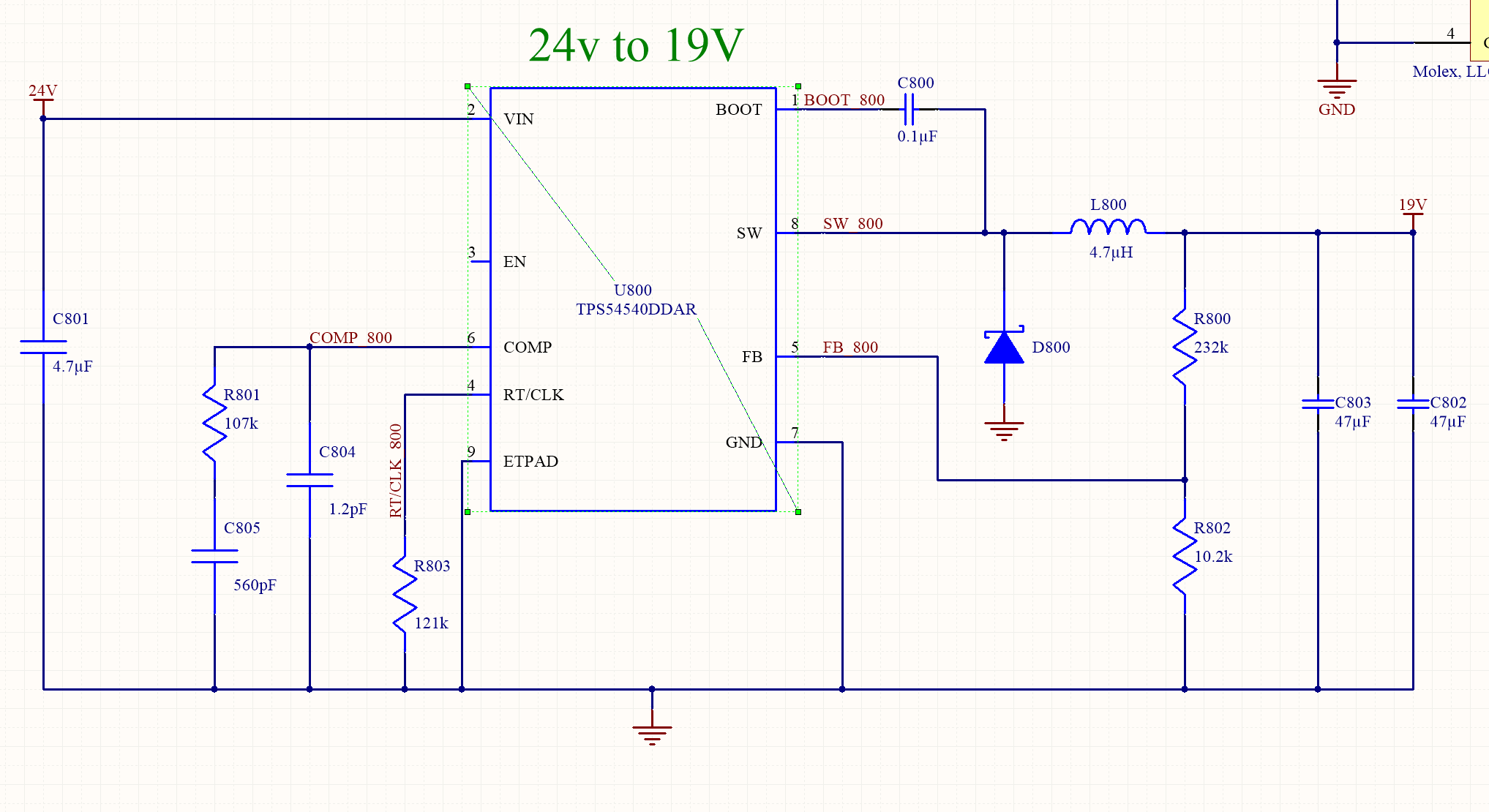

  • I found the source of the heat problem;
    The assembler made a mistake during the mounting. They mounted a TVS diode in place of the Shottky. Once I mounted the right shottky diode the DC/DC converters were operating at a reasonable efficienty.

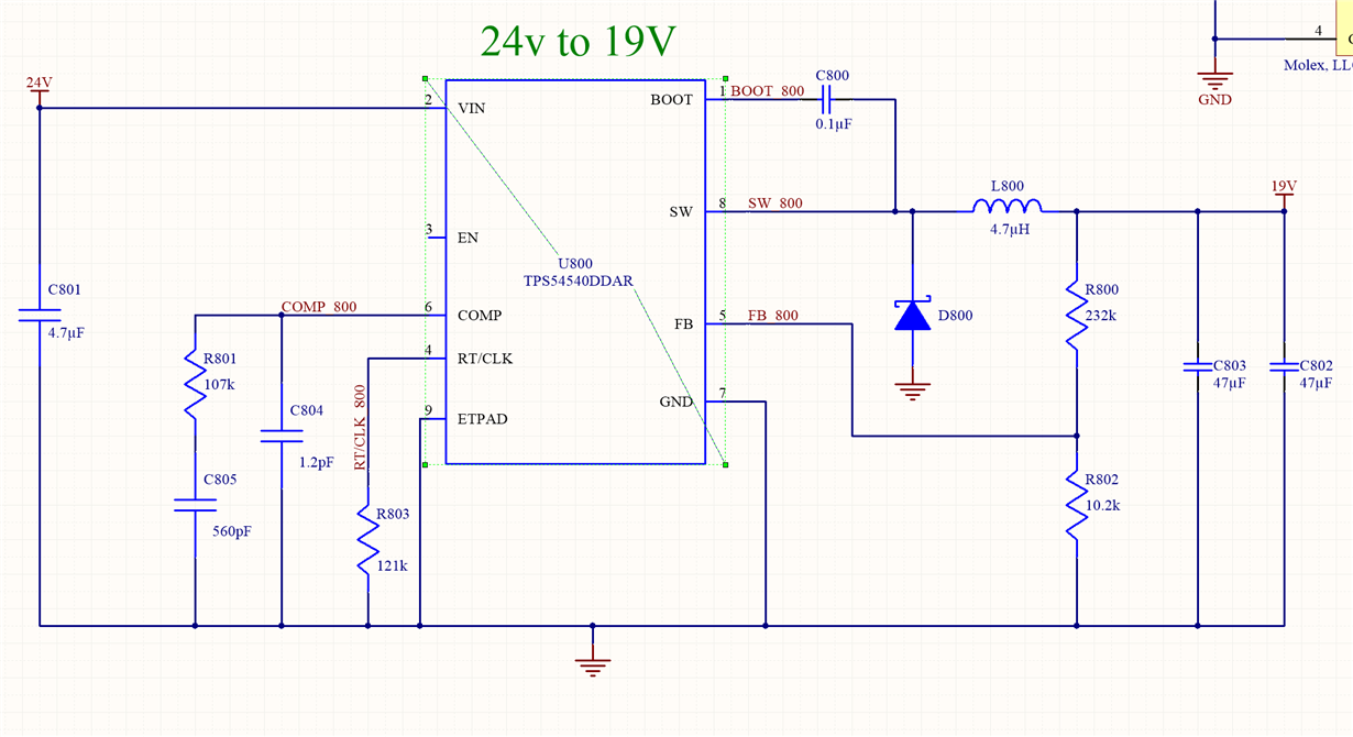

    The 19V rail has issues operating at the top end of it's load capacity (3A). I hear a noticeable "Switching" sound.
    Can you provide any advice on the tuning of the 19V rail?
  • You sent me the WB link for the 12 V and 5 V. Can you send the 19V as well?
  • I can't seem to get webench to land on the same values as I have at 810KHz.
  • Yes the webench design you sent is totally different from the schematic you posted previously. I can make a comment anyway. If you notice, the compensation values are noticeably different from the 5 V and 12 V designs. The Rcomp value is very high at 107k and the Czero and Cpole values are very low. I find that suspicious.
