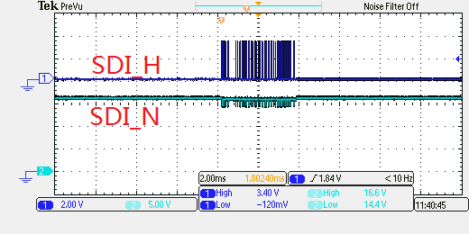

I used  4 cascaded BQ to monitor 20 cells.
I designed the board according the schematic diagram of the bq76pl536EVM-3 and the layout was almost as same as EVM-3.
The problem is my master chip can only communicate with the first BQ through the spi, the others do not respond to the address discovery and assignement algorithm.
In my design, the port FAULT_H,ALERT_H,DRDY_H and CONV_H were not used.And the CONV_H was connected to VSS.
Did I do something wrong?  Could you give me some suggest.

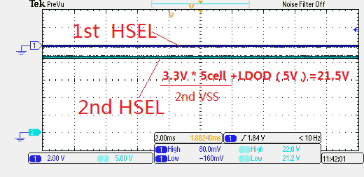

  • Hi Zihui,
    Please check HSEL pin. Go check out TIDA00821 design reference from TI product
    Make sure HSEL is connected to LDOD for slave ICs.

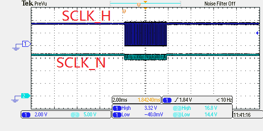

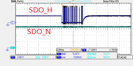

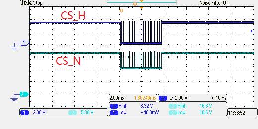

  • Hello Roger,
    I checked slave ICs HSEL pin and I'm sure they were respectively been connected to the LDOD pin. The following figure is the waveform of the 1st (host)and  2nd(slave) BQ HSEL pin.
    I measured the waveform of other pins for the 1st BQ, but I don't know whether these signals are normal or not. Could you please help me to analyze them?
    Thank you!
