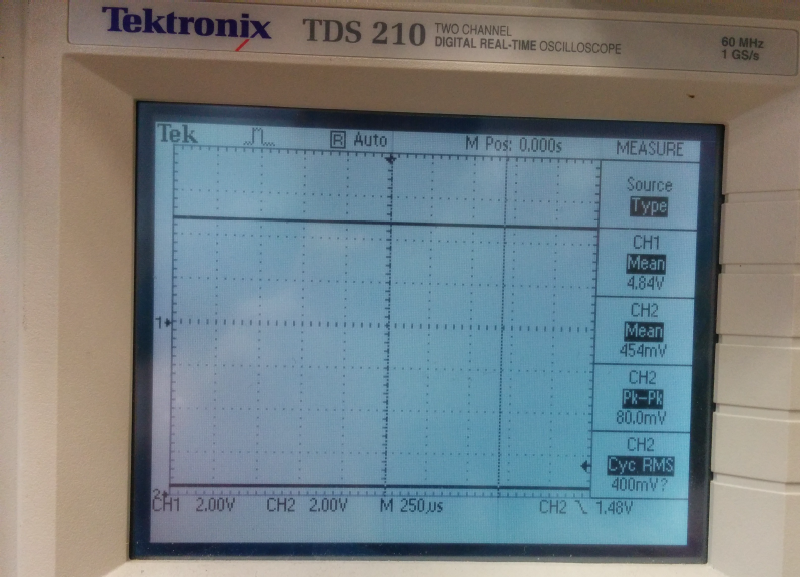

    2) Plug in battery for charging on cradle. (This capture shows the correct behaviour) \CHG signal go low to light the LED.

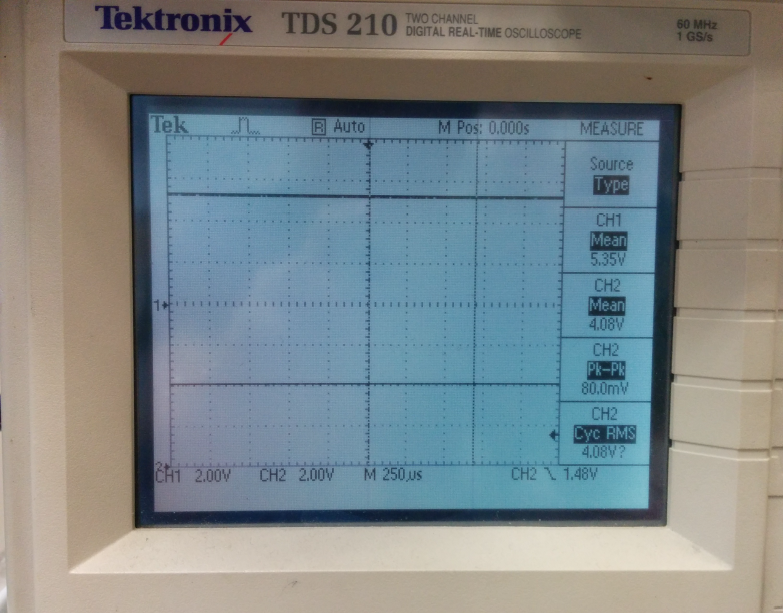

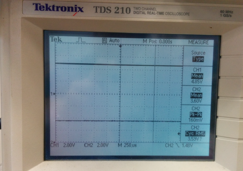

    3) Remove the battery and plug the battery again quickly. Sometimes, the \CHG signal will not go low enough to light the LED connecting to it. At the beginning, \CHG is 4.08V and it is only 3.6V when battery plugged in, while VIN signal doesn't change.

    4) The battery is charging, but the \CHG signal is not correct. Hence, the connected to this pin not lighting up.

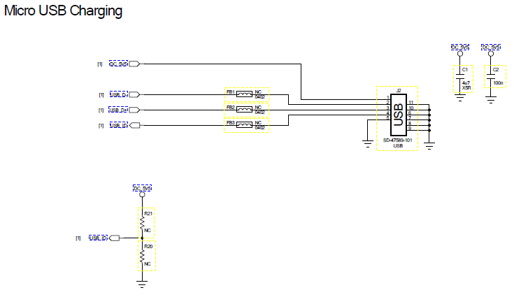

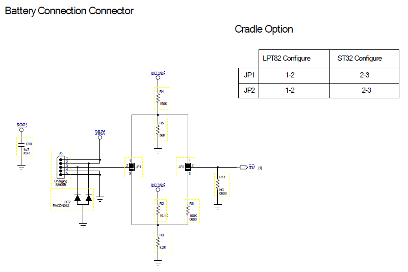

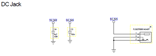

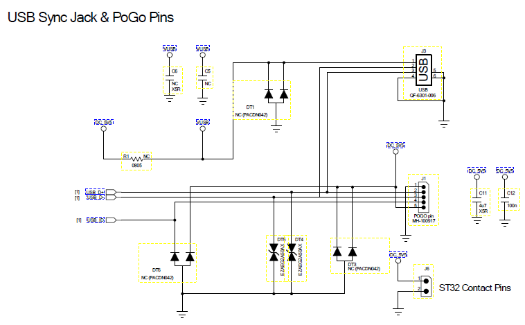

  • Can you share your schematic? Is the /CHG pulled to OUT or BAT? What is the value of the pull up resistance?
  • Please refer to below schematics. Thanks.
  • The /CHG is low only in the first charge cycle. Once the battery is removed, VBAT goes to VBAT(REG) and charge current is 0. Then Battery detection routine starts. VBAT is regulating at VBAT(REG) and pull down every 250ms.
    If you remove the battery and wait for a full battery detection cycle to run, then the IC starts a new charge cycle. /CHG goes low again.
    If you re-attach the battery before a full cycle of battery detection routine is run, then the IC thinks termination condition is met during battery removal and recharge condition is met when re-attached the battery which voltage is lower than VRCH. /CHG stays high Z.
