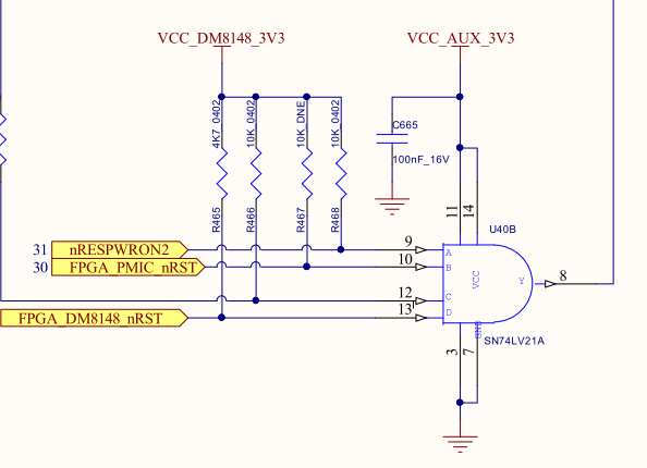

We have designed a DM8148 custom board with FPGA . DM8148 will be booted from the image stored in the NAND flash. After configuration of the FPGA it will issue a reset to the processor. DM8148 is powered from TPS6591133 PMIC which gives nRESPWRON2 once all the power rails from PMIC are stable. Attached POR scheme of the processor.
Concern:
We observed that while powering on/off the board or by re-configuring the FPGA , NAND image is getting corrupted i.e DM8148 processor is not booting from working image from the NAND instead booting from Golden image. We checked for power dip and it is fine. This issue is observed randomly in most of the boards.
We suspected the reset and did multiple experiments and concluded thet nRESPWRON2 is not holding reset of DM8148 for sufficient time which inturn causing inconsistency in booting.
Please let us know for how long TPS6591133 will hold the reset for DM8148 (Time). Is it possible to change or adjust the reset time of nRESPWRON2 signal?

  • Thanks Richard,
    VCC_DM8148_3V3 is a supply from a switch which is enabled from TPS6591133-PMIC to follow the recommended power on sequence for the DM8148 device.
    From datasheet what I understood is the reset hold time for nRESPWRON2 signal is 32ms. Please confirm the same. In that case this time duration is less for our application. Is there any options to increase the timing by writing some registers?
    Madhura
  • Hi Madhura,
    Yes it will be around 30ms, and outputs assigned to time slots cannot be altered, so there is no way to increase this delay through internal registers.
    If nRESPWRON needs to be extended beyond the assigned time slot, an external delay circuit would have to be implemented.
