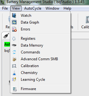

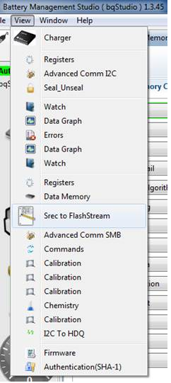

We have some problem. There is a need to convert the file srec to flashstream. We installed on different computers the same Battery Management Studio version, but on one computer there was such a possibility on the menu (as 4 paragraph "Calibration"!), and on the other two machines this possibility has not appeared.
With what it can be connected? Also, on all machines by changing on chip (BQ40Z60) the firmware from version 13 to version 15 (and vice versa), the program has crash.
We want to convert srec file to flashstream file for BQ40Z60 chip. We met a mention that it is possible for the BQ2741. Maybe for BQ40Z60 simply it does not have such an possibility? Or is there?
  • My mistake: not BQ2741. Correctly BQ27541
  • The FlashStream tool and df.fs and bq.fs file formats only support I2C interface devices. They are not current configured to support SMBus interface devices such as the bq40z60. Are you trying to develop tools to program devices in production? You also mentioned that bqStudio crashes after you change the firmware in the device. At what point does it crash?
