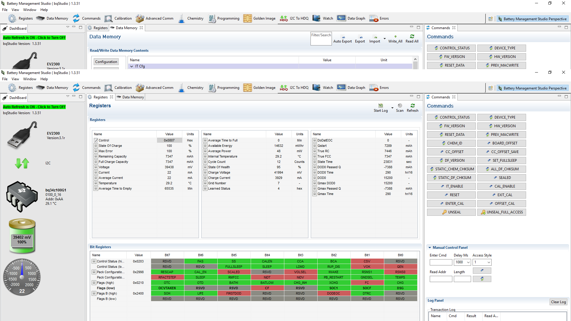

I am having trouble making the BQ34Z100-G1 to work. I followed the procedure for the optimization cycles I found online (forums, TI datasheets, etc) but the OCVTAKEN bit just won't toggle. I have tried charging from full discharge and let the battery pack rest for almost 24 hours but the OCVTAKEN did not toggle. I also tried doing the reverse, from full charge to full discharge using a discharge rate greater than C/10 and then let the pack rest for hours but still no change (OCVTAKEN bit still low). What am I doing wrong?
My setup:
Three(3) 12V 55Ah Lead Acid batteries connected in series - 36V nominal pack
Attaching GG file and image of battery studio. Thanks!

  • I reviewed you gg file and here are a few comments.
    • The Quit Current needs to be set lower than the CHG and DSG Current Thresholds.
    • The Max Qmax Change should be set to 100
    • The Max Res Scale should be set to 32000
    • The Min Res Scale should be set to 1
    • The Faslh Update OK  Cell Voltage should be set to 1000
    If you have a log file for the discharge, then I can review it and may find other concerns.
  • Thanks! It's working now.
