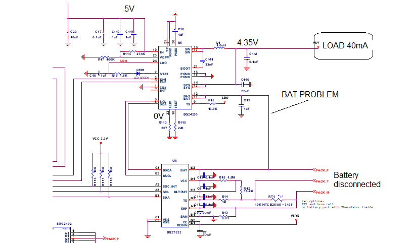

Hello
I use the circuit att.
Input voltage = 5V
VDPM = 1.35V
EN1= "0"
EN2 ="1"
ILM = 0V , ISET = 0V
LDO  = 4.9V
SW = 4.35V and the load is 40mA
At BAT output we received the att. figure
when I connect the power  in LED1 (STAT pin) blinking for a short time. (some times some short blinking)
I have not I2C connection .
Battery is disconnected
in the data sheet is written that the reason is a fault.
what can be the reason for this  fault and the BAT pin output ?
    Can you remove the SYS load and try again? With gauge connected at BAT, this may falsely make charger think battery is present and try to pull current from it.
    The other way is to disconnect BAT from gauge device and try.
