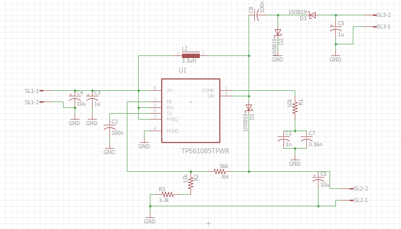

There are a lot of boost converters among TI products.Can we use a boost converter to produce negtive output?
For example,the input is 3V,the expected output is -5V. Would you please give me the reference design?

You can refer to the TI design PMP9770. Get -5V by a negative charge pump.

I think the voltage accuracy can be assured by zener diode if the precision requirement is not so high.

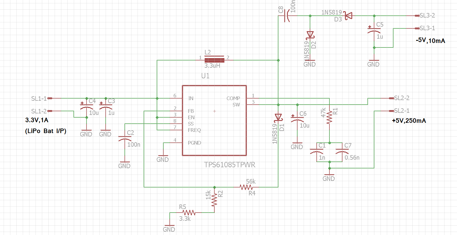

| Vin(Lipo,1000mAh) | 3.3V | 1A |
| Vout(-ve) | -5V | 10mA |
| Vout(+ve) | +5V | <250mA |
Hi there,
I wanted to use TPS61085 in my power supply circuit, with input/output voltage requirements in table above. Main consideration is the current output.
I will use it to power a opamp circuit(+-2.5V @ 10mA) and wifi module(requiring more than 250mA current at 3.3V).
Op-Amp is OPA320.
Output + -5V or + - 2.5V? there are different values in the description.
The schematic is OK, only one point:
For the compensation network , if you choose Rcomp=10k, Ccomp=1.5-2.2nF(suggest you use 2.2nF), then the effective output capacitance should be >=10uF, I found you only add 1pcs 10uF cap at the +5V output side, the effective capacitance is not enough, please use at least 2pcs 10uF ceramic cap at the output side. if the package is very small, may need more. you need to check the ceramic cap datasheet to get it.

I have chosen:-
Rcomp:- 10k, Ccomp:-2.2nF(Ceramic), Cout:-22uF, L:- 3.3uH,
For charge pump circuit Capacitor Values are:- C8=1uF(Electrolytic), C5=4.7uF(Electrolytic).

Output current should be more than 250mAmps @+ 5volt output.
i'm wondering the efficiency is very low which cause the problem. Or your input wire is very thin and long which leads to a big voltage drop on the trace.
