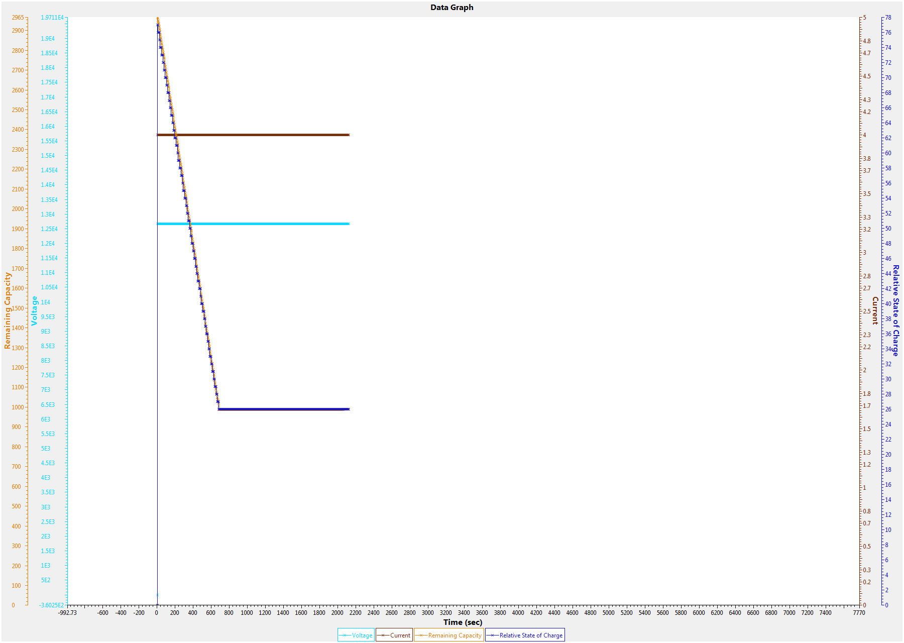

BQ40Z60 RSOC drops by 52% in 10 minutes with minimal current draw
Using a circuit based on the EVM with a 3S 450mAH LiPo.  The battery was fully charged and a load was applied while VAC was left on.  With a 4mA draw from the battery, the RSOC went from 78% to 26% with no change in the voltage.
Attached is a screenshot of the data graph.  What's going on here?  Thanks.
