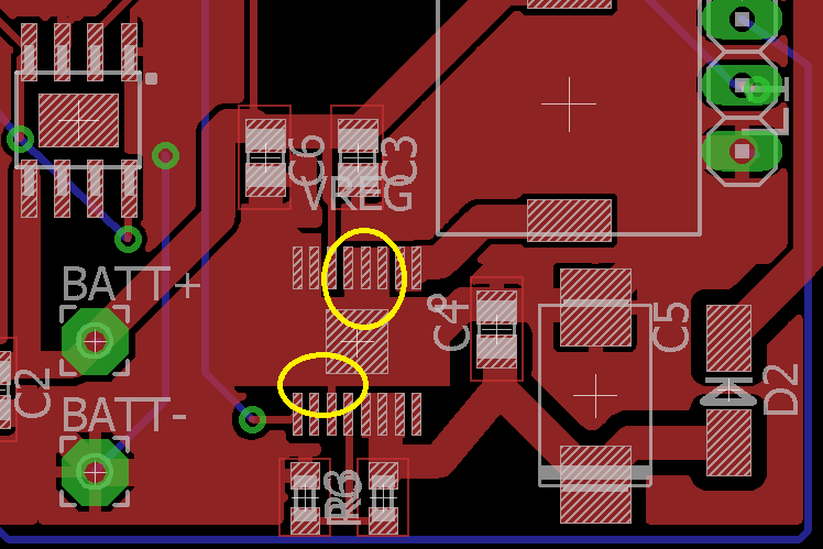

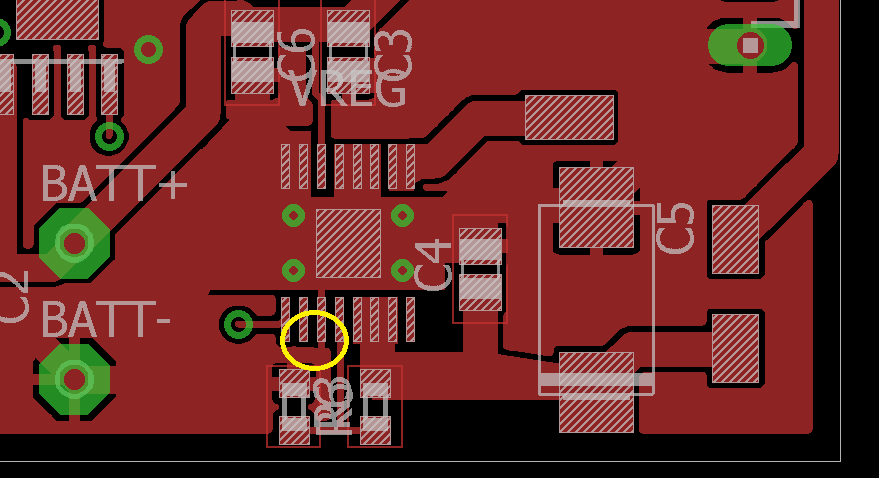

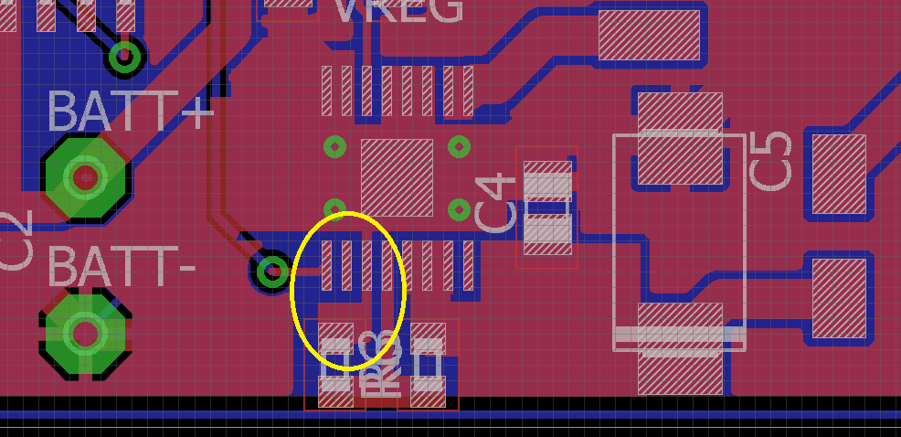

I have designed a 5.2 V regulator (TPS61030 )  and I'd like to know if the layout is OK, because previously I had problem with a TPS61092. On the datasheet there is only the layout example for the RSA package, but I'm using the PWP. My questions are  if the PGND and GND are connected correctly, and if I can place a ground plane on the bottom layer without problem for the regulator (in this case can I place the vias under the thermal pad of the TPS ?). The layout is attached.
