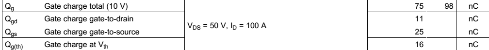

1. Qg= I * Δ T = C * V2,   if  CV2 is constant, choices sink / source current can determine turn on time, right?
2. We can guarantee test condition as below VGS = 10V, VDS = 50V, ID = 100A can have Qg 75nC ~ 98nC?

    Your thought process is correct for calculating the turn on time.
    While Qg is not something that we test for in production, we impose a 30% margin for the maximum value. So it is more than safe to assume the Qg of the device will be less than 98nC.
