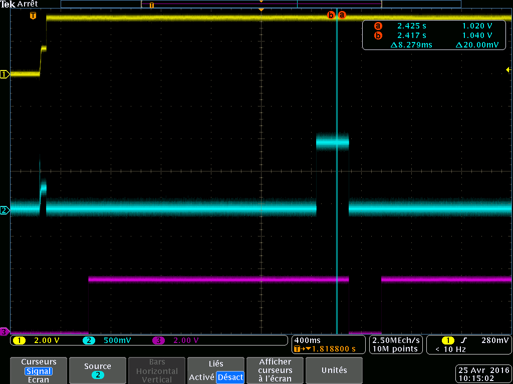

In my project I'm using the TPS3823 has a watchdog. The WDI signal is connected to GPIO2_3 ( T7 ) .
The problem is that when the board boot, the watchdog reset the board before the processor has the time to boot ... I didn't put any pull up or pull down resistor on the line . I have tried also with GPIO 1_15. But got the same result.
I think that GPIO2_3 is used at boot, but GPIO 1_15, I dont think that it's used at boot ... I'm sure that It's in high impedance.
The Yellow signal is the VDD.
The blue signal is the WDI.
The purple signal is the Reset signal ....
We can see that the component tps3823 try to determin if the input is in high impedance, but for some reason it detect that it's not ....
