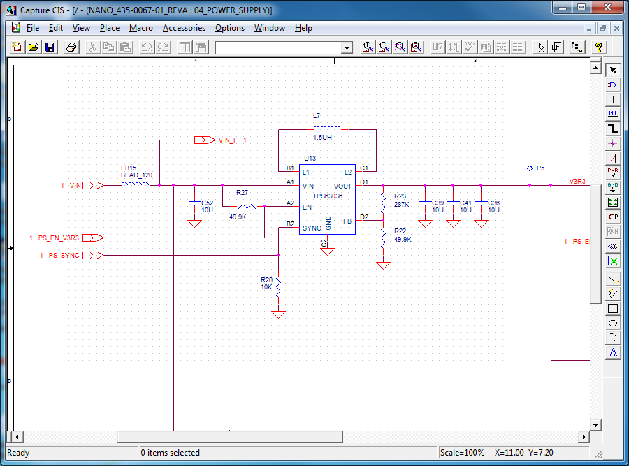

Schematic

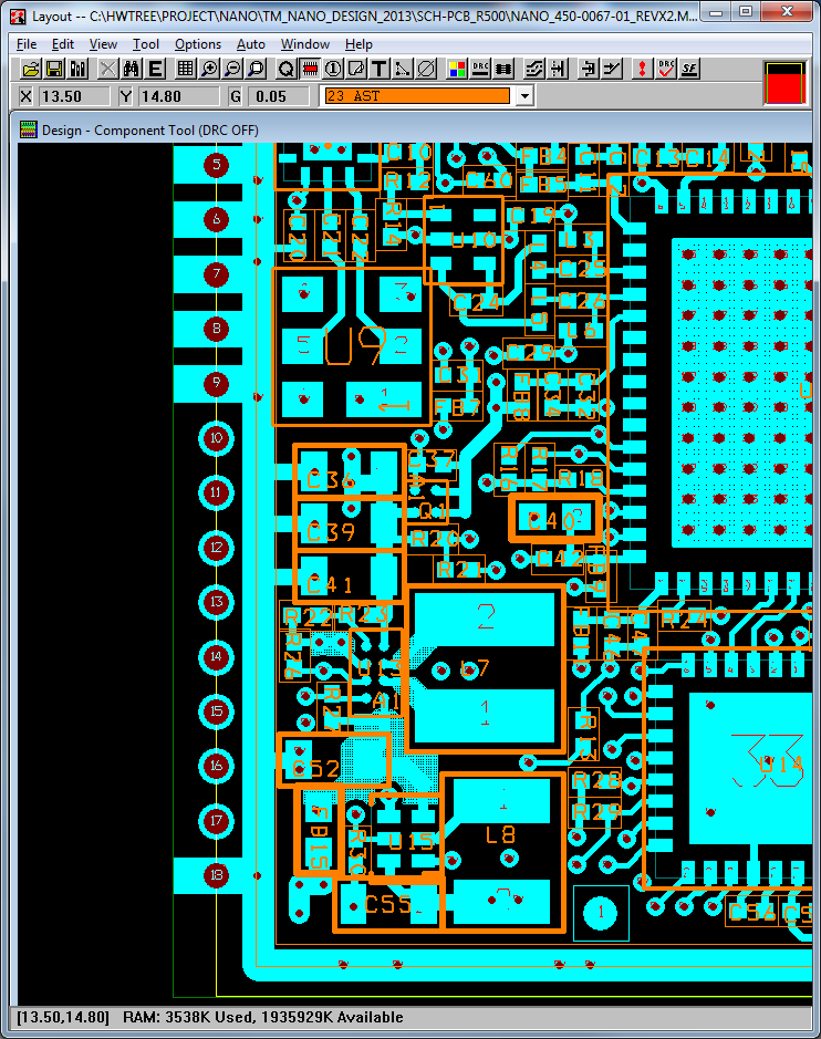

 Layout:
  • Could you please repost the layout and schematic I am not able to see them?

    Schematic:
    Layout:

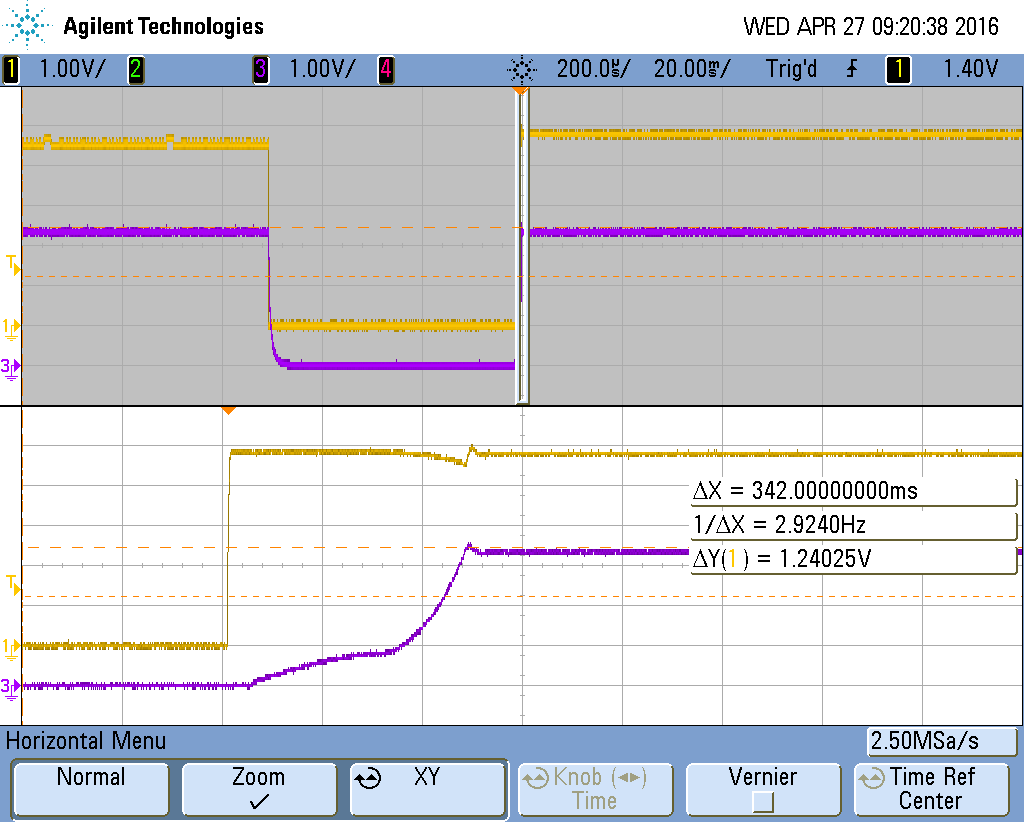

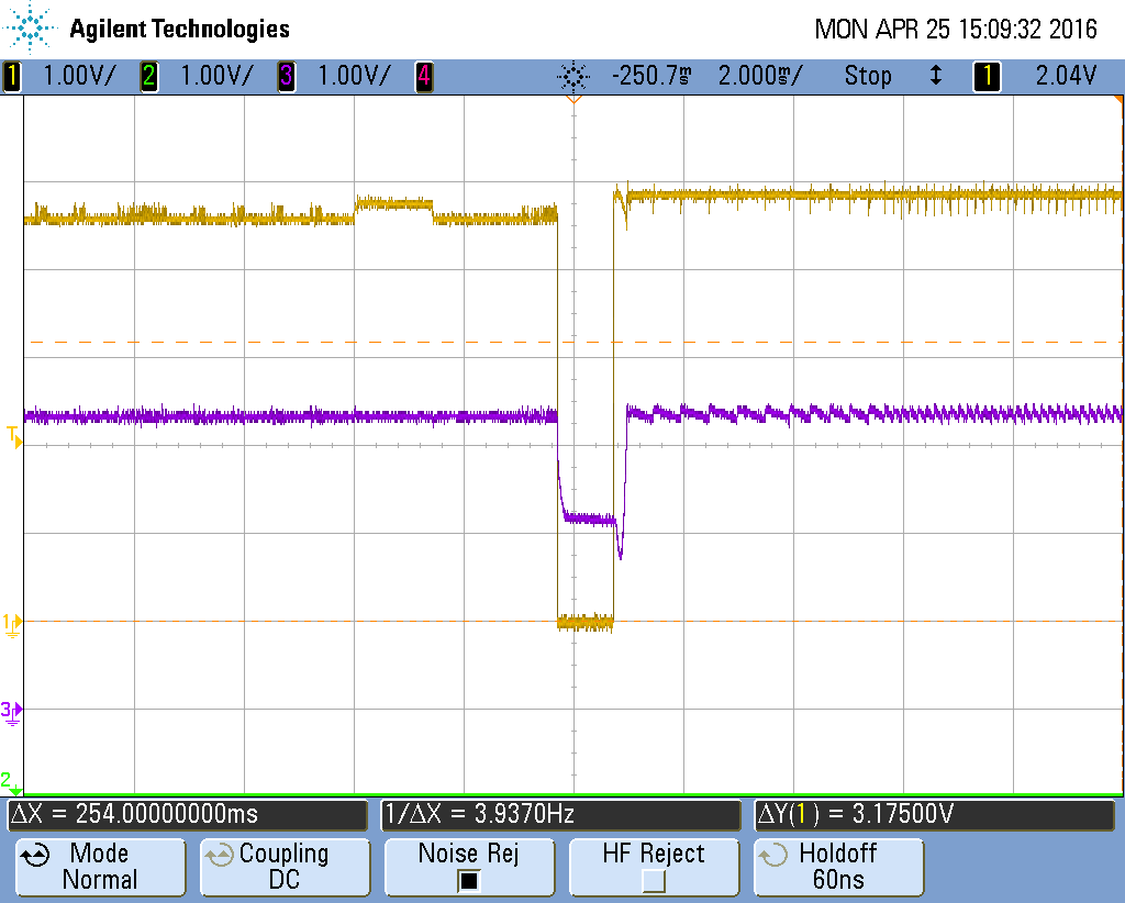

    Four scope traces, with discussion following:
    1) Enable and V3R3 with light load, Enable high success.
    2) Enable and V3R3 with heavy load, Enable high success.
    3) Enable and V3R3 with heavy load, Enable high FAILURE.
    4) Enable Rise and TPS63036 pin B1,L1.
    Discussion:
    Load capacitance is approx. 30uF at TPS63036 plus another 20 uF 1.5 centimeters away.
    Based on dV/dT and load capacitance, light load is about 26 mA, heavy load is 0.6 to 1.2 Amps.
    Heavy load is only at fall of Enable and is not present at rise of Enable.
    Figure 2) shows start up happens from about 2.2 volts. (Kind of like it has the  voltage elevation that my 1 volt blip did in my first posting.)
    Figure 3) shows start up fails from 0.3 Volts.
    The initial fall time of Fig 2) and Fig 3) appears (and I assume) are the same. Something appears to disconnect from the 30+20uF, leaving the 2.2 volts of
    charge on that capacitance. I will investigate what is being disconnected.
    Figure 4) Shows the TPS63036 is trying to start up but failing. Why? The TPS63036 data sheet indicates "no upper limit for the output capacitance". Start up into 50uF is our usual turn on where Vin and Enable rise together.
    Thoughts?

  • I did some measurements on the TPS63036 with a resistive and electronic load. I tried to reproduced this issue but as expected could not. What is your application? Regarding the output capacitance it should not be an issue. You can have higher output capacitance.
    Regarding the layout, it looks OK but I would definitely rearrange the feedback resistive divider so that the output capacitors are placed the closest possible to the device. Do you have a separate layer for ground? I would also use more vias and polygon for the ground to have short ground connections.

    3. For me it seems that the device is stuck in the short-circuit protection condition (please refer to chap. 7.4.1 of datasheet). When I look at the falling edge of the EN     The behavior of the VOUT trace is not the same on Fig.2 and Fig.3, Do you have the same load on both the conditions?  It seems to me that there is maybe somehow a load that consumes and prevents the Vout to raise.  It would be good to have Vin Vout and EN on the same scope plot. Could you guarantee you have the same load on both the conditions?
  • A bit more information:
    Lengthening the on time to 450 mSec makes the turn off in the high load condition. My application takes about 330 msec to launch to high current. The 250 msec on time was running through the short 1 msec off time to get to the high current condition every other off time. Hence the bi-modal high and low load condtiion at turn off.
    With the 450 msec on time, then lengthening the off time to 50 msec and the TPS63036 always start OK for 80,000 trials (figure 5 below). But why doesn't it always start with 1 msec off? My load is an RF amplifier with shut down. I'll examine the load and can substitute an equivalent resistor.
    Layout comment: There is full ground flood, first layer down, with via in pad for all ground connections.
